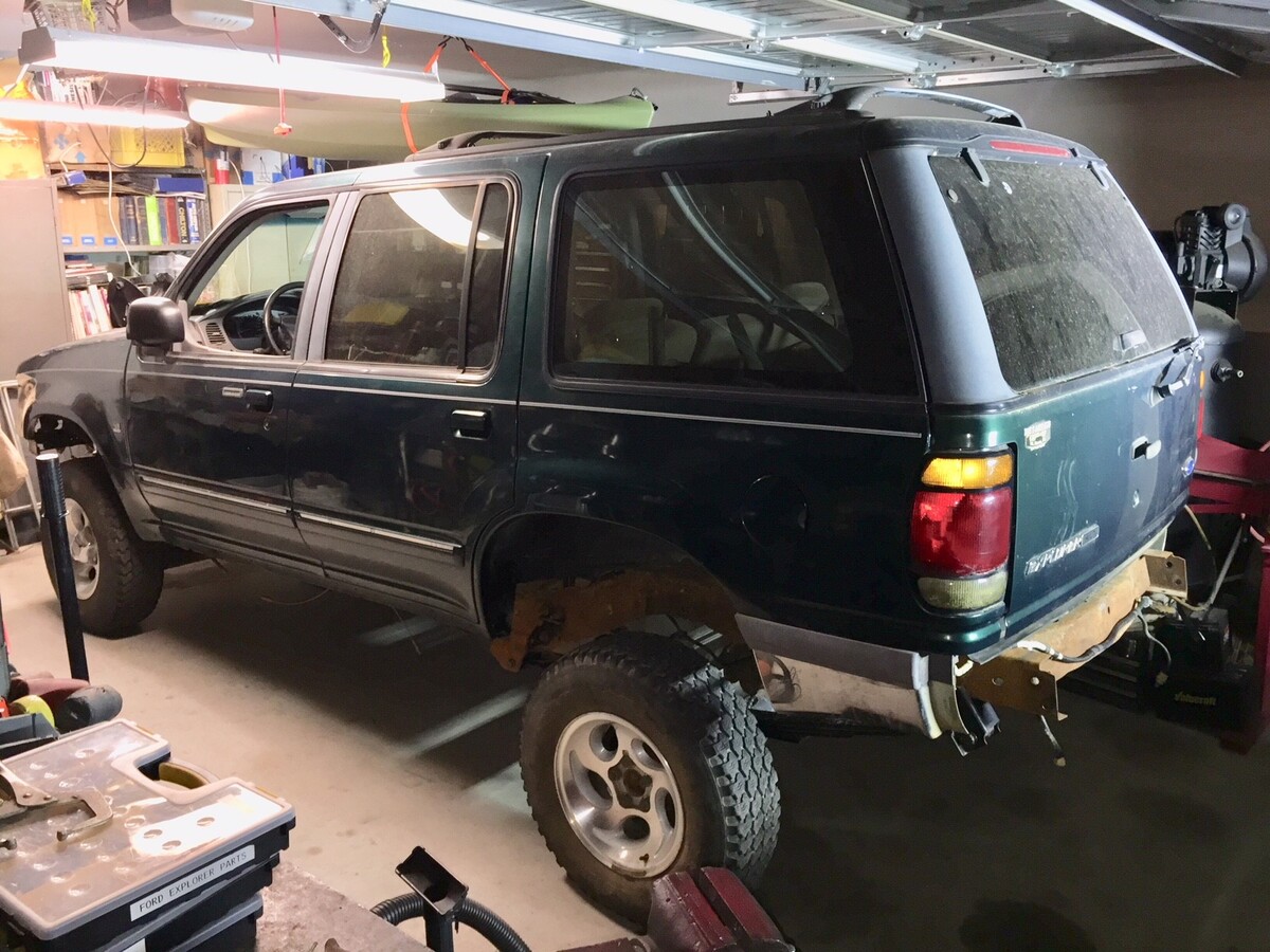

Did a few minor things over the weekend -
I installed my '$50 - Pieced together' 2" body lift kit to give some added space prior to installing the BW 4406 swap. I was a bit leary about installing it as im not a huge fan of BL's, but glad I did. I can now get into areas I couldn't before, especially with the pressure washer to clean all the Arkansas clay out of it.
All the bolts for the body came loose except one. :mad: Always the last one that gives trouble. With the help of my Son and a jack, a log and ingenuity...it worked well, and safe. I'm not going to go into the details of the process - there are great threads that cover this.
Pictures are the best I can do, till I can roll it out. It has 1" of clearance above roof rack and header panel for garage door. :oops:

After I get the BW 4406 swapped in, Im going to re-position it in the garage to get started on the SAS. (because as you can see...I have no room o_O - dedication is the drive!)

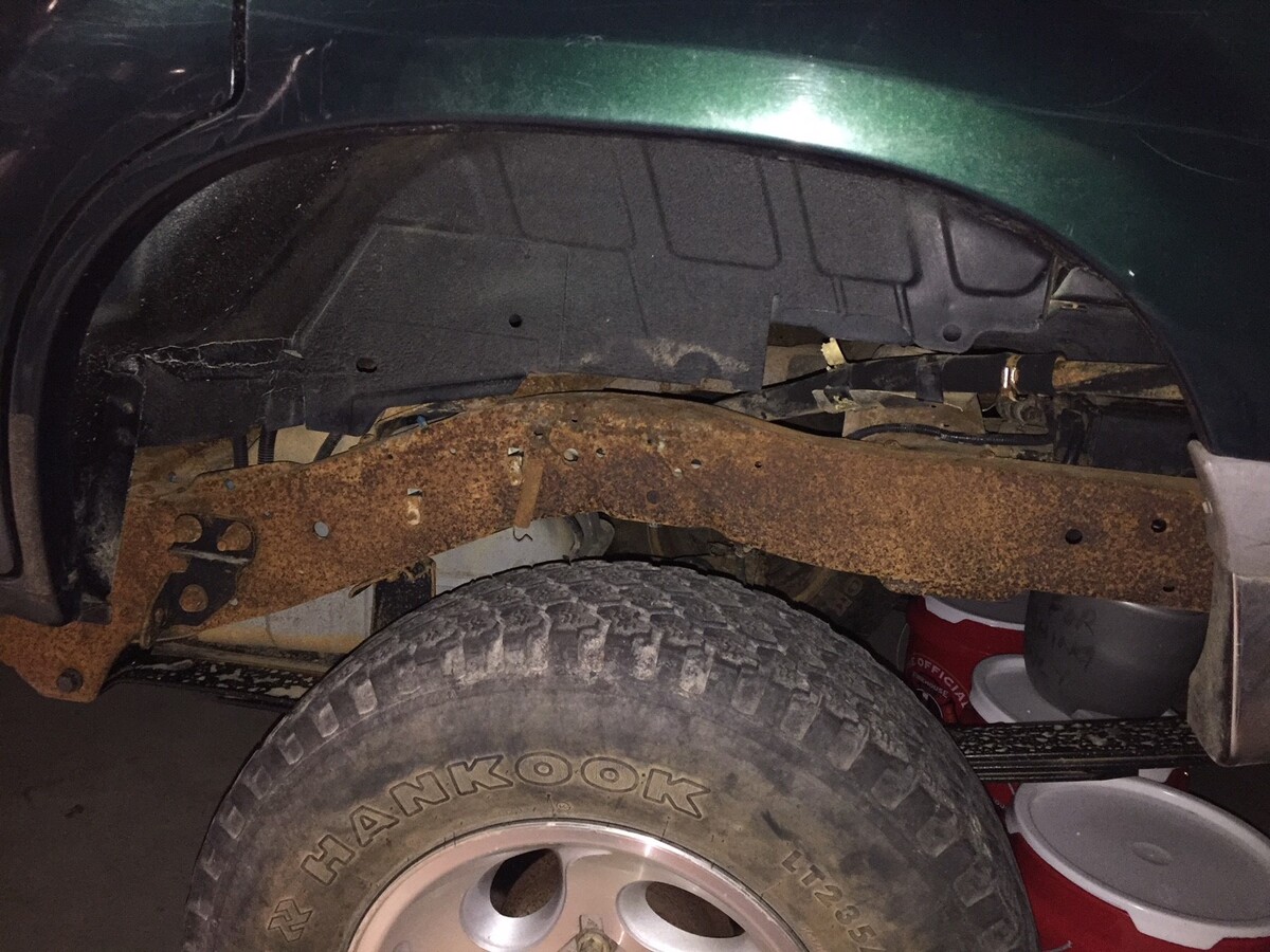

Thanks.. The height is not too much. I dont like the gap between the frame and body when it is excessive. Hope this gives some perspective for you. (Driver Rear fender well area)
BTW: I will be cleaning up the frame - too 'roachy' for me :)
It doesn't look to bad. You also have a SOA done right? Yeah the frame looks GREAT ha ha ha. What Axle are you planning to use for your SAS?
the SOA is done in the rear. I'm going with D30 as well. Got it for a steal - (whole Cherokee for $150), and considering I'm on a budget as well (like most :)) it will do until I find something bigger. :burnout:

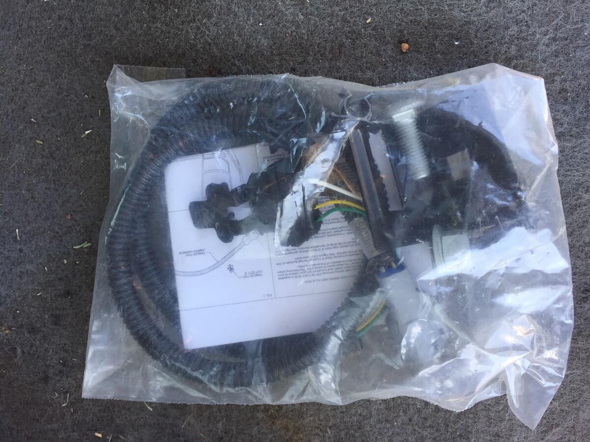

For lunch today, I decided to walk around the JY to look at the 'new' inventory brought in. A few more Ex's hit the stands.
Peeked into the back of one and found this un-opened factory trailer harness. Been looking for a used one on a vehicle for months....Big score for me!
