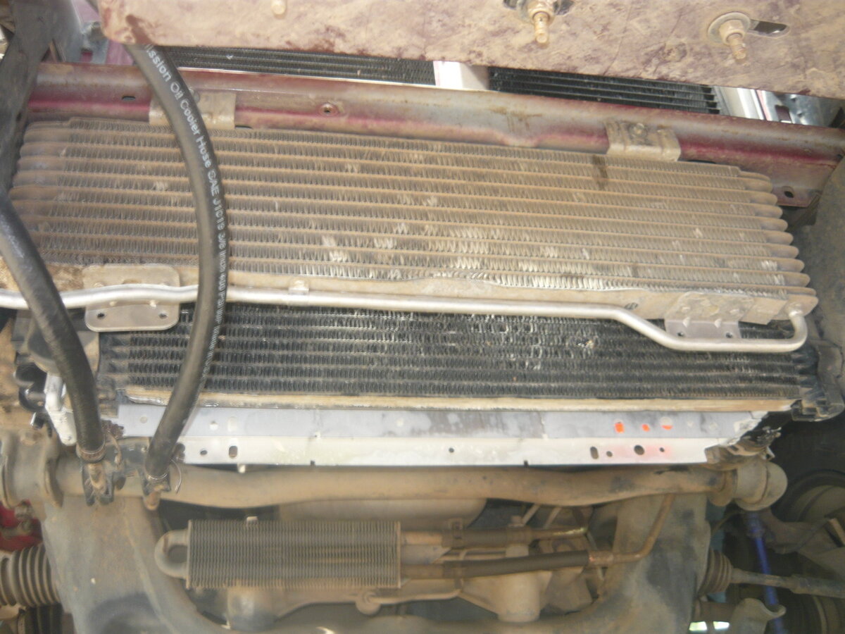

@WormsExplorer - Here are a couple photos of the lower part of the radiator. Keep in mind, the condenser is not fully mounted to radiator (note red tywrap); maybe hanging 1" lower than normal.

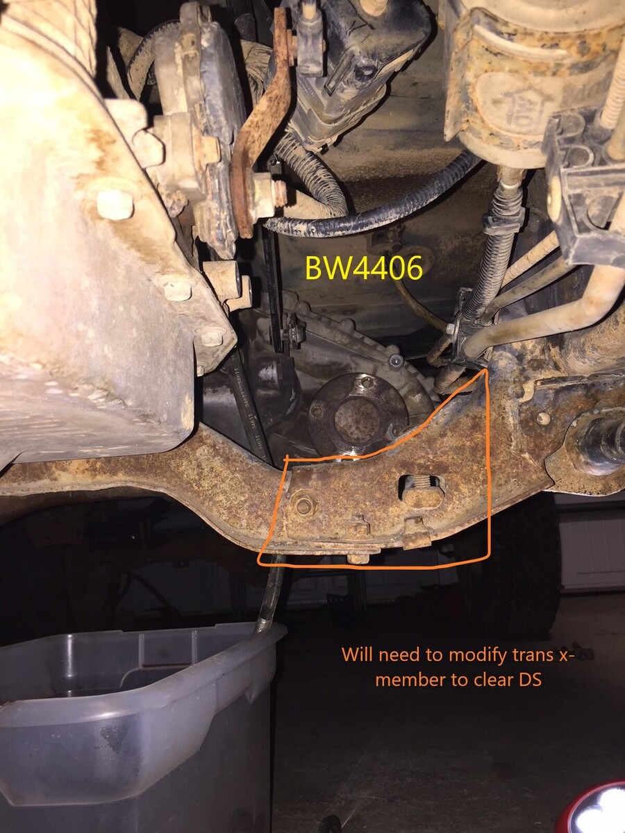

You should not need to modify, try a new transmission mount.
Also, that big space in front of the ac condensor is where you want to mount the f250, f350 trans cooler. Air flow is so much greater there, the stock fan will suck cigarette ashes thru at idle.

You dont think the cross-member will need to be modified to allow clearance of the new angle of the DS to the front straight axle (SAS) pinion? I have been reading through front DS threads, lots of info on whether to use a DC or SC slip type DS....still trying to find the best solution.
What type of trans mount are you thinking?
Thanks for showing the trans cooler addition - I was thinking of adding a 2nd stock cooler with a trans oil thermostat in between - Project revision V1.1 Are you using the stock plastic air deflector under the coolers?
Disregard the crossmember statement, I forgot about the sas part.
Adding a second cooler will work, but it creates 2 times the connections and hoses to deal with, I ran that on the Turdle, however I have better results with the single cooler and it's location. I don't think the additional fans I installed are even going to be necessary, that is how good that location is. Considering the larger one ton cooler can be found for about the same price as a second stock one---
I ditched the lower baffle a long time ago, it just gets in the way. My larger trans cooler, and fans, tuck in behind the bumper and skidplate, hard to see but they are there
Oh, since my radiator was new, and I bypassed the trans cooler lines to the aux cooler directly, I can use the transmission heat exchanger portion of the radiator for this, post 4
Turdle, what models of F25/F350 should have those long coolers? That will fit better than the two versions I found, which are taller and narrower, more like the radiator but smaller.
@Turdle - I did read that in this thread for the heated shower idea - Installing a new all aluminum two core radiator - and was my next thread to find. Thanks for the link :). Im sure Ill read it, how are the temps after the swap for trans? Are you using the ScanGuage II for readings?
There is sooo much good information to follow and I was was looking at ideas for the transmission.
Feedback is priceless - thanks for taking the time and posting pictures.
Just did a 300 mile round trip where AC was needed along with 75mph speeds, trans maxed out at 148 degrees, never even switched on the fans. Yes, the Scanguage is a very good thing to have.
I am going to guess 97-03 year range, but to be honest @traveler will need to answer this. I got mine from him. It's his "Mod" for proper idea credit.
We'll call it the "Traveler Mod" from now on if it's ok.
148 isn’t shabby at all......
Aww... Shucks, wasn't nothing but a poor country boy trying to avoid spending 100 bucks on a new Transmission cooler! lol
And yes, I think you are right, both of them came from 2000 - 2004(ish) F350s, maybe newer. Mine came from a V10 model, and I believe yours came from a Powerstroke. Year and model doesn't really matter. Doesn't even need to be an F-series. I used a cooler out of an E-250 in my Tbird. A transmission cooler is a transmission cooler. Just find one that is big enough to get the job done, and small enough to fit, then yank it out of the junked vehicle. Before installation be sure to clean it and flush it thoroughly, and pressure test it for leaks. I used air to test it.

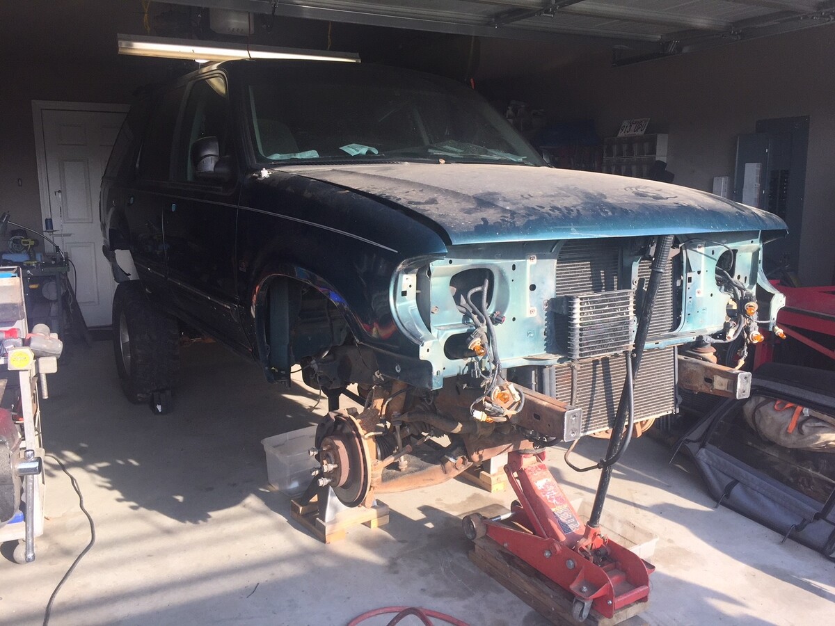

No turning back now....Started SOA this weekend. I put my 'new' tires on the back to get a judge on height...I'm started to get excited; I'm loving the height. This is her sitting level with suspension in back. I figured a good starting point to get the front setup.
Pulled front wheels to start teardown of front suspension
index.php
Front suspension came off pretty easy. No frozen/rusted bolts. Only 2 bolts at the lower mounts on the shocks broke,. Axles came out pretty easy. Upper control arm joints were SHOT! I don't think they were ever changed. Brake pads were almost gone. Lots of good parts.
index.php
All suspension is removed. Next Ill pull the front diff and rack and pinion, then the cross member and brackets. Driver side was a pain to remove the upper control arm. The fuel and brake lines were in the way of pulling bolts out all the way. If your in need of any stock parts, let me know.
index.php
Looking a little naked there in the front LOL.
Looks good so far. Look forward to seeing it all together.

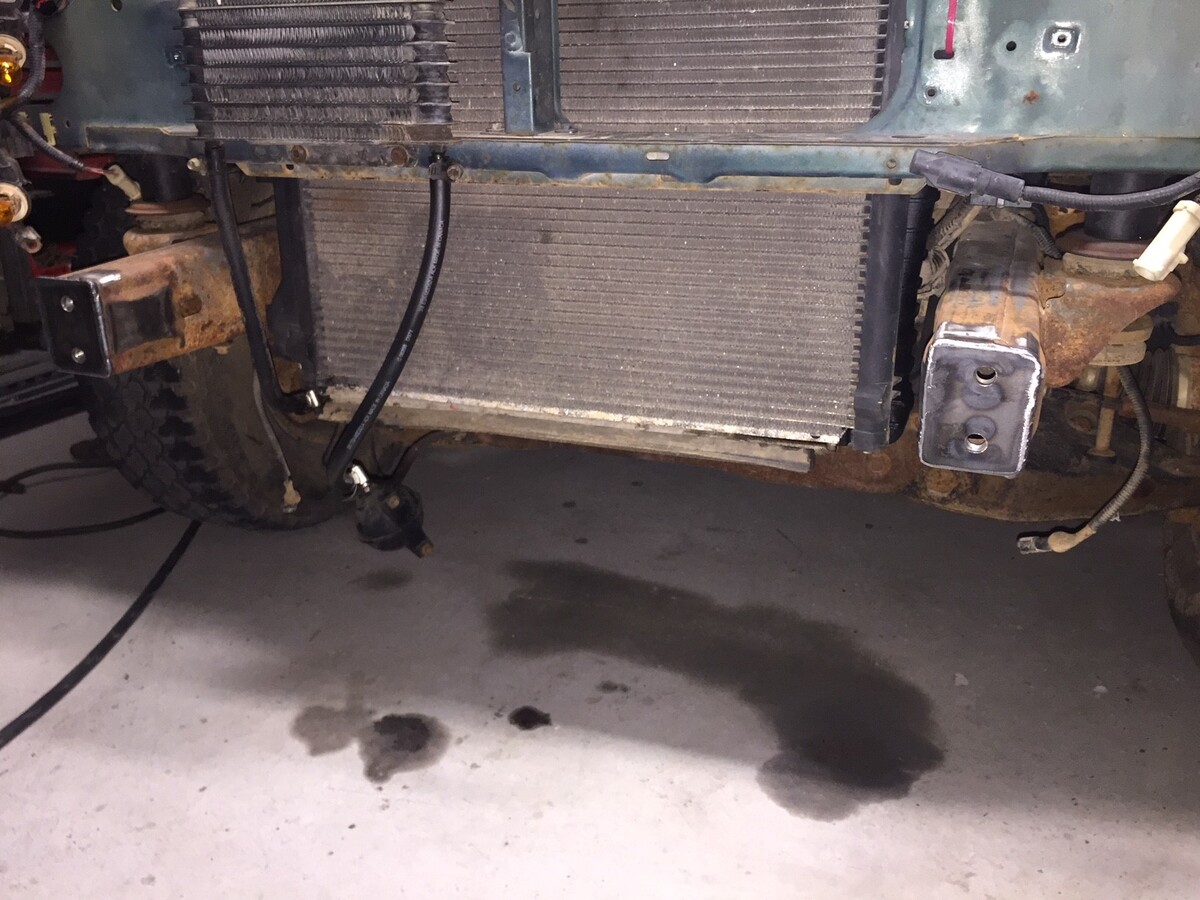

Plasma cut the old brackets off and ground them down and cleaned up the frame. The dirtiest part so far. :eek:. I had to get a visual for the sake of smiles. Getting it cleaned up around the drivers side was super sketchy with all the fuel lines and filters.

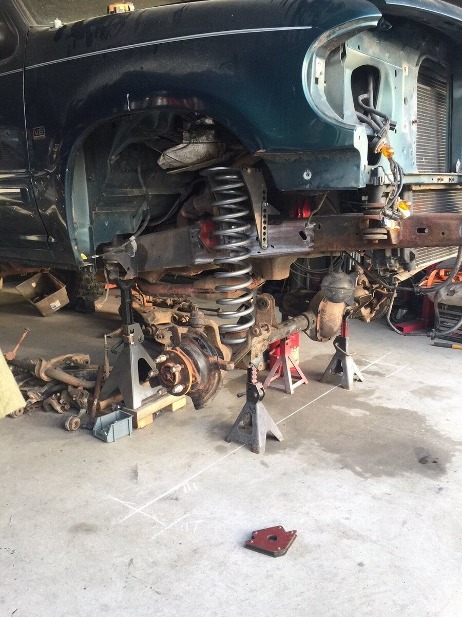

I got the wheelbase measurements down and started mock up. It's starting to get real...Exciting!
I am thinking of bumping the wheel base out another 2". From previous threads read, I'm seeing it may be necessary for the pitman arm clearance and steering box addition...or just because :) . We shall see.
This has been fun so far, getting my sons to help here and there. It's great to explain to them the mechanics and engineering aspects of the build.

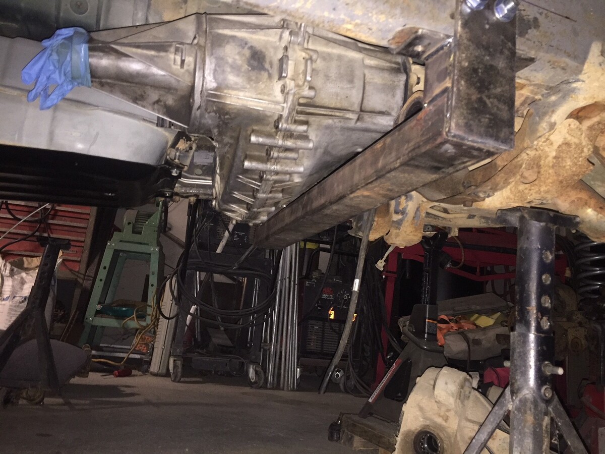

New Trans Crossmember fab'ed in to make room for front drive shaft. Cutting stock crossmember out once new mount is installed.
Credit for idea goes to @johnny499 - Thank you!
That's heavy duty there. Do you need a skid plate there too?
