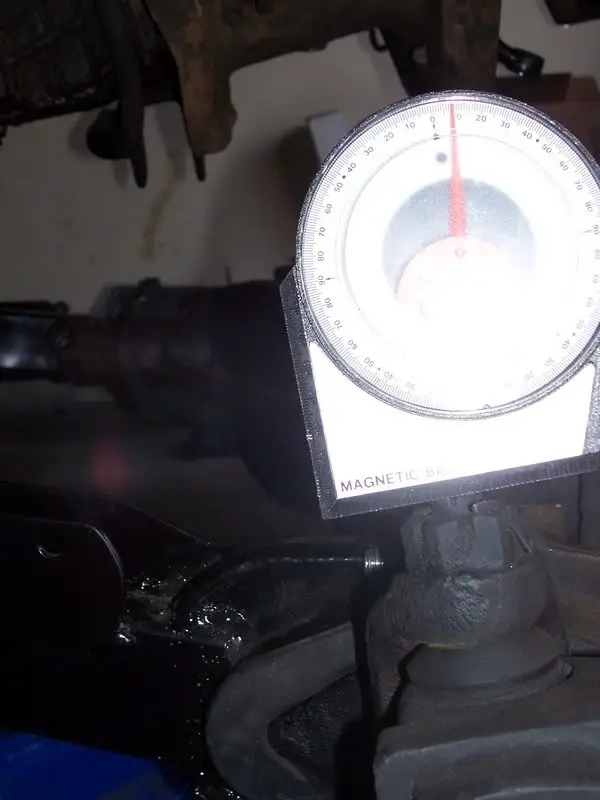

ok here are the alignment specs. for 79
camber 1.00 degree+ to2.00 degees+:eek:
caster 6.5 degrees+ to 9.5 Degrees +:eek::eek:
toe total -0.08 to0.44 (degree)
My camber is at aprox 2.25 left and right
caster set at 5* at set up probably more due to negitive rake or prerunner stance I hadn't counted on
Toe ? Slightly toe'd in with the eyeball.
I know caster will make one track straighter Which is why you have more on the right side to eliminate pull caused by road crown. So even if I dont have enough caster I dont think that is where my problem is. Talking to a friend of mine (alignment guru) more caster in a jeep will cause death wobble so I'm going to go with less is more.

this is what mine is set at and drives like a dream
Thanks Mine is around 7*. But I found the problem When I changed the pitman arm I left the nut loose because I needed to ream the hole some more. (If I dont watch it I may have to fire myself)

I was going to say your alignment specs look good and it should drive great especially with the AT's.

I would set your toe in with a tape. I would paint and scribe a line on eash tread, then burn an inch measure front and back and toe it in 1/8" to 1/4". I do all of mine like that. I have had too much bad experiences with even the best alignment shops. You know more about your front end geometry then thier average tech. I think those computers weren't around when that front axle rolled off the assembly line!

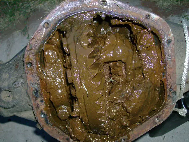

That diff looks like someone/something took a dump in it

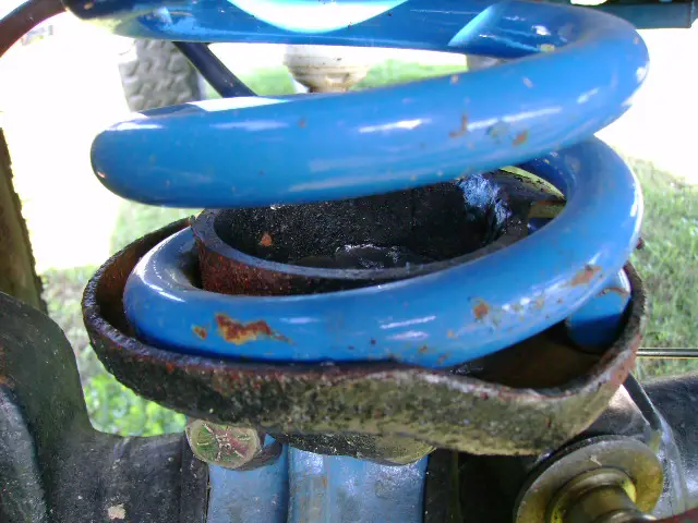

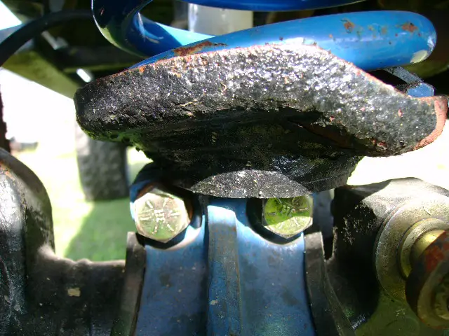

Ok I havent posted in quite some time. First off do not do the superduty pitman arm mod the splines are just big enough that they never completly seat properly. THIS MOD WILL KILL YOU ON THE ROAD. That is where my steering slop was coming from. I wanted to post a pic of my lower spring pearch. I did this mod to correct the spring angle which had a forward bow on both sides. Also some pics with my new shoes 37x12.50/15 SSR's These tires ride great on the road. If I have to get a new offroad tire so be it but I an happy with this tire all around right now.

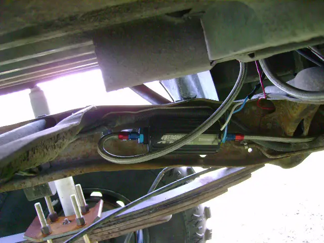

Also my fuel pump was not cutting it so i purchased this from a guy that drag races in the outlaw street class It has one pass on it. It's an aeromotive eliminator pump good to 1600 hp supercharged. It has a no. 12AN inlet and a no. 10AN outlet. This is way overkill but it gets the job done.
