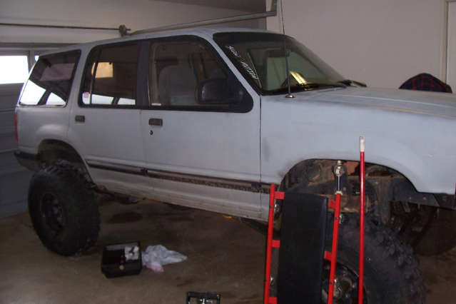

well i thought i would update the old beast a little...I have not put any more upgrades on it...The 5speed is shot and now it is just sitting in my driveway...I can drive it but we did check the fluid and there are all kinds of little metal shavings in the fluid...the fluid was clean other than the metal....No water or anything...Glad for that one.....I have decided to park it and just look for a tranny.....
I am now just stuck between redoing all my suspension with some new axles...

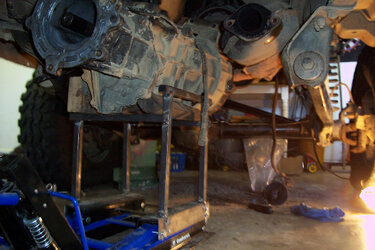

Well When you go SAS or anyting of the size the transmission is to far from the ground to get it down really easily....This is my prob....My shoulder will not allow me to help my dad to get it down....So we are using a motorcycle jack and some steel to make a tranny jack that will be to size to get in and out with the tranny.....
We have two Lplates of steel on the jack....There are two almost u shaped braces in the back that will be weilded upright on top of the two Lbrackets...Wh also have two long bars to attach to the stand to hold the tranny down in the stand.....

Good idea. I've been using a floor jack and a board with foam on top. It's not very stable.
I have done that but it is to unstable...I can hold on to the tranny/transfer or anything of any weight because of my shoulder...SO this way the tranny will be cradled and wont have a chance to hit the floor...Also will allow to be put on the work bench and will serve as a stand....

The tranny/motorcycle jack worked out really great.....Works with transfers and trannys.....
This is fully let down after backing the tranny back after getting it out....
The truck must then be jacked up to allow the tranny to come out....
The tranny had some bearing play but we are not sure that it was making all the noise that was going on....I found out why second gear was not working to....The actual gear that drives second has two sections that should not come apart....They were....It looks like they just spun apart...

On to the big news.....I am going ahead and pussing on with my motor swap...I collected a 94 4.0 out of a 94 ranger when i got my M5OD...My 4.0 is on 319,000 miles.....If you want to know how much oil it has started to burn let me tell you this....I change my oil every month....Im serious about a quart a week.....So some time in the next two days we are gonna pull the Explorer under the engine hoist and start to pull it out.....The front tires are fully deflated so it will be easier....

It didnt get all the way out....need to take the gas lines off and pull it out.....Got to cold....it was 30 and there was a nice wind.....we had to stop....tomm its gonna be 45 so we gonna work after church....and get it out and the new one in....i did get the underside of my hood covered in truck bed liner while it was off...
