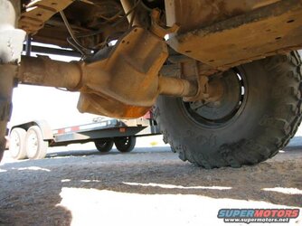

Is there any reason to do something like this other than protection on the rear cover??
Makes the whole unit stronger. It will help stop from spinning the pumpkin like Rick did this weekend...but so will simple welds around the area where the tubes go into the center section.
it makes the axle more rigid -- just do it, it looks more bad-ass :D

it does look bad. i have seen it on a few trucks and just never put anythoght into it till i ran across it on perrys fab and fiber site.
he spun a 8.8 tube correct? cause you cant truss a 8.8 like that with out some major fabbing for the cover, with the 9 i dont think its possible to spin tubes, the truss is just to add strength to the "sheetmetal" 9" housing.

yeah its done very often.. more so on the "third member" design axles.. like your 9" and also the Yota axles and Rover axles.
i didnt think you could spin the 9" cause its not like the 8.8 speaking on how the tubes connect to the center section.
