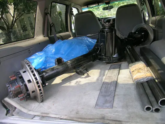

The 14-bolt "du jour" ..
5.13
detroit
disc conversion
new calipers (tho u can't really see them, they are exactly opposite of the pic's angle)
and best of all, zero miles on the axle :D
Is that the dead hooker under the blue tarp?
LOL yeah she's getting "swapped" too

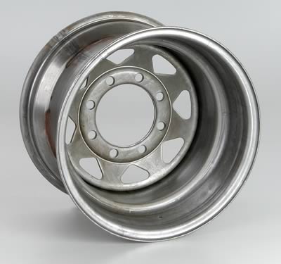

EDIT: here are the el-cheapO chimichanga wheels I'm going with, they're unpainted :D
http://store.summitracing.com/partd...793325+4294795084+4294795019+115&autoview=sku
The 2.5" backspacing is going to make steering a little hard (lets not mention hydro just yet) but its required to clear the ginormous 8-lug calipers.

Wheels have been painted (they came bare remember) and are drying - I hope to have tires mounted tomorrow and have a pair bolted to the rear axle - this will give me an idea how high up the front will go.
Tested the wheels on the rear axle for caliper clearance and found no problem at all :D
