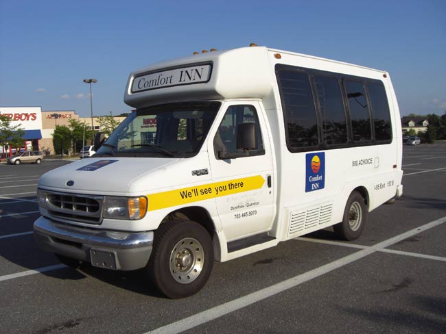

I decided it was time to pass on the old E-350 and replace it with another.
So I picked this guy up on Saturday.
- 2001 E-350 7.3 PowerStroke (does not leak!!)
- Auxiliary air-conditioning/heat under the chassis
- 13 seater (including the driver) but I'll probably change up this combo.
- Air-powered side barn doors (by far the coolest part of the vehicle)
- Wide power side mirrors
- Padded interior walls (in case I go nuts.. oh wait)
- Luggage rack (will probably be removed)
