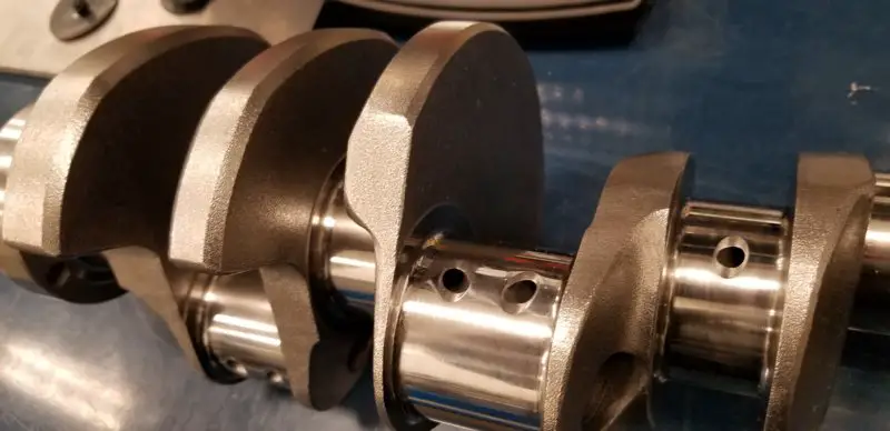

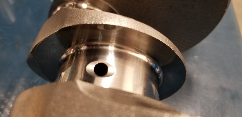

My crank finally showed up.
I have to say I was concerned after Ford Strokers had posted video's of how bad the Eagle cranks were.
I can also say that I don't know if Eagle was having quality issues at that time, but my Eagle crank is a thing of beauti.
Have a look at the thrust surface. No chatter marks at all. Mirror finish Look at the over all. We checked for runout on the bearing surfaces, and its all but perfect. I would recommend Eagle forged cranks to anyone.
Hopefully my motor starts getting worked on now.
I like those beveled holes too, from the factory too now.

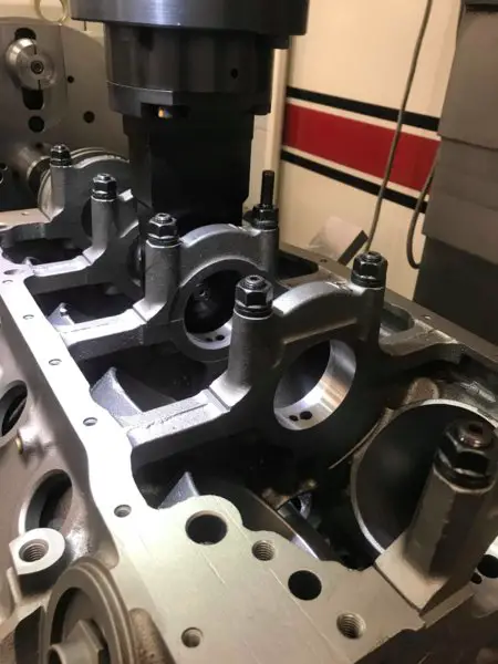

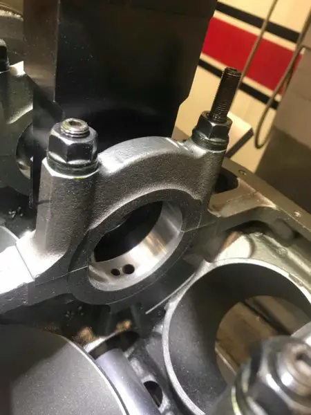

My motor is getting some love finally.
Here's some pics of it getting the line bore done.
Next is clearance for the larger hv pump and stroker clearance.
Hopefully by the end of the weekend the bottom end is well on its way to completion.
