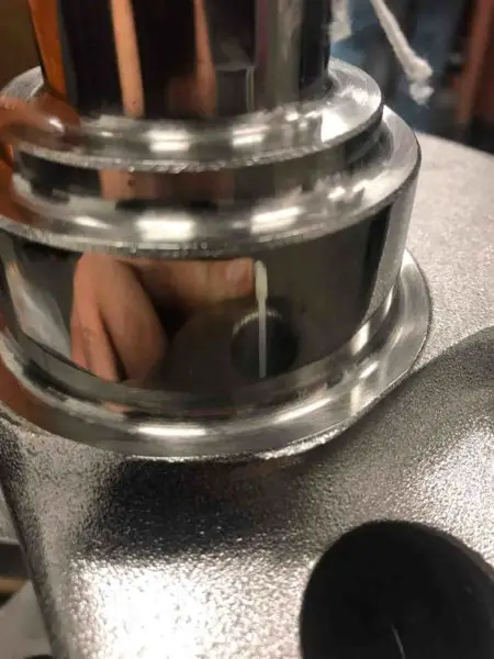

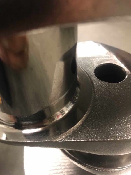

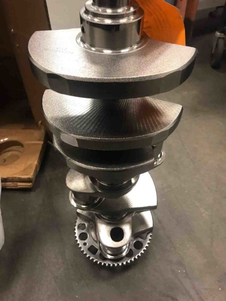

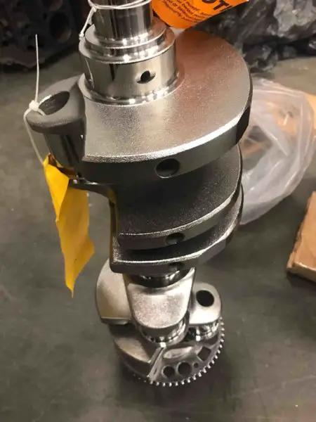

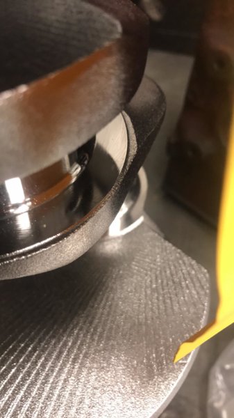

I ran across video's by Ford Strokers showing the shittiness (Is that a word?) of the Eagle crank.
I sent the link to the engine builder.
He sent me pictures of the same crank I ordered (Not mine, unfortunately). This crank is for a different build.
Looks pretty good to me. He also mentioned that only the best of the cranks get selected for coating. That would make sense, as if you had to turn the crank to fix journal run out, you would be shaving the coating off. So, that would be a warranty claim on the new crank. These pics look good to me.
I asked for a pic of the thrust surface (Last pic), and it looks good also.

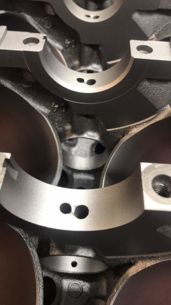

My block getting bead blasted with stainless steel shot.
Definitely no issues with the thrust surface of the block. I'm sure the block is better than it was off the factory floor.

I’d be tempted to tell him screw painting it, just clear coat it!

No kidding. That's gorgeous .

Thats a great idea. I guess end of the day no one will be able to see the block at all anyway, so it doesn't much matter. But, the block would look good cleared with the aluminum heads, for sure.
