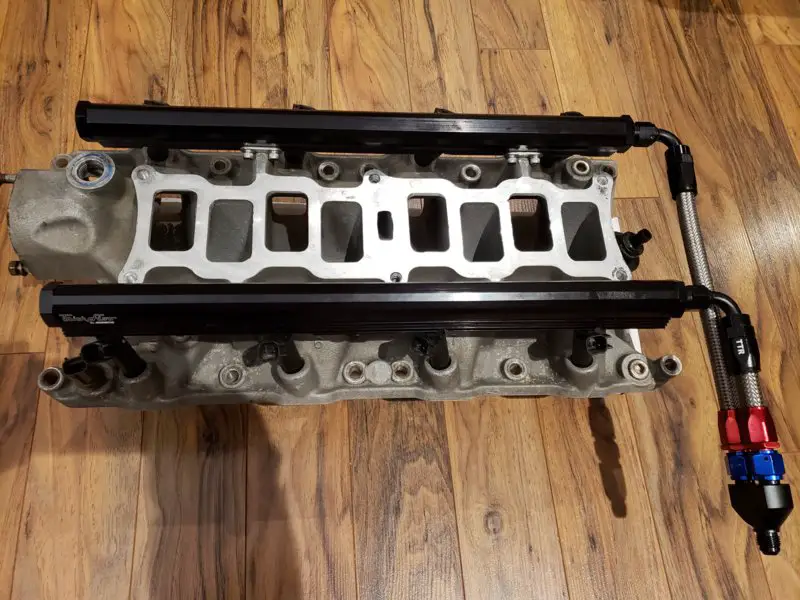

I mounted the correct fuel rails (The first ones I ordered were the Edelbrock ones, which do not fit the stock style intakes like the TrickFlow's) and made the 6an fuel lines. I'm hoping by feeding each fuel rail separately I get a hair more even (more even, how's that for poor grammar?) fuel pressure at each injector.

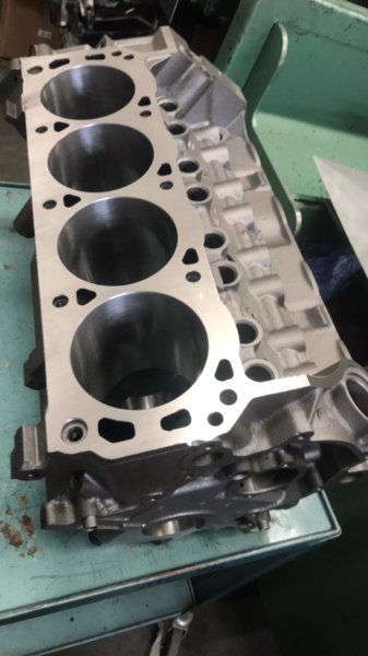

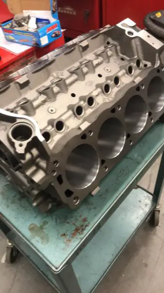

Progress is slow, but Dimas is back at my block.

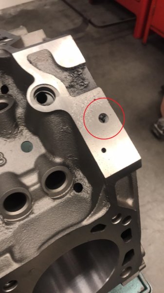

The cylinders look like they are almost ready for pistons, surface decked, and the hole has been drilled and tapped for the knock sensor. I'm hoping it wont be long till the finish hone is done, and pieces start going in to the block.

That looks very good.

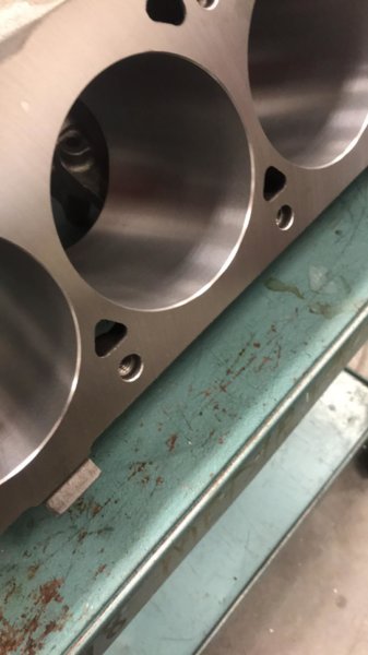

My block is still getting some loving. Torque plate hone, here we come.
The block is blueprinted so everything is in perfect alignment.
