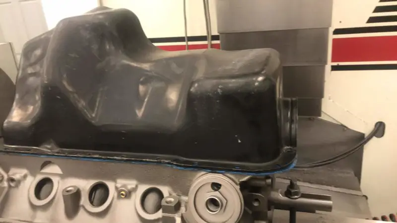

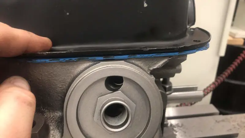

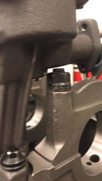

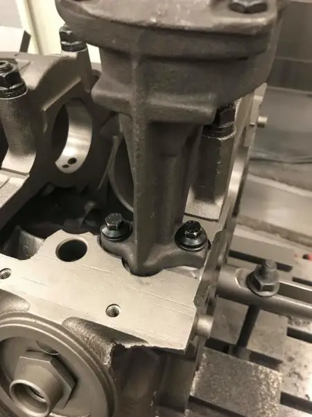

End of the day, I just want a fun truck that isn't eating thrust bearings. As long as I have that trans cooler line pressure under control, I'm sure I will be ok. The hv oil pump will be added insurance. The machinist isn't concerned at all with making it fit. He's going to split the difference in height and mill half off the block, and half off the pump mount (Assuming there is enough meat on the pump mount). Then, make sure the pump feed hole matches perfectly. I think this is going to be more work than he is telling me. I'm just happy he's willing (and excited) to do it.
I have to say, I'm excited to get everything together and see what the motor will do with that higher stall torque converter. Even though my other torque converter was a 2400 stall, I think it was just too tight. Hopefully this one nails it.
Just thought of this, he has the oil pump drive shaft right? He’s going to have to do some machining on it to
Yup, your right. He's already prepared to do that also. He's not absolutely sure it will need shortening as there's lots of play, but he is ready to do it if necessary. I'm betting that hardened shaft wont be easy to shorten.

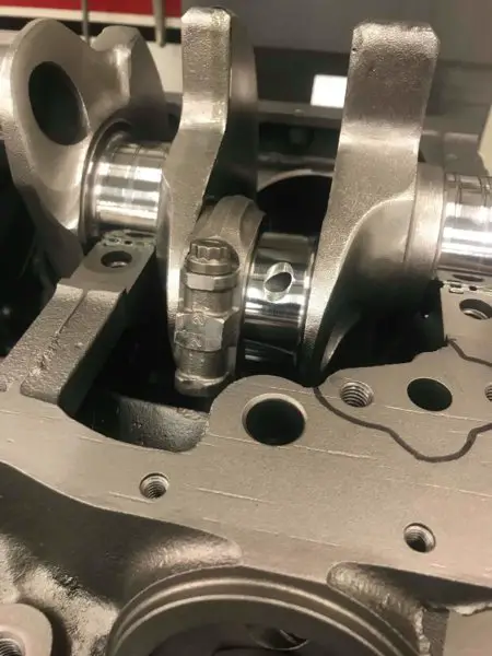

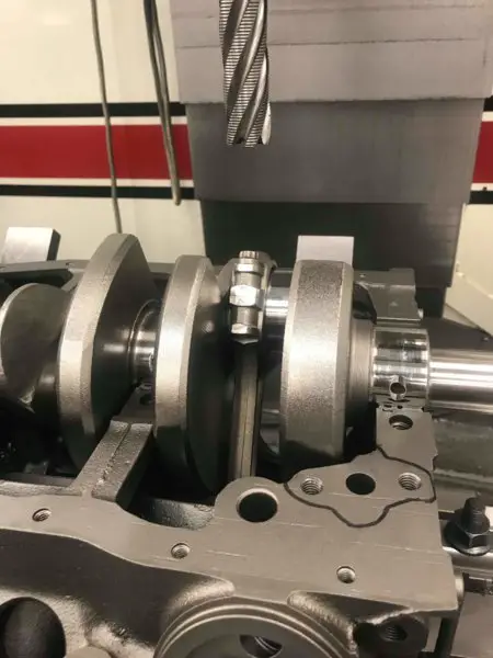

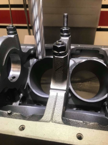

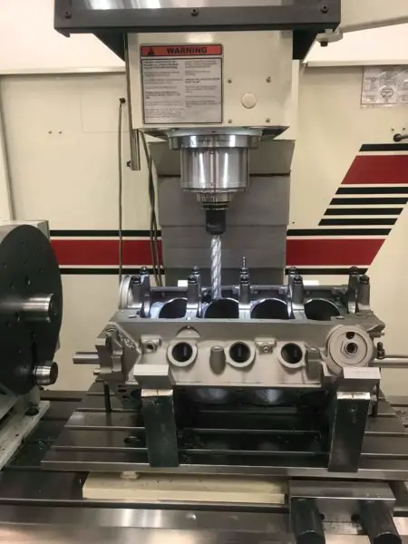

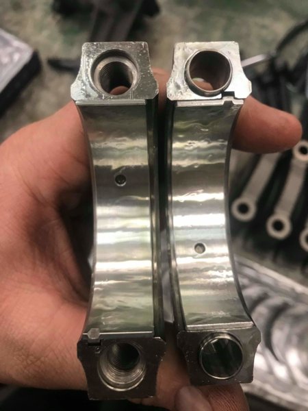

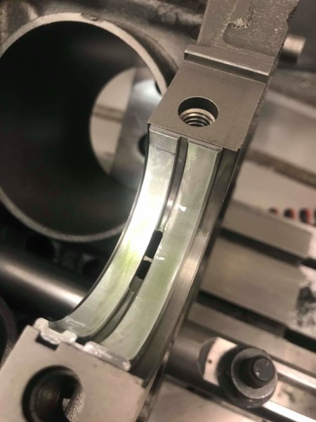

Block getting clearance for the rods.

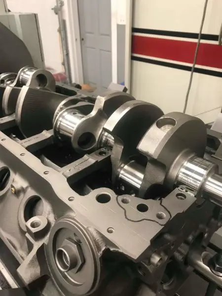

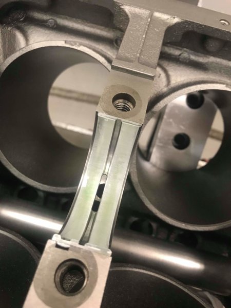

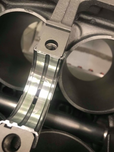

Bearing check for unusual marks. Next up is oil pump and pan fitment.

I love the pictures, that's eye candy for gear heads.
