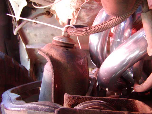

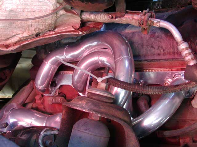

Here are some upclose engine bay pics:
Passenger side, upper shock mount.
It comes fairly close to the shock mount. Not too close though! :D
Excuse the zipties!

Those photos look awesome - but I worry about heat. Would it be better to wrap the headers, or wrap everything around them?
How's plug access? Looks like the stock wireset works, but a custom set might be best.

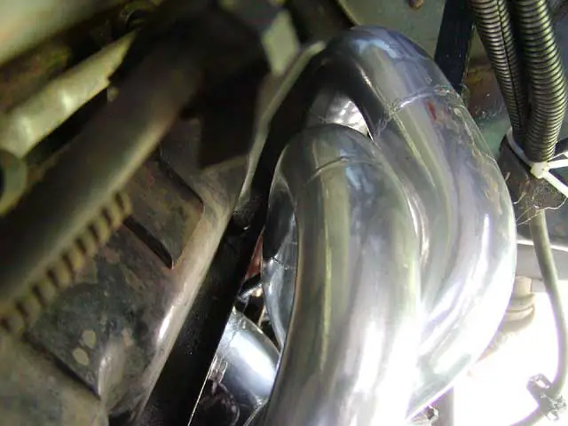

Driver's side
Here are some closeups of the only real tight spots I have (cept steering) on the driver's side. With or without the BL, this is going to be your engine-bay-friendly side. Its the heater box dealio on the other side that has be wondering. I'll see if I can get some pics from Bob of his installed on the stocker.
Here is the header to shifter cable clearance (the cable can be moved to the driver's side more) and the header to valve cover clearance.

The plug access is still butter. They're all just as easy to get to (if that damn spark plug socket would stay on the damn extension! ^&%!$ ). Sorry. But yeah, I'm going to those Taylor wires (stock configuration is fine) but I'm getting a roll of the heat sleeve junk and will be going most of the way up the side of the block. Ya know? :smoke:
Not sure about header wrap. The heater box dealio already has a heat shield around it. I'm interested to know what's going to happen over there cause I can see my BL coming out in the next couple months.
