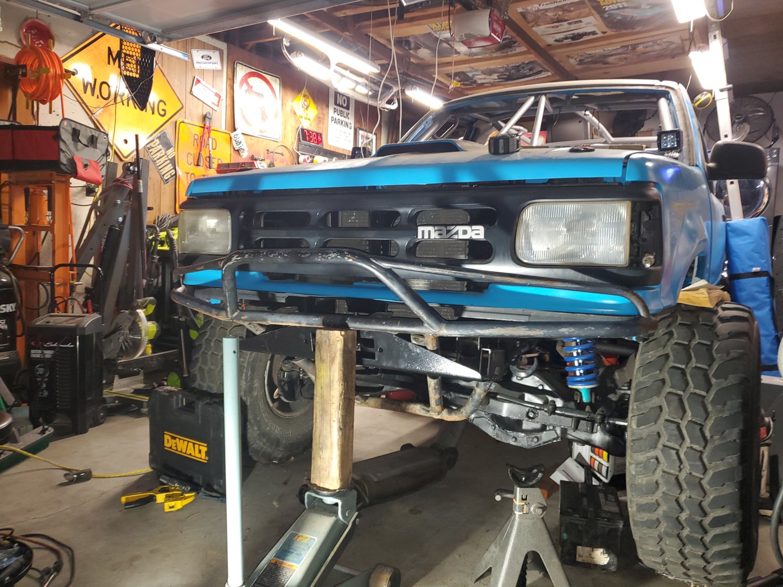

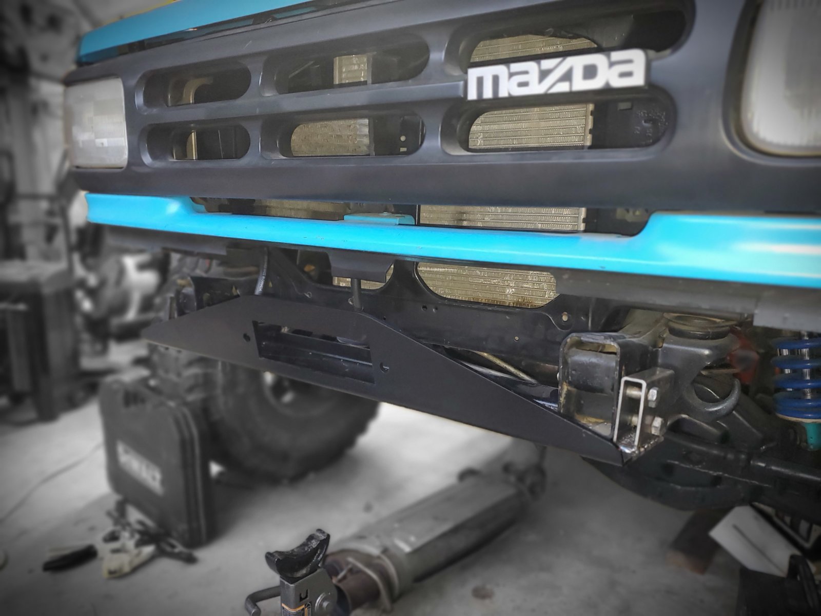

So as I slowly finish random things still left to do, I got a killer deal on a YJ - TJ winch plate ($27) and decided to start playing with bumpers. I got the winch plate mounts tacked on place. I'm integrating the original tube bumper that came with the Navajo, as it will be lighter and gotta use what you got in the quarantine world we live in now.
All tacked together... Just need to add some side braces.
any way to make the scoop function?
That thing is gonna scoot with the sohc under the hood......
nice work on the bumper! What did you paint it with?
Good looking engine bay
