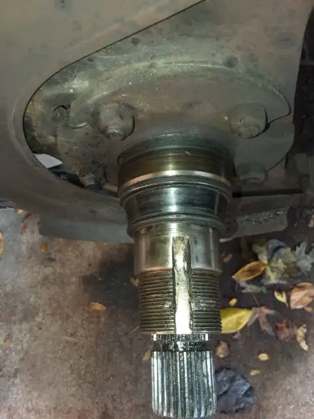

Had to replace the spindle. I can get the frozen race off of it, but the threads took a beating. Luckily I have a couple spares. These are 6 month old Napa SKF premium bearings that failed. I have checked the nuts on this rig once a month since. The nut kit and rotor is also 6 months old. I have to replace the $45 rotor as well. All in all, these parts run right at $100 to replace.
I am taking all of it back to Napa, as they have a 3 yr warranty. When I called to order the new parts, I told the chick on the phone that these failed in 6 months. She ignored me, and said the exact same new parts, come with a 3 yr warranty. I said great, see you in a bit. She is about to become stressed, as I am not taking this **** lying down, and demand full replacement from them. The premium bearings are more than twice as much as the normal units, and have 3 times the warranty length. If they don't honer this, I am complaining to Corporate. Tired of this **** hole town and the ******** people here. Grr......
I swear, Pugly is out to kill me sometimes. Blown out wheel bearings on a crowded Hwy, is downright scary to deal with.
How many in/lbs are you torquing the bearing nut to??
Been there done that. I was replaceing wheel bearings every 6 months on the pearl. Left me stranded a few times. At the end i started to torque everything down using my snapon torque wrenches and that still didnt help.
Wheel bearings are a big reason why i went SAS, plus all the other perks.
So i know the feeling :angryfire::angryfire::banghead::banghead::banghead::banghead::banghead::banghead::banghead:
35 ft lbs to seat the bearing, back off 1/4 turn, 16 in/lbs to set inner nut.
Outer nut, I max my torx wrench out at 150 lbs, then a grunt extra with the breaker bar.
I lost count how many sets of bearings I have gone thru on this rig now. But this seems like the third set in the last year.
