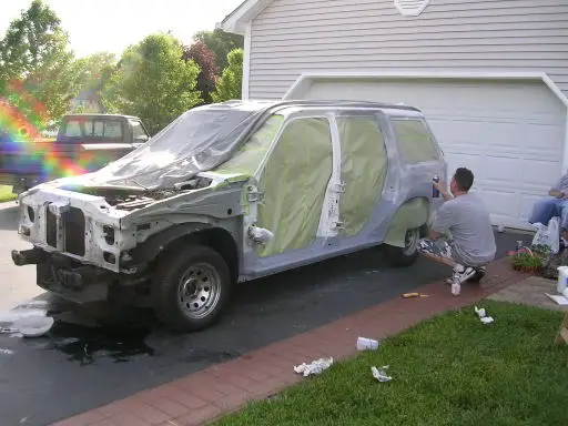

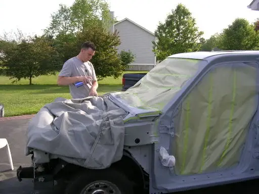

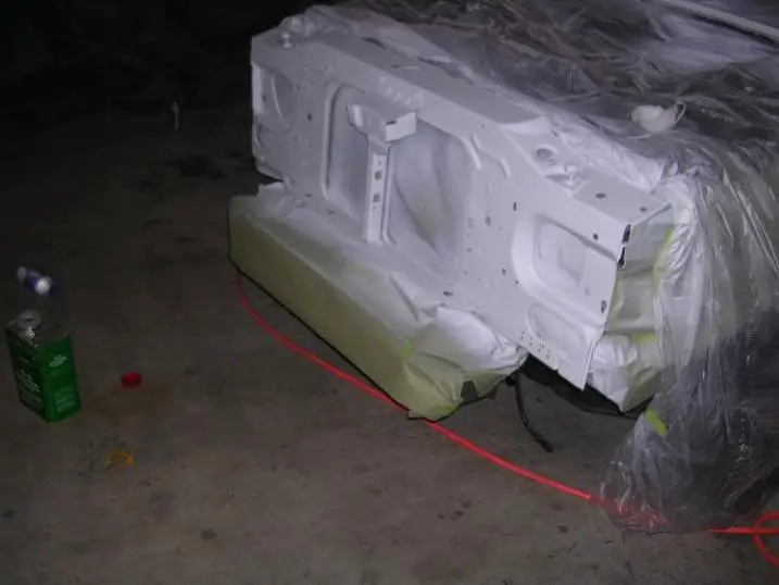

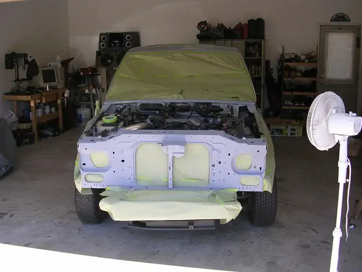

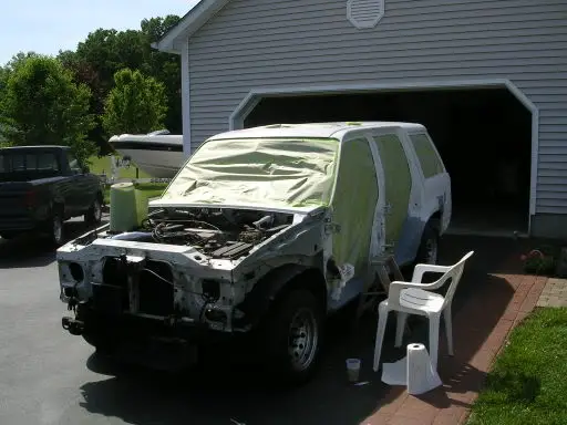

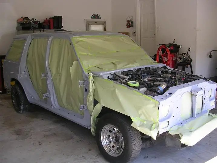

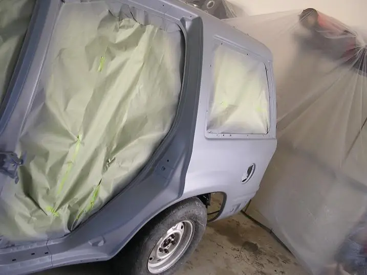

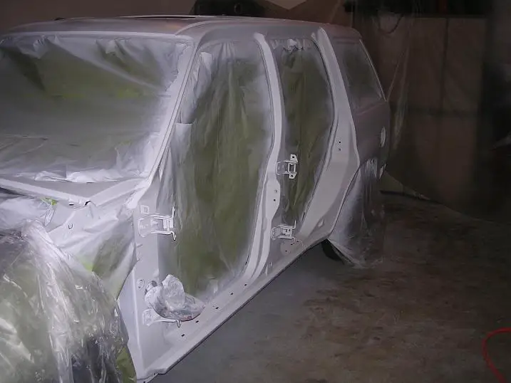

3M Taped up for primer.
Spraying some quick coats of U-Pol's high build primer out of an aerosol can. I prefer to go the can route because I just can't stand spraying primer out of my gun, it usually gunks it up so bad that I have to take the whole damn thing apart. Getting the settings back the way I like them on the gun takes forever too. We'll see how the rattle can works out.
Yeah, I know. I should probably be wearing a mask, I did feel pretty dizzy afterwards.
oh yeah EPA is gonna LOVE these photos :rolleyes:

The pictures were taken just to show the action, the truck was sprayed in an EPA approved well ventilated paint booth. :confused:

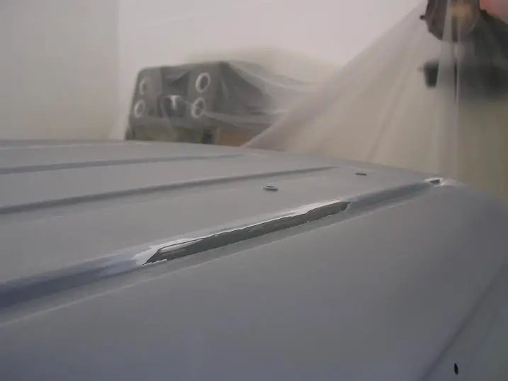

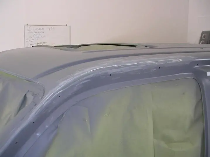

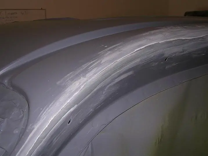

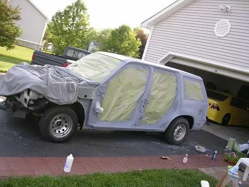

Here is the truck with the aerosol primer I had used. As I scuffed it down for the base coat the primer was holding very well as you can see by the bleeding white through the gray.

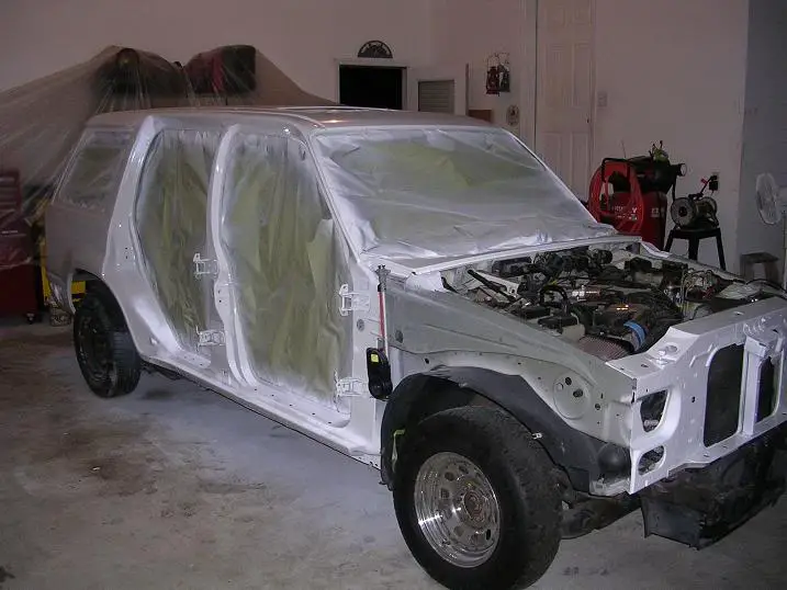

So I went down to the local body shop and picked up some epoxy primer/sealer, just to make sure we have no issues in the future painting process.
And what do you know, 103 degrees, sealer and some really crappy ford factory paint, what do you have, stock base coat lifting after I applied the sealer. I had to wait for it to dry then resand, feather and reseal. Not Fun.
Moving along..........
Finally sealed

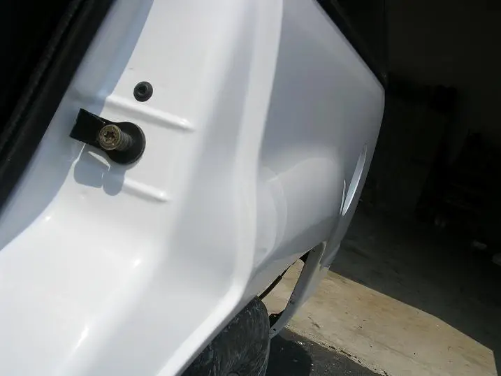

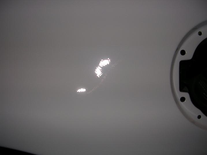

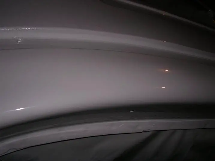

Here's so you can get an idea of how much orange peel I got over the course of clearing. I was using a slow hardener with the clear and it was still drying to damn fast.

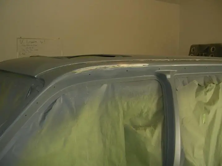

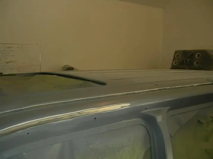

Started going at the roof, what a b1tch.

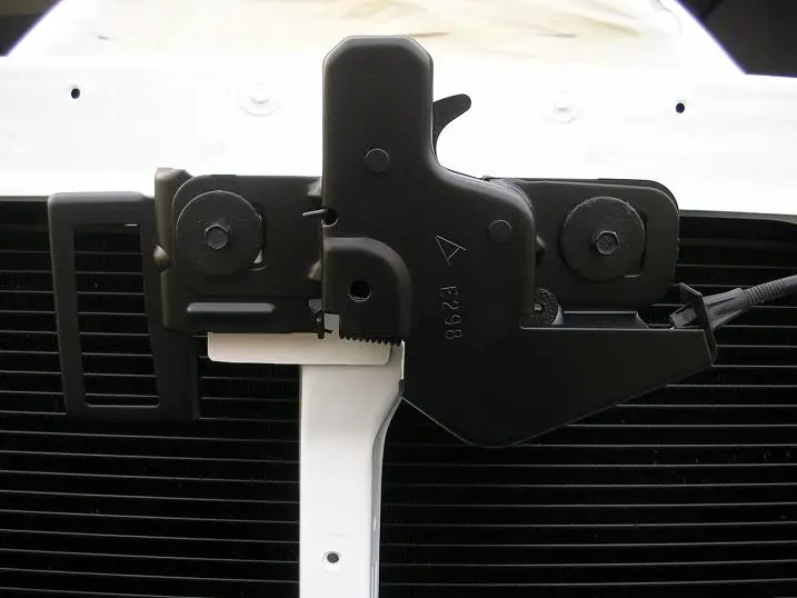

For the hell of it, I've been making it a point to leave nothing old untouched. I've taken the front end apart, radiator, tranny cooler, hinges, airbag modules etc.. do give em a nice fresh coat of paint. What a difference.
Trunk lock, just finished spraying it. All the black accent parts are flat black.

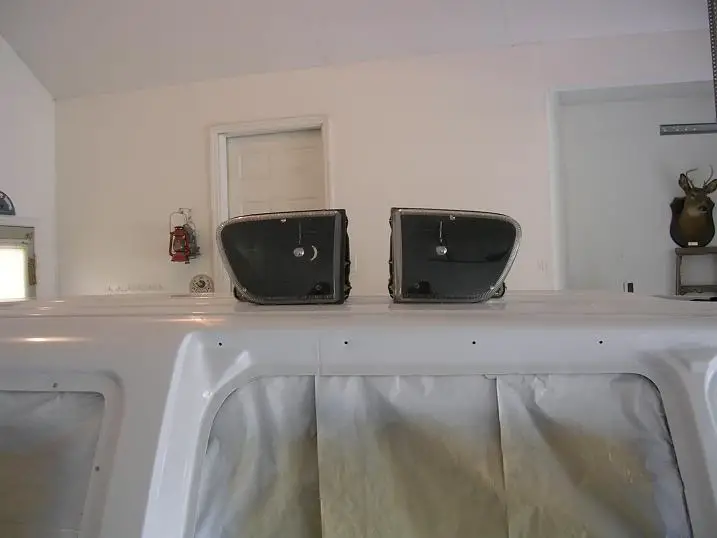

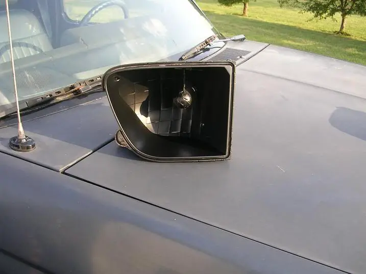

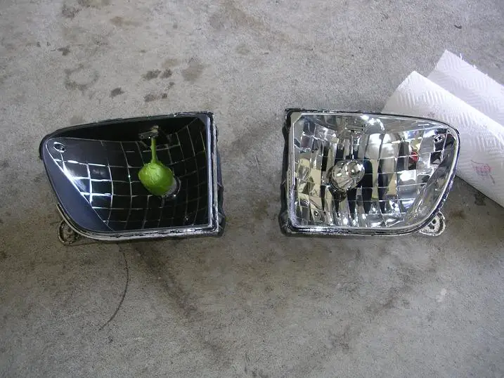

Well, small but sweet update. I was a little bored with the body so I went on to something else. Being that the truck has so many black accents, I went changed these up a bit. I think they should look sweet when it's all together.

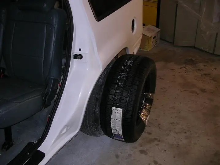

Some pics of the rear tires I'm going to try to shove in the wheel well.
You're not worried about the headlights sucking? :D Explorer lights are bad to begin with.
I think I like the headlights, If you don't, I'll trade my OEM ones for yours.
Did you use vht nightshades, or regular paint?
I am glad you tried it cause Ive been wanting to, just scared. What about the markers?
Looking pretty cool, waiting to see the final product.
I'm going to go with a set of HID's so we'll see what happens.
I used just regular paint. I'll give you the low down on the "how to" once I see how they work with the stock head light bulbs. It's a fairly easy process just a little aggravating.
