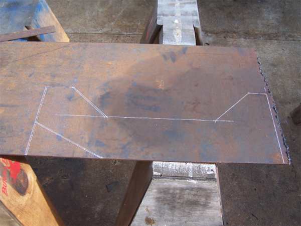

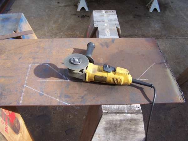

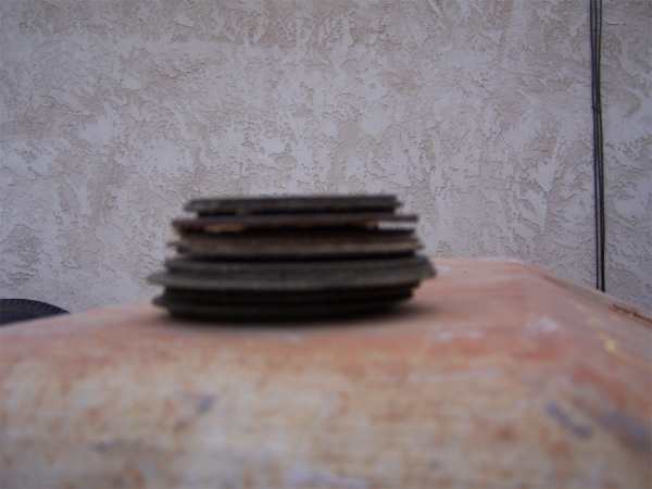

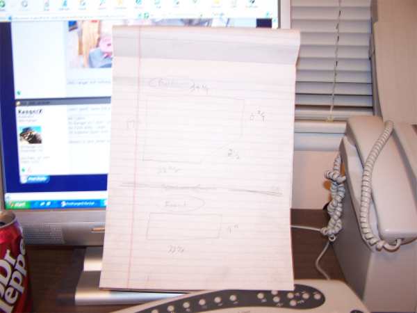

Well spent a few hours working on the truck the last few days. Started working on making a skid plate and mounts for the broncoII tank I am swapping in. So I busted out my super dooper drawing program. Then the super speedy cutting tool of choice. After a few hours and 18 grinding wheels later I had the pieces cut

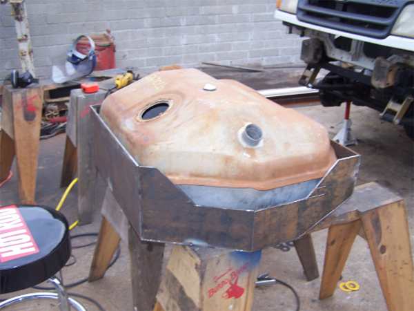

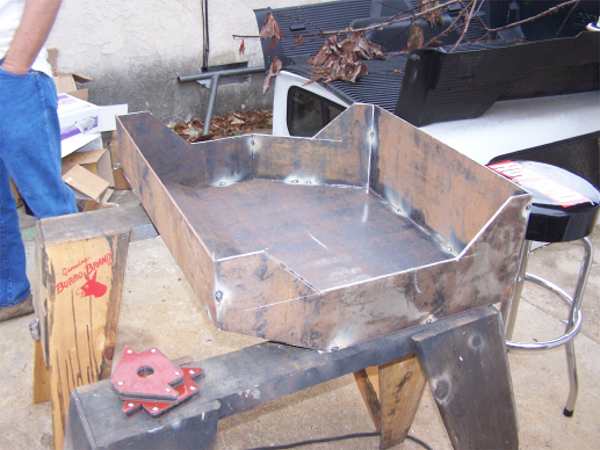

Here are all the pieces cut and tacked welded together. I got about 1/2 of it welded today before it got dark. It is made out of 3/16 plate steel. I decided on that thickness because that is what it seems like a lot of jeep gas tank skid plates are made of. I need to pick up some angle iron for the making the brakets to mount it and then some sort of straps to hold the the tank to the skid plate. It is one heavy pig.

I wish I had one. Until then its $2 a pop for grinding wheels. Also I would have to rewire the shed I work out of cause I only have 30Amps of service feeding it. Wouldnt have enough power to run the plasma and the air compressor. Works Ok cause I am the only one working so there is only one thing running at a time. If I upgrade to 50 Amp in the shed then I have to watch what is being run in the house so I wont trip the main breaker. Plus Ill only be living here another 6 months so why bother doing the upgrade. Once I leave all the 220V stuff is coming out of the shed and a tree will be planted to make backyard access in a car impossible. (parents dont want renters to be able to park cars in the backyard :D )
