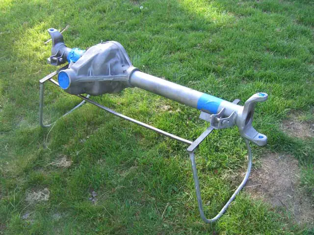

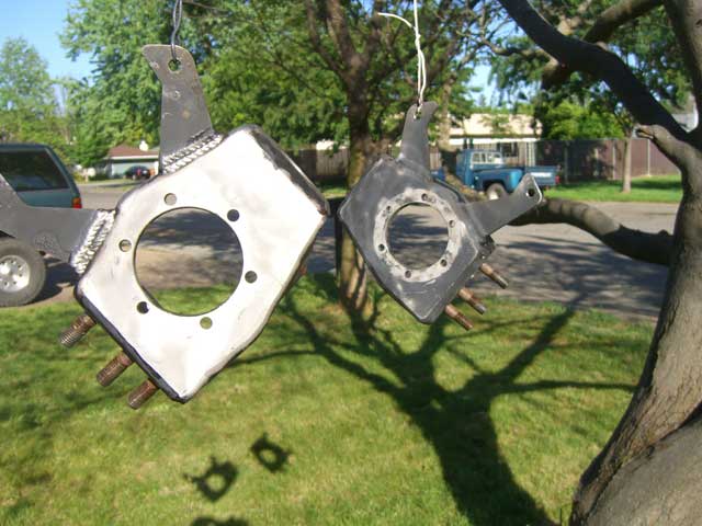

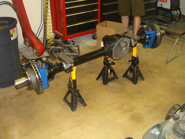

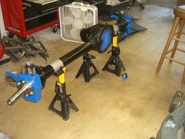

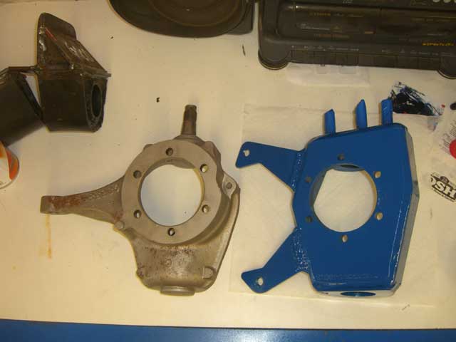

I picked up my Rock Equipment "Super Boy-Howdy" high steer knuckles yesterday, and Mr. UPS brought my 5x5.5 conversion kit... so I decided it was a good time to do some work.
I'll be ordering the steering arms and junk other steering junk from Parts Mike tonight. But at least it feels like I am getting somewhere now! :thumbsup:

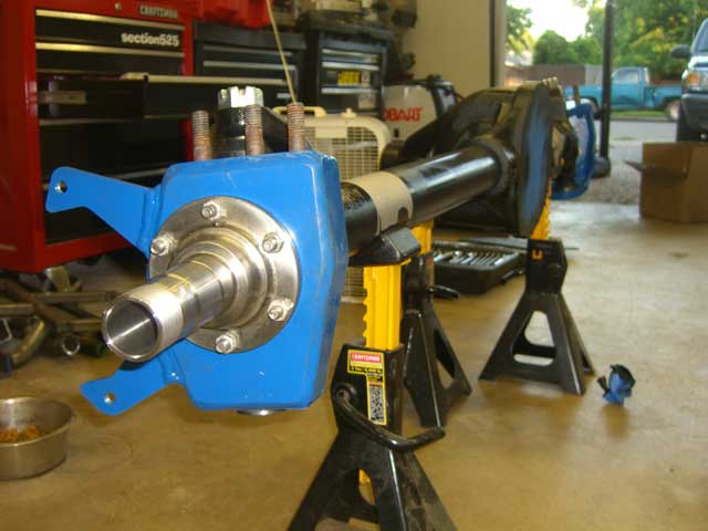

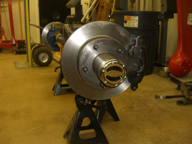

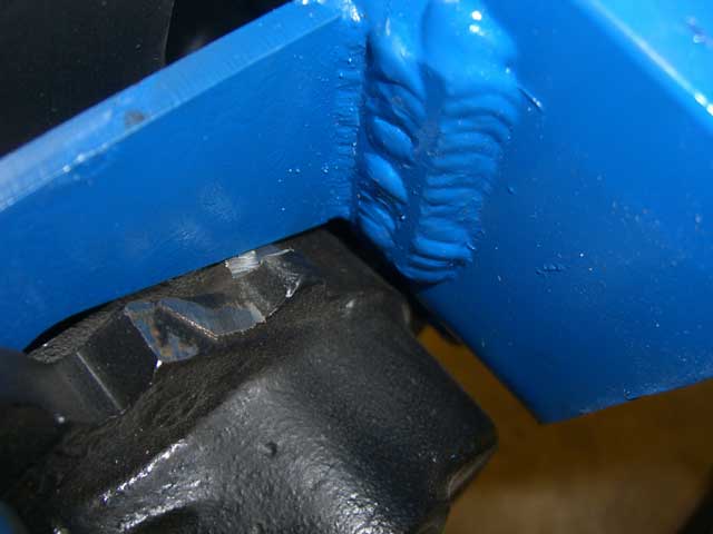

Only hold up so far was a little clearance issue with the brake caliper.

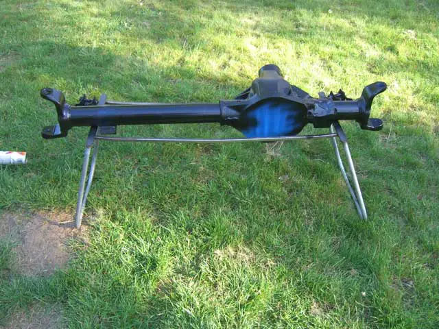

One more: :cool:
ahah! u have a habit of painting before welding :D
BTW, why didn't u cut the old spring perch?
Ah crap! :eek: I had better get started builing my axle. Your gonna beat me!
I masked off where the perches will go! :p That's bare metal under there.
The driver's side perch is part of the differential cast.. so I has to stay. I left the passenger side on so it will maybe be easier to set the new upper perch when it comes time.
