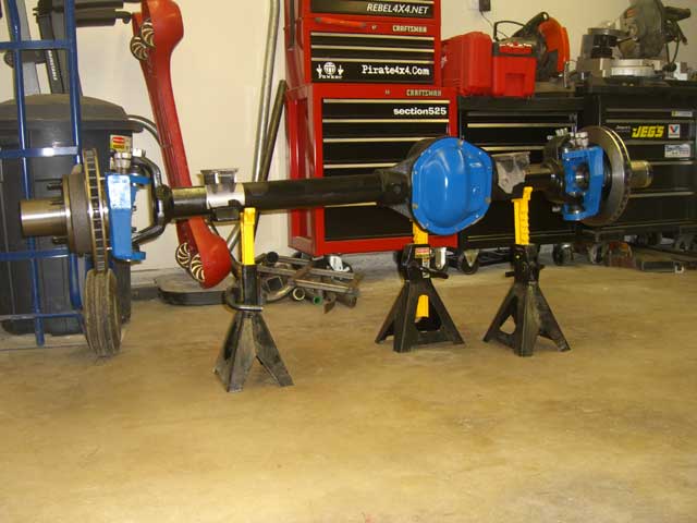

I am going to go out on a limb and say there's almost no way to do it with a V8. You obviously know how it pretty much sits on top the frame rail. Well on the 5.0s the AC sits right there. I just don't think it will fit especially with the BL gone. :confused: I wish it would since I already have the Yota box! :p
hey lets paint those frame rails before we weld to em eh ;)
Okay!

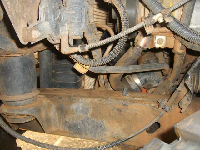

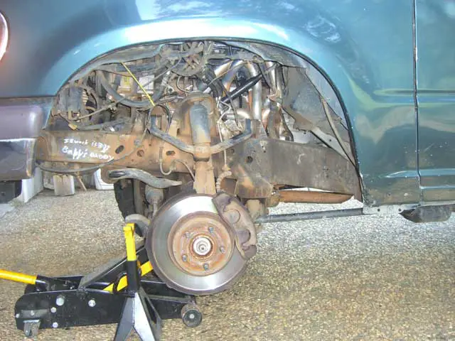

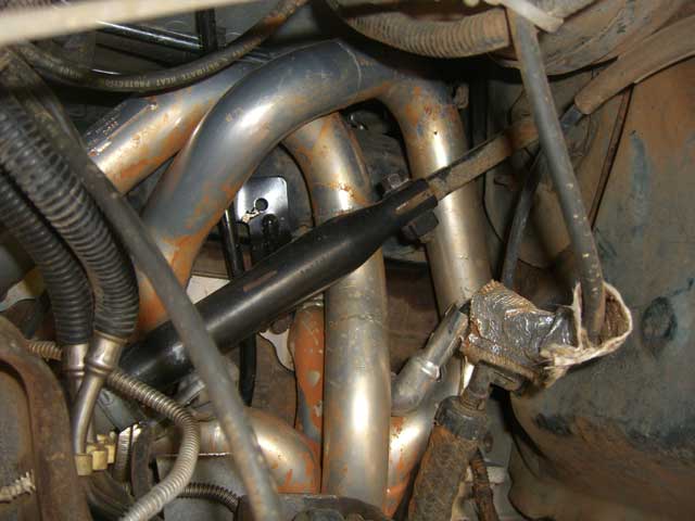

I pulled the BL out today. I leave town on Monday until the next Monday, so this weekend is the last time I'll be home before this thing starts.
The crossmember/leaf hangers look a lot better now. More tucked up. Same with my Draw Tite... and my tcase shifter.. and my header vs steering shaft. Gosh I love having no BL. :D
