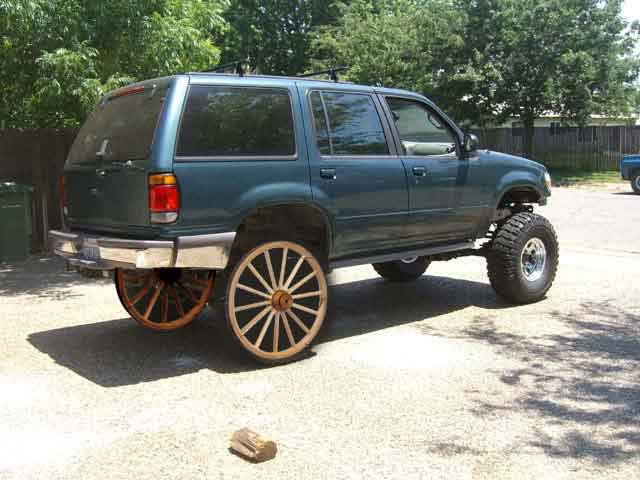

Well, it's clear from this pic that you need to plane your felloes plate. That's for sure what's throwin' it off :D

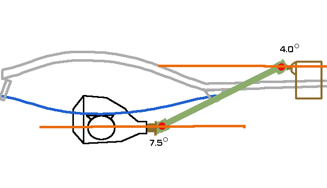

Well I let my buddy drive it and he's betting his left nut it's the driveshaft.
I pulled it off and figured out some degree-age.
The tcase is 4 degrees down and the pinion is 7.5 degrees up. So should I try and get the pinion down a couple degrees?
Thats what I would do.
A shorter shackle in the rear would help the angle, so I dunno if you're running the WAR-153s but if you are and still have the stock ones, temporarily swapping in the stock shackles might help diagnose the problem.
Orrr you could make some wedges - but thats probably more work. Or you could buy them :D
Hmm.. I've already made some stock length shackles for the my front leaves but haven't put them on it. Good idea, IZ. :thumbsup:
I dunno how much thats going to change the angle tho. So I guess you'll have to take more angle measurements after swapping shackles.
It brought the angle to about 5.25 degrees! But it is still a vibrating *****. :(
