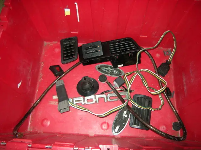

Well I made a trip to Pull-A-Part about a week ago and spent the least I've ever spent going there but I came out with a good bit as usual.
I got
  • 2 new center air vents (one as a replacment and another for a project I'll talk about in a min)
  • dirvers side airvent
  • one black pass side vent (couldn't find any tan ones that weren't busted)
  • A better condition trailer harness
  • another chunk of 4ga wire
  • spare 4wheel drive switch
  • the gromet for the wiring by the break pedal
  • and some other misc. stuff

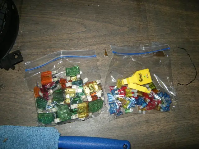

I nabbed 3 bags of fuse's. Mini, ATC and Maxi. To keep around as spares.

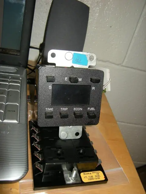

And last but not least I picked up a TripMinder message center to install.
TripMinder Discussion Thread
I'm going to mock it up in the spare center vent I have then install it. When I do I will relocate the 4x4 switches to the ash tray are where I plan to remove the ashtray lid and hinge it to flip down to reveal the switch panel that'll be replacing it.
