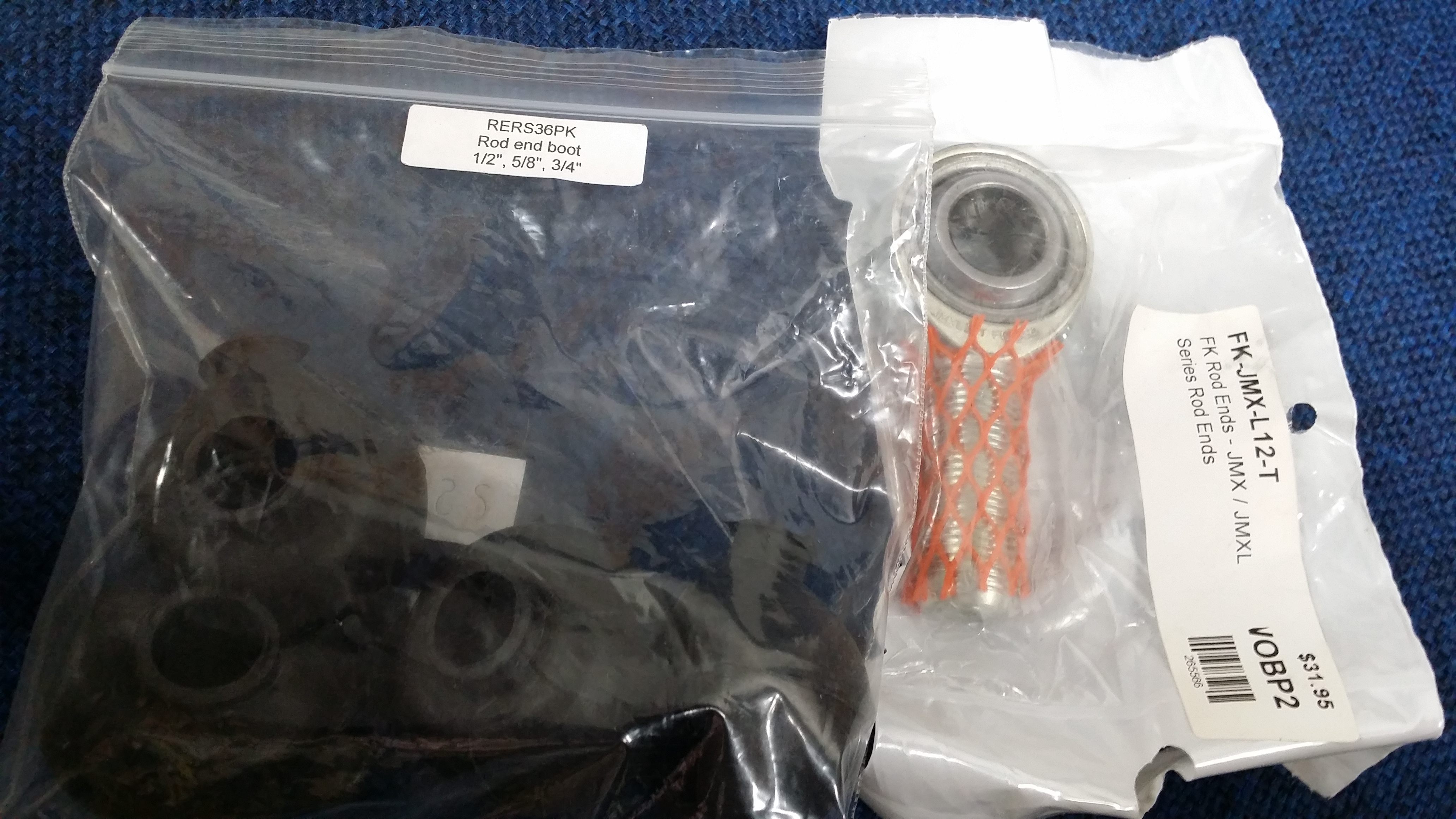

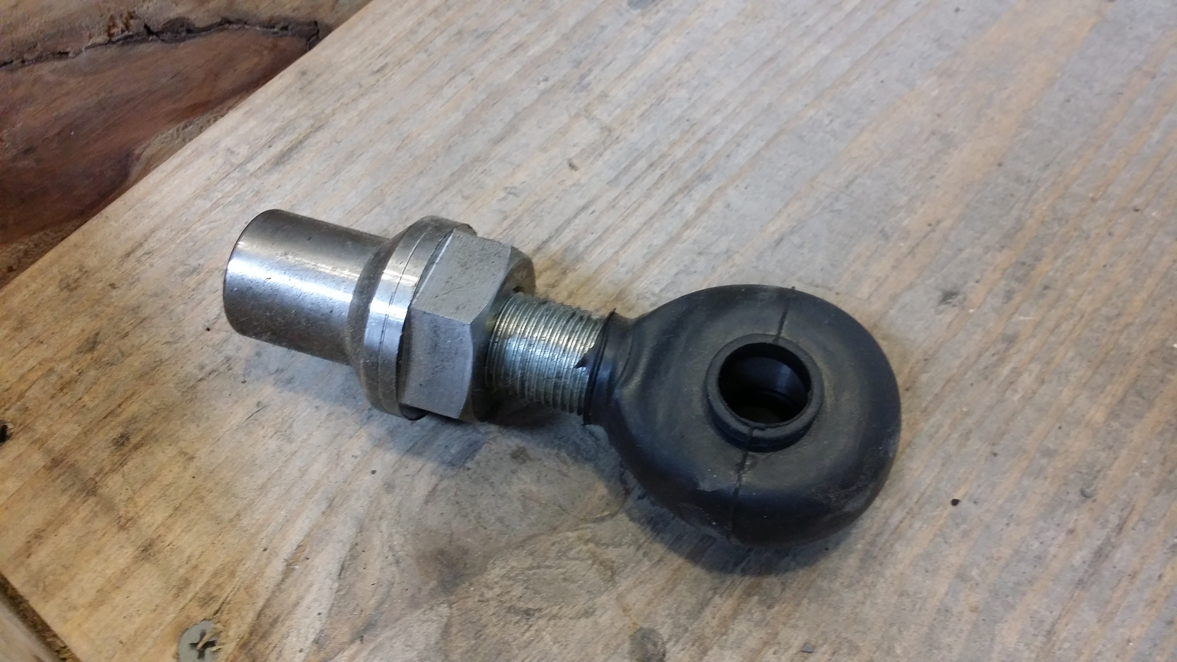

I'd look into some of the boots for the inners. My last 2 sets haven't made it past over 15k miles of road driving. I'm just now trying out the boots so don't have any reviews yet. These are from seals-it.
I figured they would be like most Heims and will need some attention down the road, and thought about modifying the bellow boots to fit over them. I decided against it when installing, thinking they wouldn't stay on, and I would be constantly messing with them.
Thanks for the info, as those look pretty neat if they work, and hold up to the heim bolt. I might give them a try if I can find em.
Oh and buy the 6 pack, I tore the first one I tried to put on. They are super stretchy but also super tight so they seal around the threads and bolts.
I'm going to be working on a bellows boot also for mine but I've been running without them for awhile. The factory one definitely won't work and will get pinched between the rack and adapter at full lock and crack the r&p housing (ask me how I know). They require boots here in va for inspection.

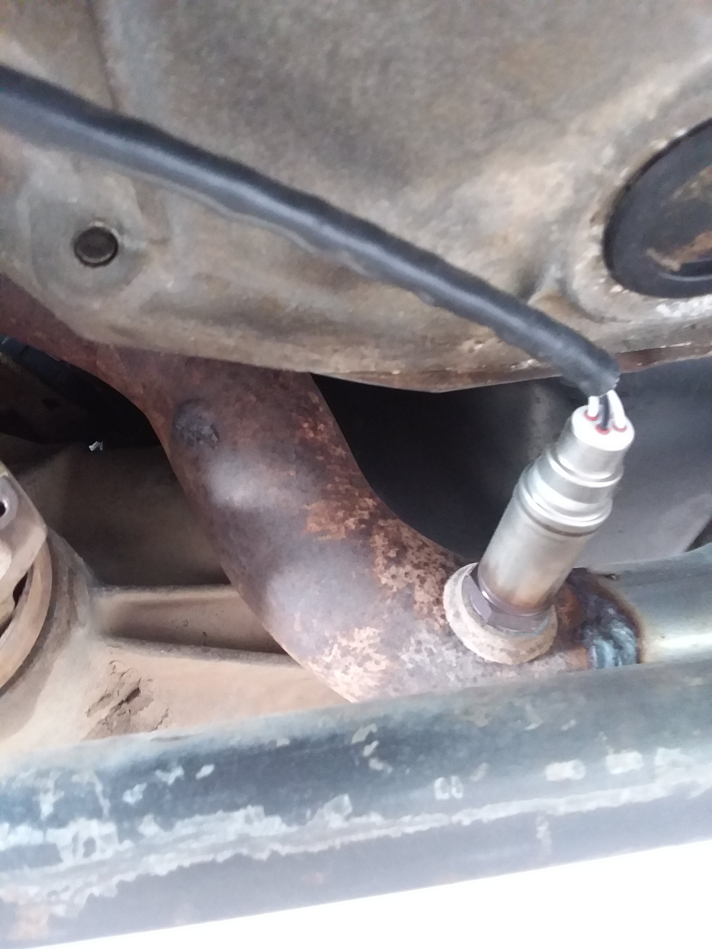

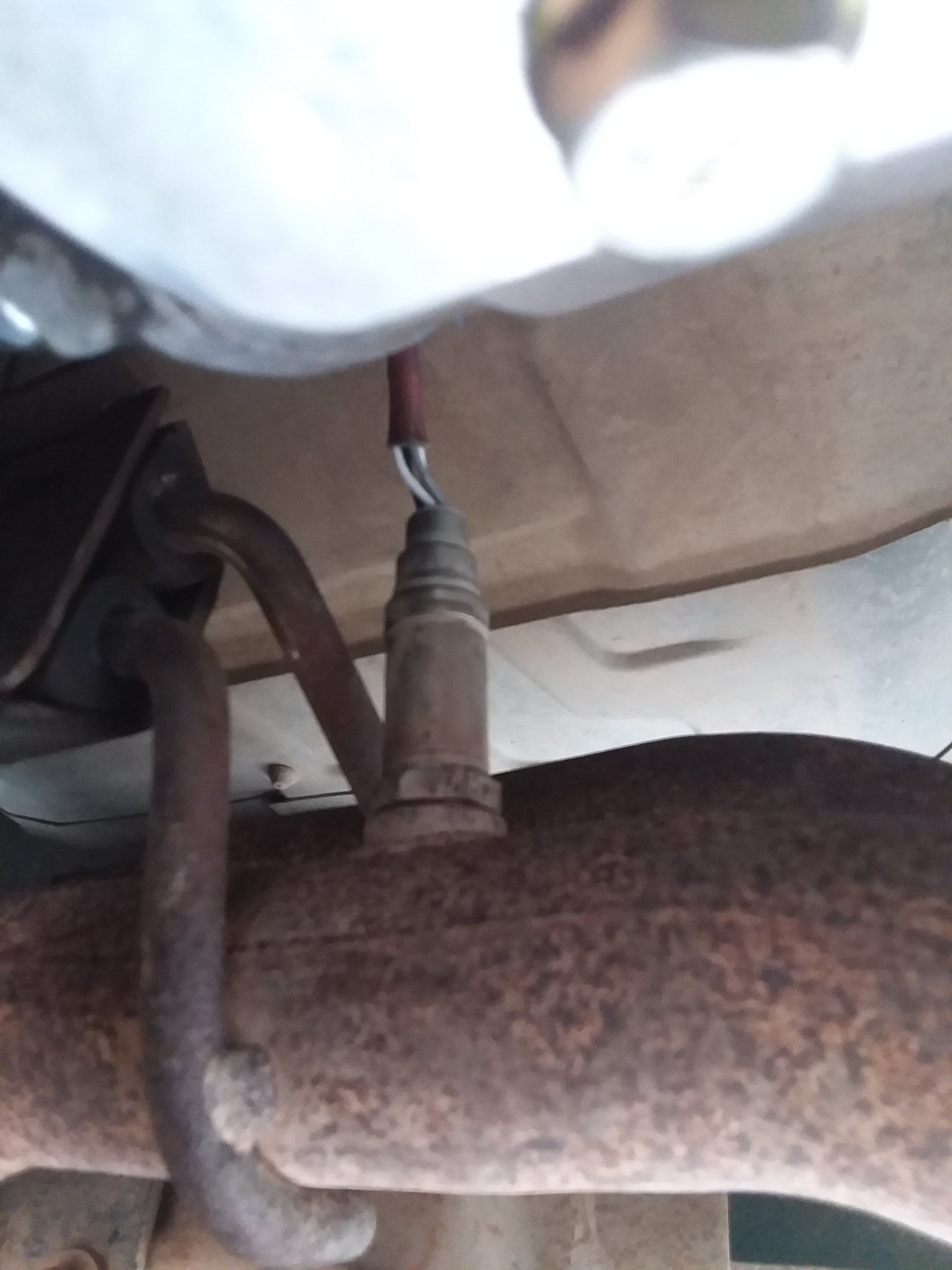

After removing the t-case skid, this is what I saw....
Old O2 on old pipe, & 1 new O2, and I'm not sure that isn't the same one Jon & I installed last July, on the way to CO.

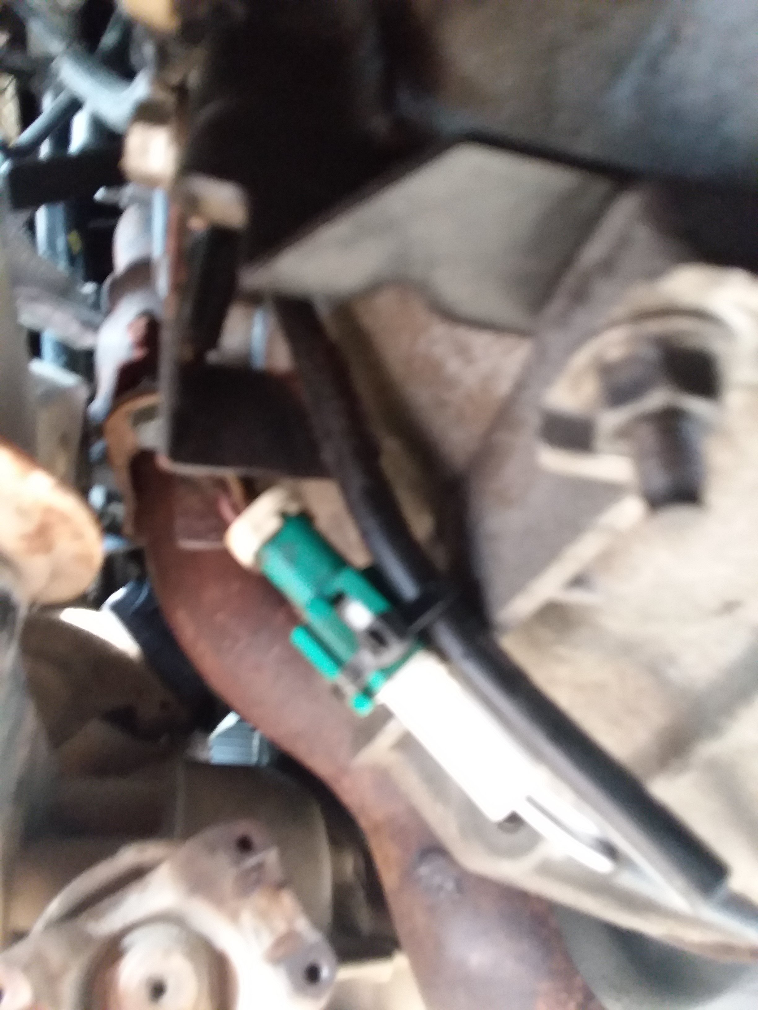

The O2 plug, ziptied to the dipstick. smh...

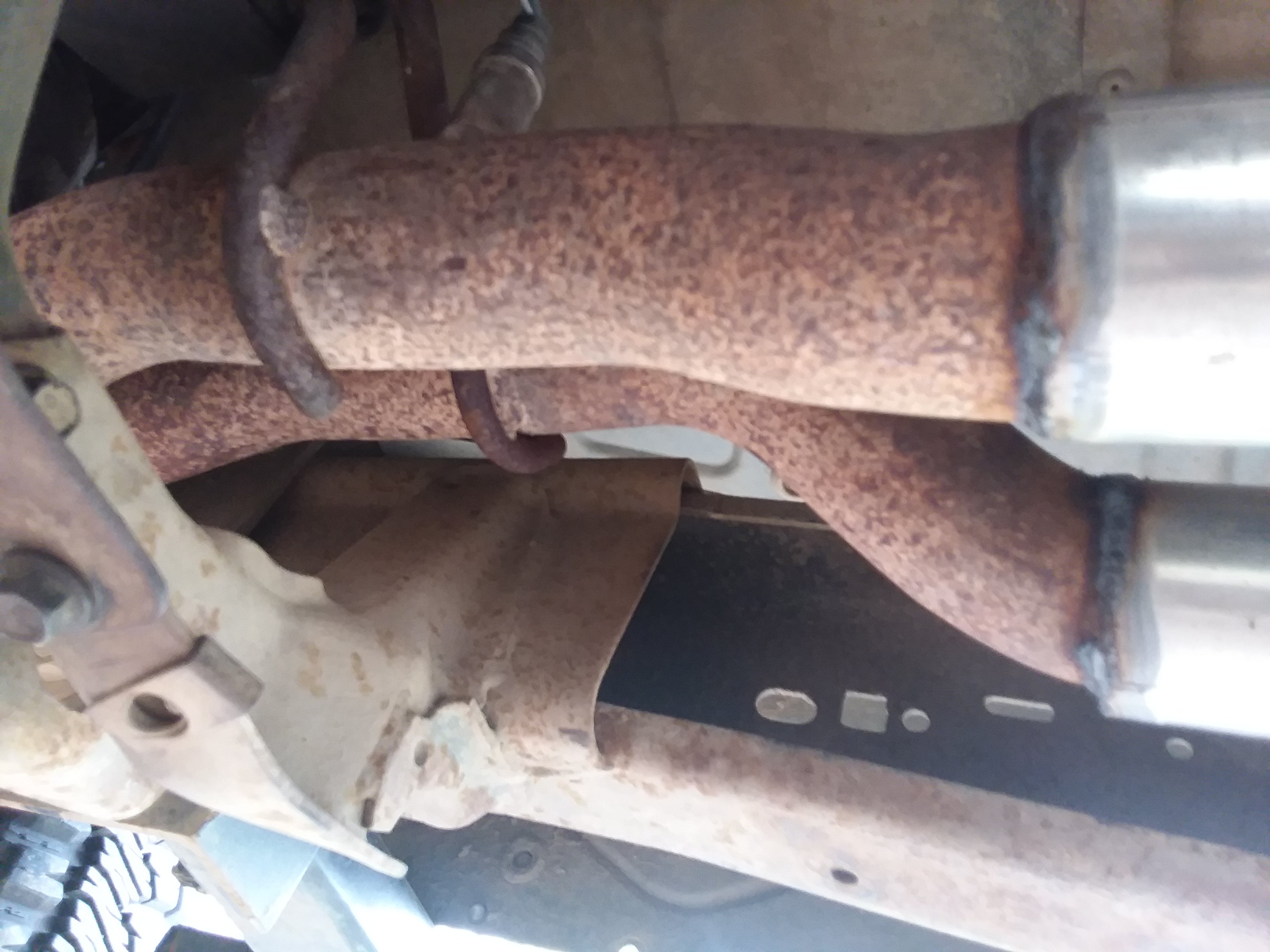

And some more old re-used exhaust pipe.
So instead of 2.5" pipe all the way back, I now have a mix of 2.5" to the cats, then old 2.25" pipe to new 2.5" pipe, to the mufflers and back to the tailpipe tip. Awesome!! :splat:
