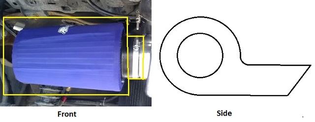

my argument is (not really a argument, but a concern for dons motor and turbo), and don has heard it, so lets see what others may say is this. for you that live in the snow belt, if you have ever looked inside your rear bumper after driving in either sloppy wet, or fluffy snow, the bumper is packed. now if he tucks it into there, it may either suffocate the motor, or drench the filter. same with where it is now. it wont get packed with snow, but will be a target for any mist at the back of the truck. i know i am trying to think of a shield that can be made to cover it, but still be able to breath, and be accessible. making a box might choke it.

I think the air filter shroud should be larger than the filter to allow airflow to all sides of the filter but only open at the rear. The bottom of the shield should be angled slightly downward to allow moisture to drain. It should extend rearward enough to keep snow and rain from getting sucked in.
Air box
Most air filter boxes I have seen have some kind of drain holes at the bottom to drain off any water that may have gotten in there so I would follow that practice. I am sure whatever you come up with, we will all be interested in seeing the pictures!!!
possible shroud configuration
How about something like this?

I was thinking about something like that, but maybe cutting a few holes in the top also and then using stand-offs and more material to create a 'baffle' of sorts.
I'm not sure how well that work if the suction just sucks the snow in to the box and fills it up though. There's going to be trial and error here for sure, I just hope I don't get myself stranded.

The ARC air compressor goes up there on those models. It's large enough to create a sizable air inlet cavity if you try to. I'd leave the air filter right where it is, and build an air cleaner box around it, with a large inlet pipe going up into the area above the spare(going around the front or back of the cross member there), and position the initial inlet and drain holes up there. The larger the surface area of the actual inlet holes are, the slower air travels through them, and less water too.
Maybe a large 2' x 2' air box up there with most openings at the back, and the exiting hole at the front up high, with a few drain holes around the bottom surface, then only minor water mist could make it to the air filter.
You want the air going in and through the air inlet to be relatively slow, to cause water to drop out of it and drain away.
