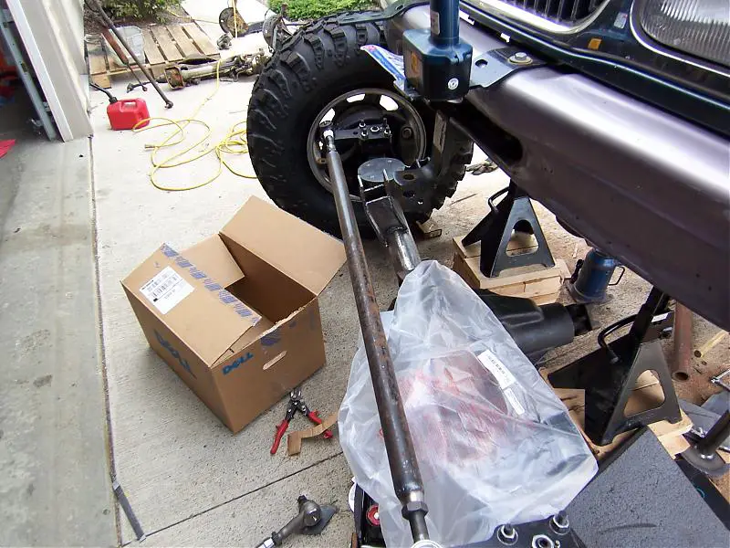

Well, it all started with me breaking an axle on friday. Had to drop the diff to get the broken shaft piece out. Then the seal was ruined as well, scrapping a trip that i had planned for 2 weeks in advanced for on saturday.
I was thinking, why waste 50 bucks on the ifs axle when im gonna be ripping it out shortly. So i called my buddy and we started tearing into the mounty at 6:30 pm until 10pm, and monday from 2-10pm. We are on hold for parts so we can make brackets.
I have 2 Rustys off road 180 pound coils, 24" extened, we calculated that it should be around 18 inches compressed. As for the suspension design, its getting a triangulated 4 link. It kinda helps when you are friends with a suspensions engineer.
Well heres the progress so far. More to come next monday.

The calipers i used for the rear were 85 chevy calipers.
Aric, your truck wont be as wide as mine. The reason i say this is becuase with a stock 60, and the stock hummer rims, you will only stick out at what your at now. However you said that you are recentering yours, so if you have 4" of reduced bs on those hummer wheels you'll be just as wide. Speaking of wideness, i am legal.....just shy 7 inches from being in the red.
I still have panhard mount and steering to do. Panhard will be put in tonight, and hopefully coil buckets too.

Aric, NO CONVERSION JOINT!!. The expedition driveshaft bolteds right up.....I was pretty surprised. Also, the u-joint for the front bolted right up to the d60 too, and i dont need to lengthen or shorten either the rear or front shafts. The increased lengths of the diffs make up for the hieght. Actully my rear shaft is a bit long, but i still need to raise the rear 3-4 inches so it should be perfect length when all is said and done.
Brake lines will be hard all the way to the ends, then stainless braided lines from the frame to the axles. I'm hoping i dont need to swap my master, but if i do, oh well, i have one with the cruise control from a f-350 so it shouldnt be a problem.

super flexy leafs....stock spring bad with some added springs for hieght.
we worked until 2:17 am last night.....we ran out of wire :(, so all that got done on the drivers side was a plate was weled in with 2 inches of weld left to go.
1 10 pound spool of mig wire down so far.

the front is sitting on its own wieght finally. Tonight the steering box will be put on and some other things will be welded.
