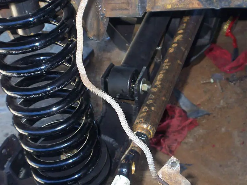

here ya go.
some more
the last pic i took yesterday. Obviously there is paint on the axle as seen from the other pictures.
Also ignore the bolt with the 2 washers and a nut. I ran out of the correct size 9/16" so i used this one just to keep things together.

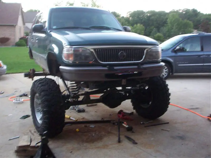

Left to do:
Plumb front brake lines(rears were done yesterday
Plumb ps line
make cross braces for the upper link cradle with the plasma cutter
drill out the ps box holes
mount box
bleed brakes
bleed steering system
.and the worst one....somehow get the rear 4 inches higher to match the front
remove bodylift as it is too high as it sits.
What is the benefit of having the 3rd link on the truss above the diff rather than simply having it over one of the other links radius arm style?
friggim looks awesome so far man
Sweet Project, i think i may steal your coil bucket idea when i redo my front end in a few months.
why are you running dually hubs in the front? on regular wheels ur gunna burn up those 60 wheel bearings...yes its possible
Yeah, I hope they leave him alone. 6" past the fender is the law here
i say he cuts up a blue 55 gallon drum for flares..... thats my plan
Any plans to lower it some or is that your final ride height?
Holy crap... I guess Chris was right when he said almost the whole wheel was outside of the fenders...
Ill give you that ride you wanted in my X if I can get a ride in your Mounty when its finished...
