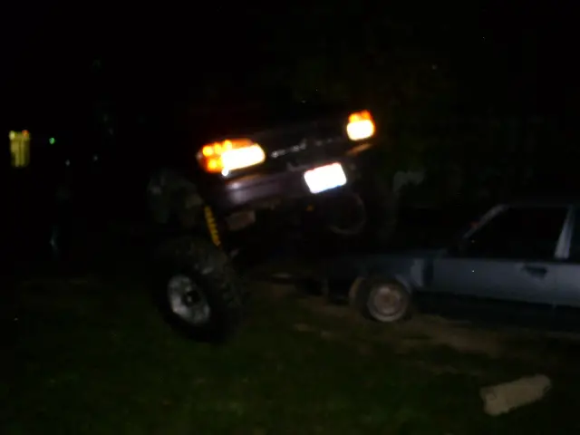

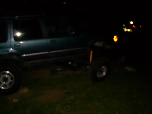

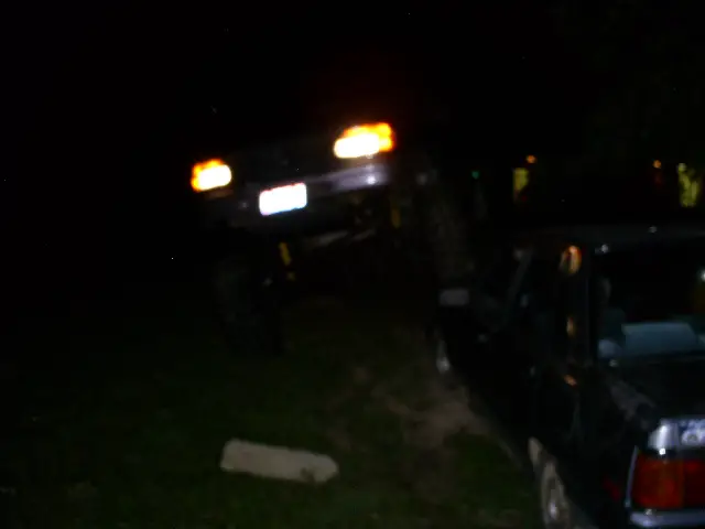

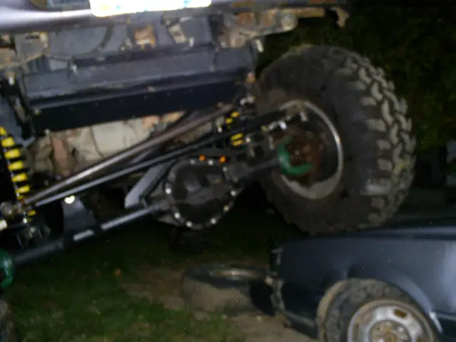

Sorry that i havent been able to get any pics yet. I've been super busy with work and school. Hopefully Thursday i can get some pictures of her flexed on an RTI ramp or something similar.
As promised.
Tire is there as a step. I couldnt get up the hood of the car without pushing the car.
