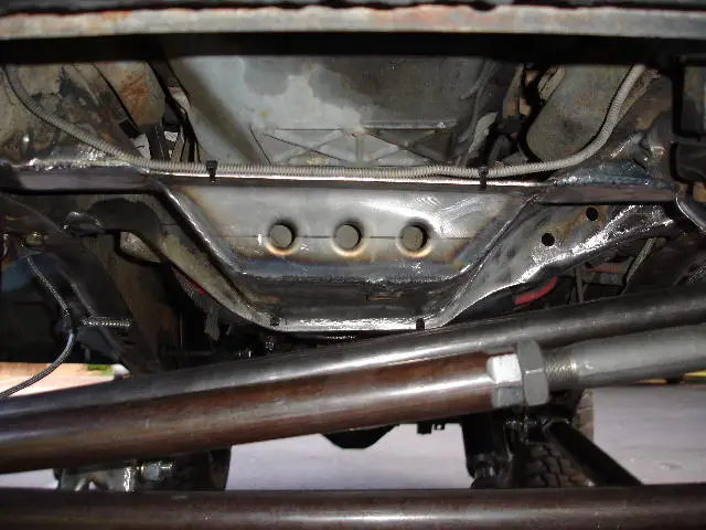

Froader - I'll grab you some pics of the cross member later today. They did a nice job on it.

Froader: The crossmember. They cut off the lip on the front and added the gusset you see. They also plated on both sides to strengthen it. If you want other angles let me know.
Thank you sir, that pic does me just fine. :thumbsup:

That is just badass Michael I sure would like to see some other close up shots of some of the mounting points and so forth.
Edit: as I posted this you posted the pics I needed, THANX! ;)

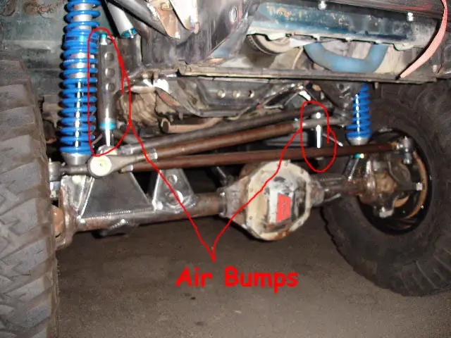

BTW, am I detecting that you are possibly going to get some air time with this thing? :eek:

I'll grab some pics of all the mounts for you tomorrow, if you need others. Air time may possibly happen ;) , but the truck is not built as a jumper. Without a serious truss the Dana 44 isn't up to landing a 4600lbs truck. Mainly the airbumps are a progressive, tunable way to control the small amount of uptravel that I have. Instead of suddenly bottoming out on a rubber or poly bumpstop, these get progressively stiffer until the end. Plus they look really cool :smoke: .

Thanks for the pictures That is exactly what I wanted to see. I can see how it can be a real pain to get the tranny in and out of there now. Did you have to move the cats back to make the them fit?
