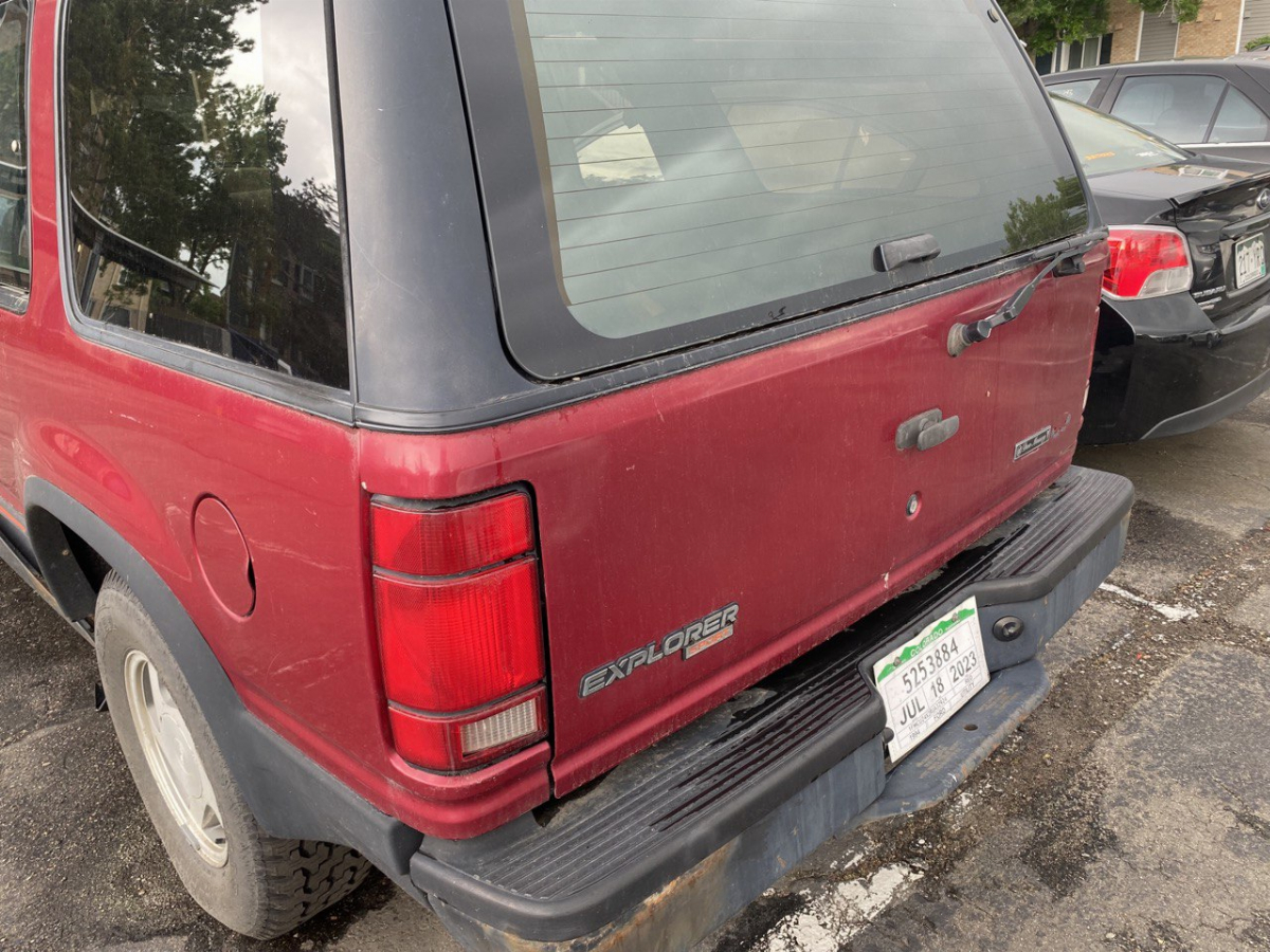

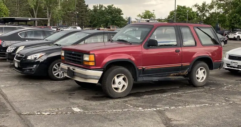

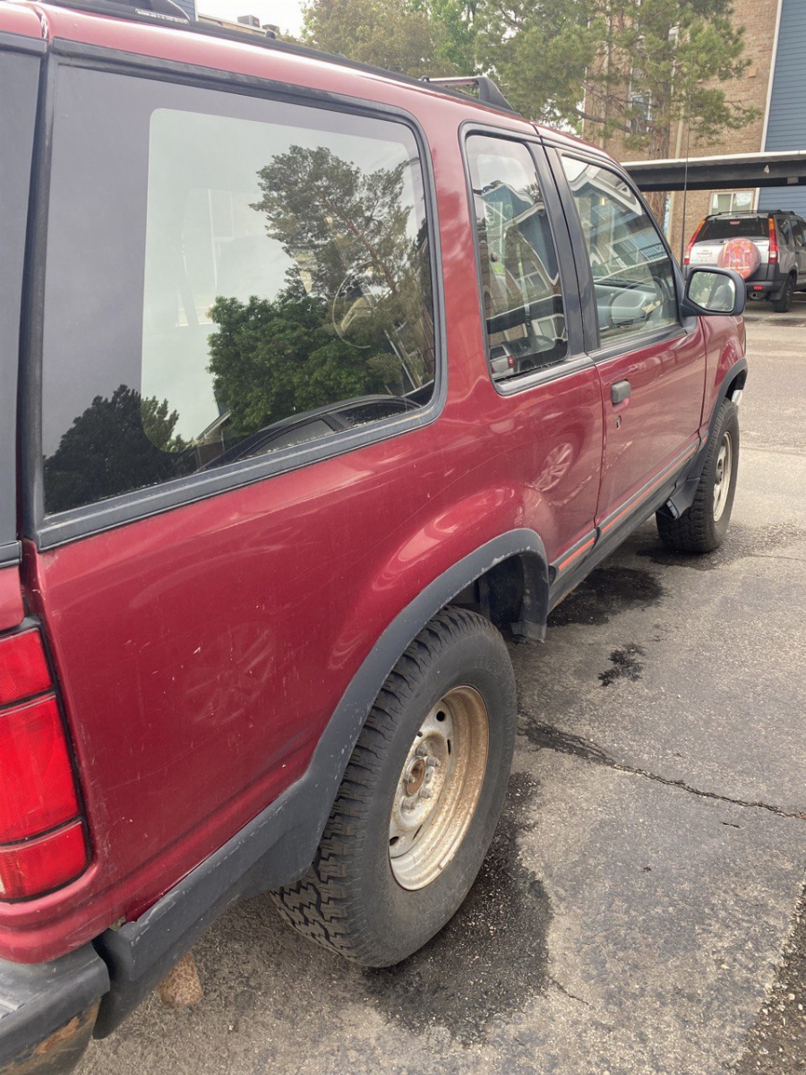

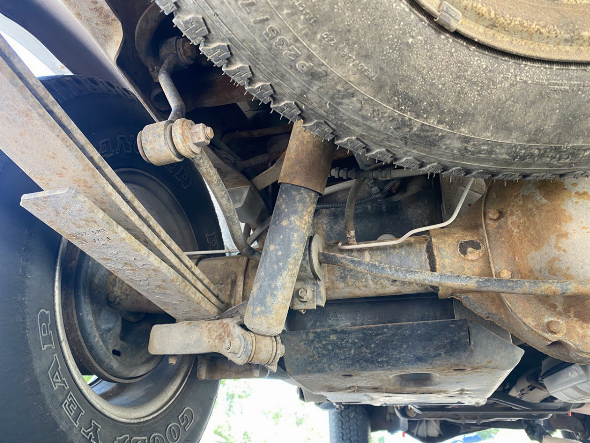

We haven't gotten around to a name yet, but here's the beast in question. 4x4 works well, hubs lock and work well. Guy who sold it to me indicated that the previous owner used to take it mudding on occasion, and had tapped a tree and broke the original rear passenger wheel, which is why the spare is on it. He evidently gave it a decent smack, because the tailgate striker bolt was missing when we bought it, and the tailgate strut on that side is ripped out (although I have noticed that to be a fairly common problem with these vehicles.) Aside from some rust to the rockers, it's an astonishingly rust free vehicle.

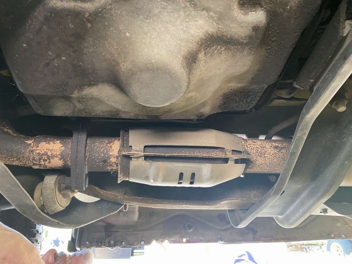

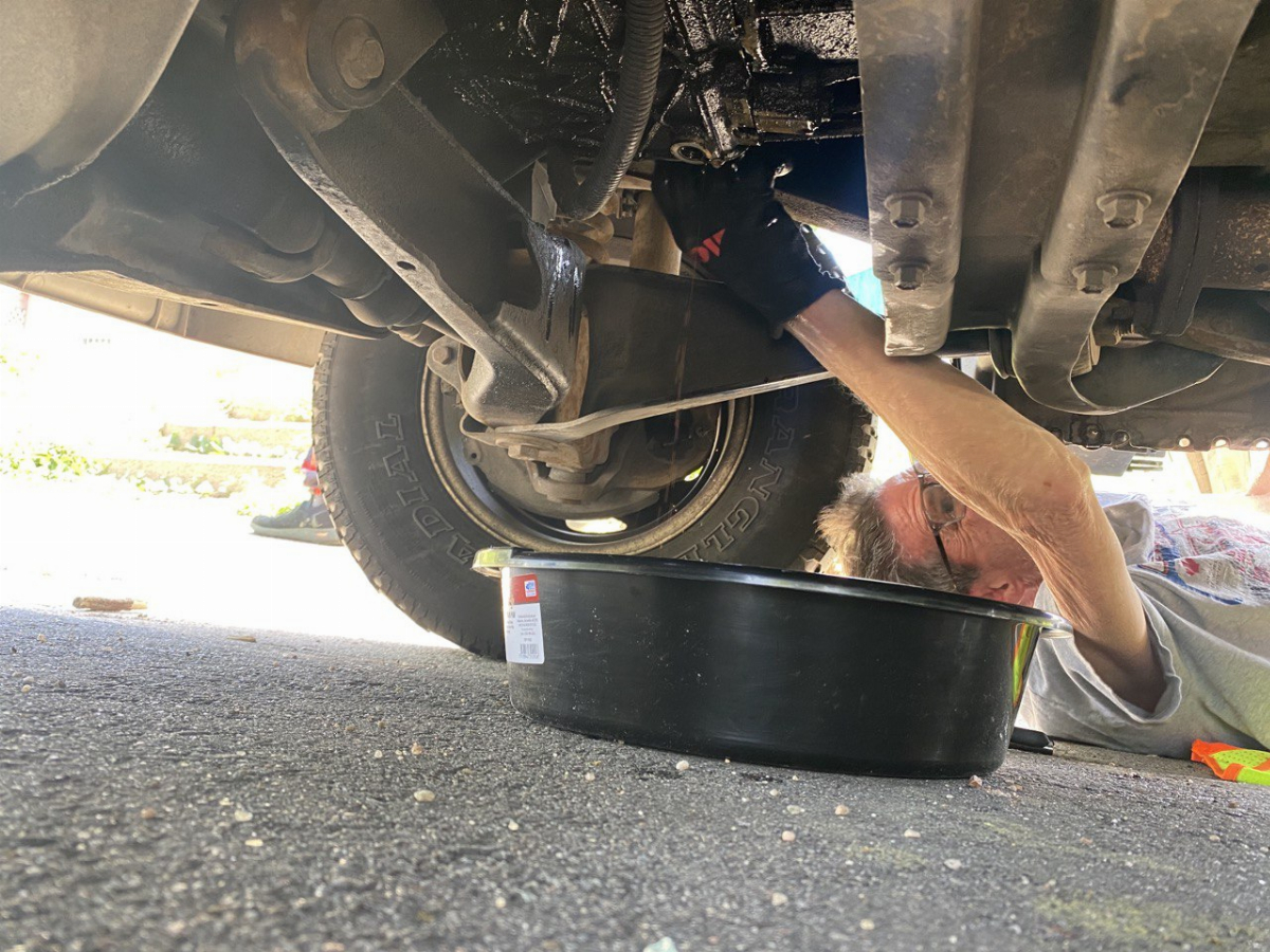

Well, as you can see in the picture of my dad wrenching on the oil filter, the oil pan is pretty nasty. It's got around 200k per the VIN lookup at last report, so I'm not sure if that's just typical road grime for 30 years of driving, or if we've got a small leak somewhere. There was a jug of oil in the back when we purchased, so I'm suspecting the latter. I'm sure it's just old seals somewhere. Plan is to give everything a good deep clean, so we can actually see what's going on, and then diagnose a few things. There's an exhaust leak somewhere that I want to address asap before going to emissions, needs a new intake tube either built or bought, and it's got a tiny bit of shake in the wheel over 62mph indicated that I think will be remedied with a tire balance. This may wait though, as I'd like to get some larger wheels and tires for it before getting it aligned/balanced. Ideally I'm thinking 33's would be perfect for the type of stuff I'm looking to do.

Torsion twist doesn't apply here, you should have coil front springs.
That being said, 3" body lift and 33" tires, a set of old man emu rear leafs, will have you riding nice on those roads. You'll be able to go just about anywhere.

Yknow, I've been under this thing a couple times now and not *once* did I bother to actually check -- despite being able to see them in one of the pictures. I'll take a look at that build you linked. :thumbsup:
