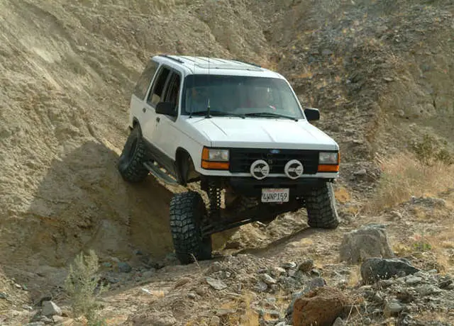

What kind of front end flex do you have Colin?
I was also thinking about this when i was tossing up a link or radius arm setup.
Raidus arms.
Raidus arms.

I saw those over there a while ago. I guess weight doesn't really matter for radius arms, so I'm sure they'd work great. They will hang a little lower than the duff arm(pictured in that thread) and mine the way they are just extended and boxed.
Well i didn't mean that exact arm, but the idea. The good thing about making an arm like that is that i'll be able to tuck it up against the frame like a link set up since i'll have a heim on the end of it.
