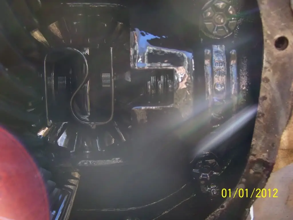

Opened up the 97 4.10 8.8 and found this awesome sight. :rolleyes:
Black as can be 80-90 gear oil! ACK!!!!!
The carrier.
The ring gear.
dang....are you putting an ls in there?
Looking for a locker for it. :)
That looks like a LS carrier to me. AFAIK, that limit your lunchbox locker choices. Are you looking at full lockers (with carrier)? Maybe like that Eaton one that is a LS when unlocked and locker when you flip a switch.
~Mark
would rather have Thick Black Fluid then off White fluid in there :)
It cleaned up well. Took a bit to drain, then wiped it out with rags, and brake cleaner. Nothing wrong inside, everything looks good to go. :D
Spent some time with the grinder & wire wheels cleaning it up. No leaks anywhere on it, all seals are good. :thumbsup:

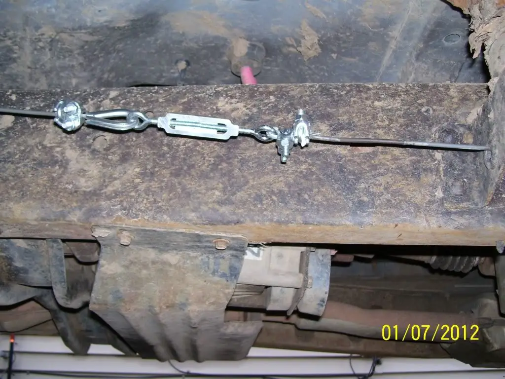

Still have to hit up the local hardware store for the E-brake retrofit with the turnbuckle mod. Cant wait for this thing to get installed. 12 mpg sucks with 33" & 3.27 gears! :(

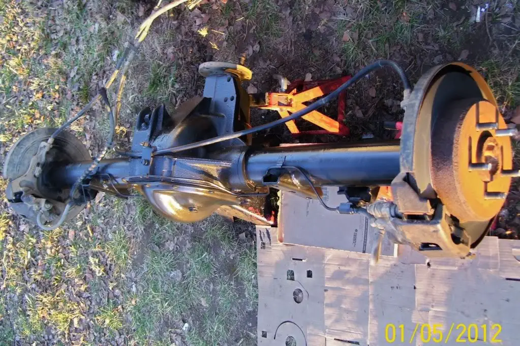

We had a beautiful January day, so this afternoon was spent outside prepping the new(er) 8.8.

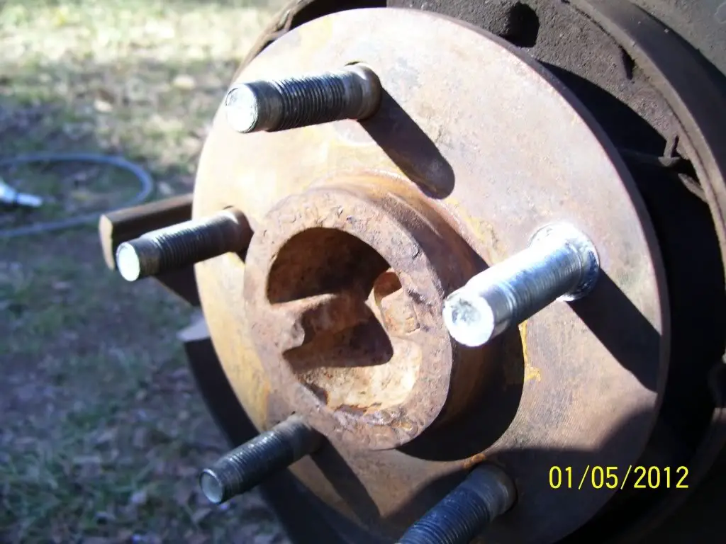

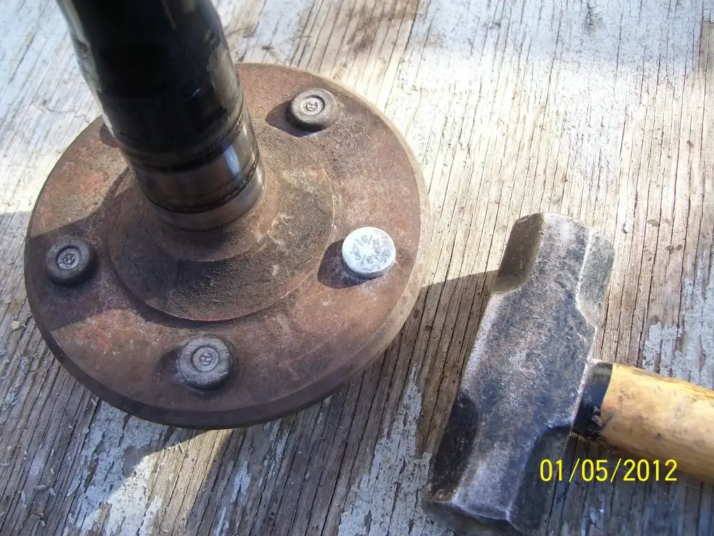

Pass side had a stripped out lug stud, so the axle had to come out and remove/install a new one.

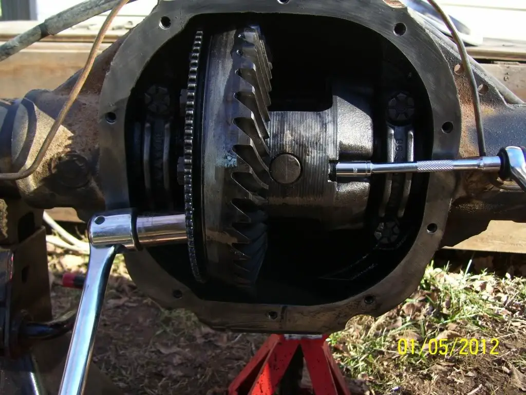

Figured while I was at it, to install a new diff shaft bolt. Couldn't hurt anything :)
Removing the bolt. 8mm on the shaft bolt, 19mm on the ring gear bolt to hold it from turning.
New bolt. Got a spare for the tool box as they are cheap, but when you need one, you really need one!

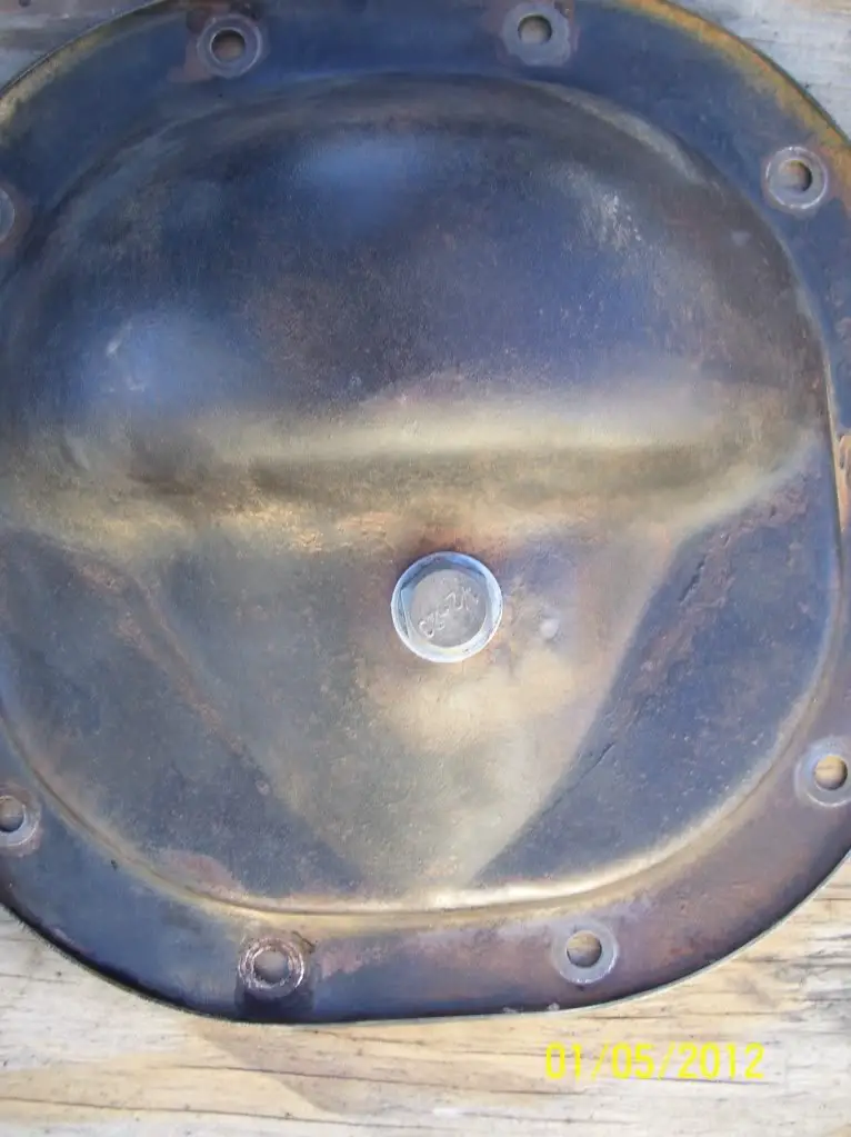

Now this axle cover had a fill plug installed by the previous owner. I checked it out, and looks good.
Backside showing the weld and grind.
The reason why. Stock fill plug looks like it was froze, and got mangled trying to remove it. It has a tack weld holding it in place.

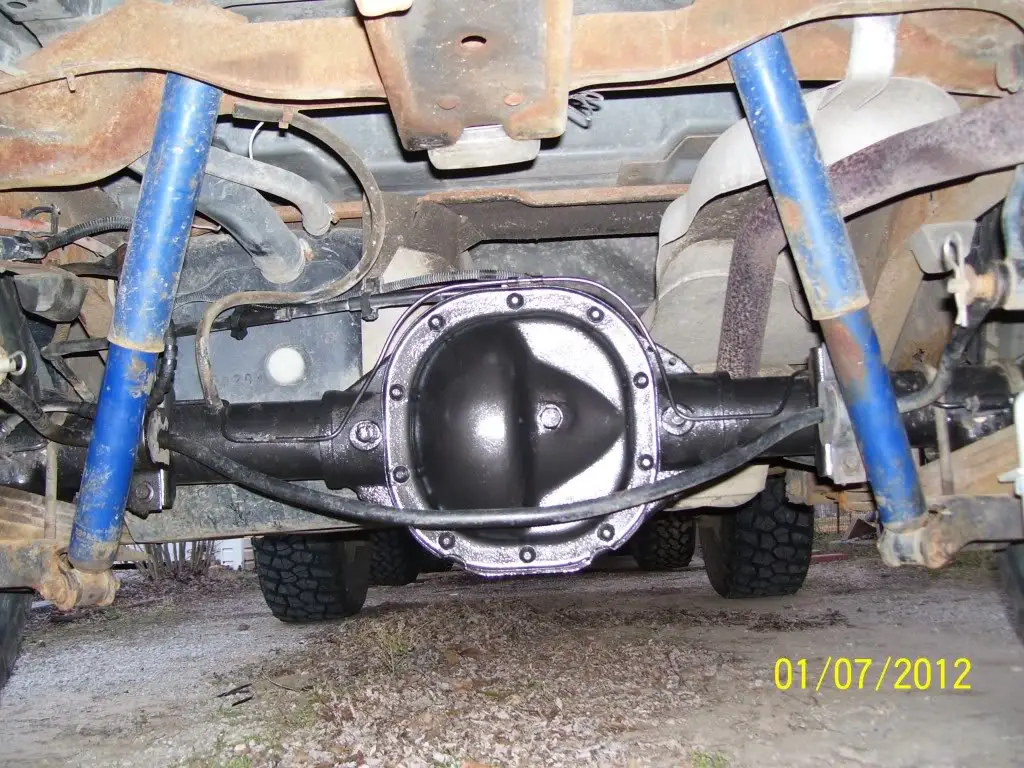

Got it painted, and ready for install tomorrow. :bounce:
I picked up the hardware for the E-brake cable mod as well. Used a Fel-Pro gasket & Ultra Black RTV, let it set up & filled it with 75-140 Synthetic blend.
Another 60* day ahead, so I am taking full advantage of it, and getting this thing installed!

Got the 2nd gen 4.10 disc axle installed yesterday.
Finished up the little stuff today. Got the E-brake hooked up, but it needs a little tweaking. Getting the cable the correct length when adding a turnbuckle to it takes some patience. Will get it 100% tomorrow. Needs to be shortened and a wedge dealy installed. It is tight, but it is maxed out.
Had to change the speedo VSS gear as it was 10 mph off. Went from a 16 tooth to a 19 tooth. Glad I have a bunch of those gears laying around! The stock frame mount works just fine, I dont know what all the talk about was for this mod, but there was no change in the 94 bracket from the 2nd gens bracket.

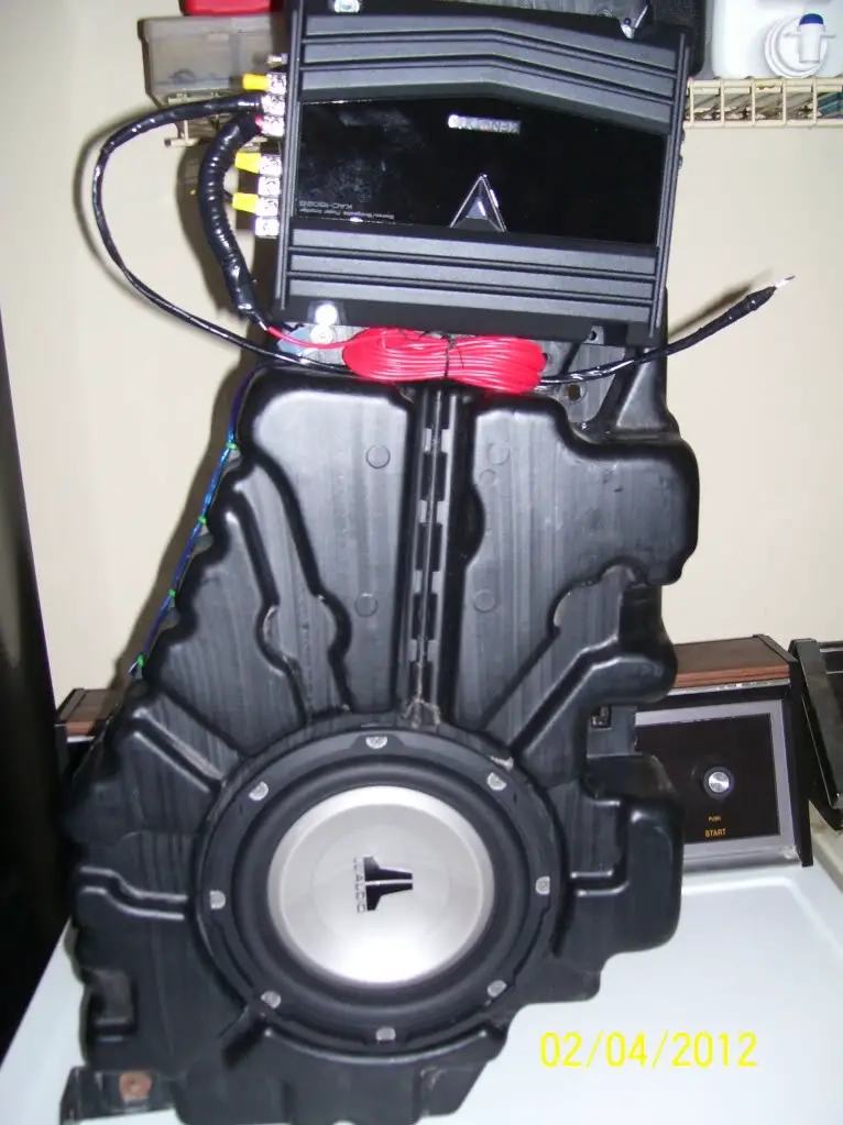

Since it got a new dvd/cd player, new speakers in all doors, the sound has never been better but, it was still lacking a little something. So the decision to install this was made since this rig sees the most time on the road. I think the Black Hole will be ok with this, since this was going to be installed in it originally.
Brand spanking new JL Audio 8" subwoofer powered by a brand new Kenwood amp in a 2000 sub enclosure.
Used some self tapping screws to mount the amp. Drilled some holes in the casing lips that protrude from the molding proscess, zip tied the 18 ga wires to the holes to keep it tucked up and safe. Used a wire clip to take up the slack and leave a little slack at the same time on the face side of the enclosure.
Its wired up for the most part, just need to install it, and run the power, remote power, ground it, and RCA's. I made a nice ground cable out of 3 sections of 16 ga with a ring terminal to attach to the chassis.
Now the deal with this subwoofer is that it was about 1/4" too deep from the massive magnet on it. Would not sit flush to bolt it to the enclosure opening because it was hitting the backside. So this sub comes with a plastic ring that goes on the face side around the speaker, and the bolt holes line up with the holes on the speaker cage. Removed it, and ran it under the speaker for a nice tight shim. It seals all the way around the speaker and the screws that hold the speaker on, also go thru the holes on the ring. Nice & tight fit. :)
Here you can see the sub raised by the ring shim.
I didn't have the power wire/100amp fuse, to run to the battery yet, so as soon as I get it, it will be installed.
