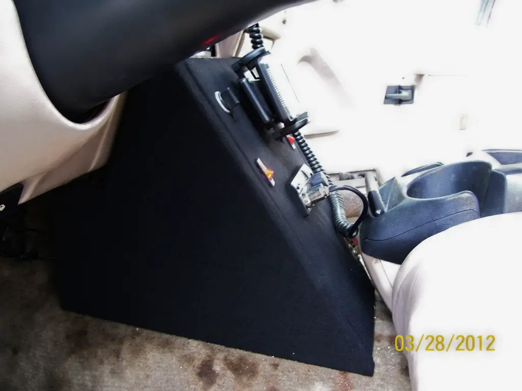

Since I had all this stuff added and was running out of room to put anything, I decided to make a console for it. I seen how Froader did his, so I thought to copy it and put my own twist to it.
Front shot
Drivers side shot
Passenger shot of the twist I came up with. Used a set of self closing cabinet hinges so that I can easily open one side to work behind it, and so that it will come out without taking it apart.
Only thing I screwed up on was one switch came out lower than the other. IDK what the heck happened, but oh well, it works. I plan on having a leather side pocket deal used for TV remotes (armchair caddy) to hold loose items I need, such as pens and pad of paper, etc... Still have to pick that up.
The clear flexible tubing used to house the vid camera cables, ran on top of frame from firewall to bumper.
