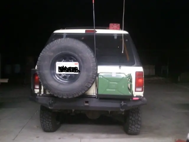

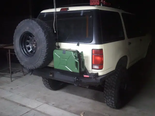

Finnally got my fuel can and cb antenna mounted on the tire carrier. I had a blitz can but could not stand how cheap and flimsy everthing was so i switch to the nato style can and solid mount.

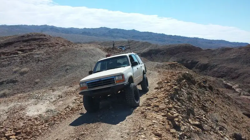

I traveled the Mojave Road last weekend. The trip was an absolute blast. We were out there for 3 days and 194 miles of dirt roads. A lot of history and wide open desert out there. We were unable to complete the last leg because soda dry lake was covered in water so we had to take the detour back to the highway

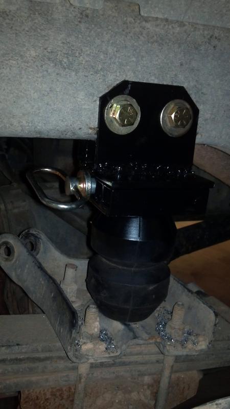

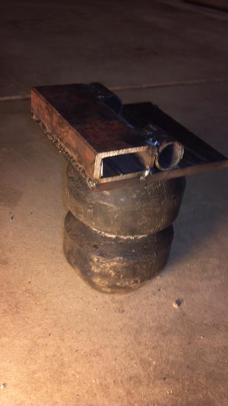

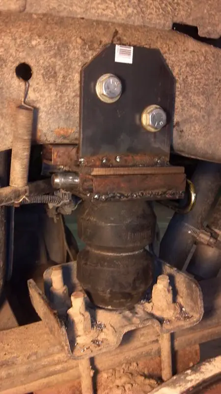

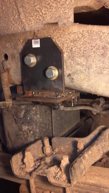

I have my removable Timbren mount done on the driver's side. It slides in and out easily. Hopefully this will be enough to beef up the rear when towing my tent trailer. I still need to clean the mount up and finish the pass side mount.

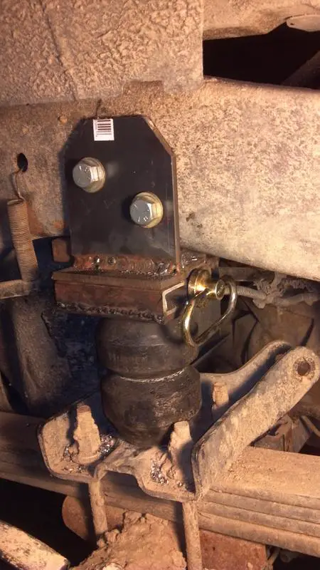

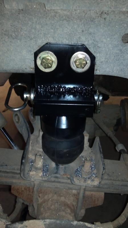

I finished the Timbren mounts in the rear. They slide in and out very easily and firm up the rear quite a bit. I drove the explorer around with the new sway bar and the timbrens installed and it is definitely way more stable. I wouldn't claim that it handles like a sports car but it definitely doesn't ride like a lifted truck. Now I need to hook up the tent trailer and see how it does towing.

I finally got my 9 inch drop hitch so I could try towing my trailer. I don't like having to use a hitch with that much drop but I don't have a choice because of the way I built the bumper. The explorer tows the trailer easily. The timbrens are touching the leafs with the explorer empty so when i hooked up the trailer the explorer only sagged a half inch. I drove down the freeway at 60mph without any problems so I am feeling confident. The ride may get a little more soft with camping gear loaded but it should still be fine.

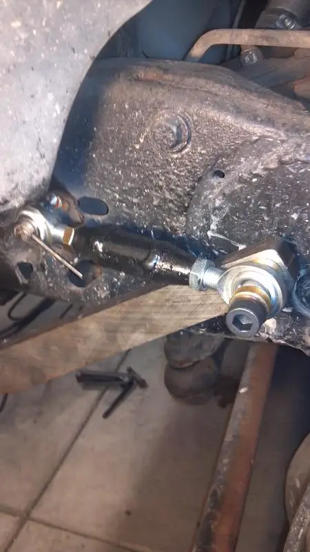

Finally done with school so I have some time to play with the explorer. After a few years with the old steering I upgraded to a super runner style steering. So far it seems to work great. Build thread http://www.explorerforum.com/forums/showthread.php?t=436333. I've been doing some maintenance and upgrades to get ready for what may turn out to be a great winter in the desert if El Nino kicks in.

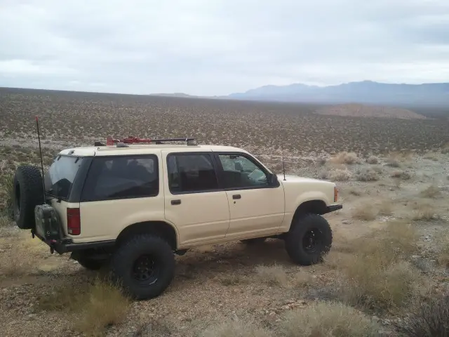

Had a great time for three days along the Bradshaw Trail. Found some great trails and mines! Explorer worked great and had no problems. I came across a great deal on a 10lb CO2 tank so bought a regulator off poly performance and grabbed the hose from my compressor. Works way faster than a 12v compressor! Finally put some miles on the steering upgrade and am very happy with it.
