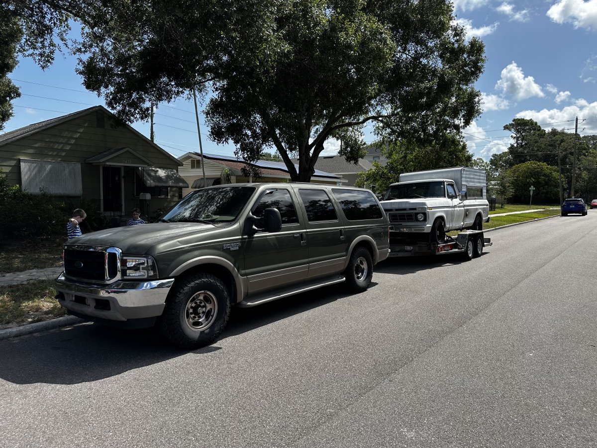

Here’s the excursion, just finished installing a single din head with a screen and a backup camera so when I show up to Uhaul tomorrow with the wrong ball and have to buy one at least I will be able to back up the the car trailer like I pro 😂.

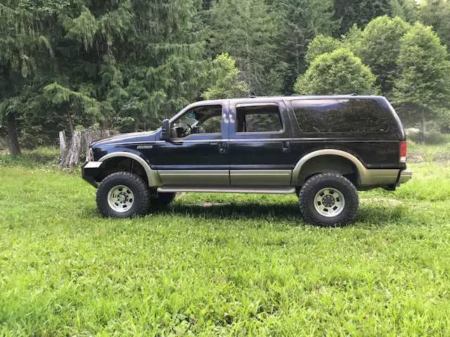

Want to see our excursion? I built it up for my family it has served us well! Tough as nails
They actually wheel pretty good with bigger tires

Well that was a hell of a drive, trailer was sketchy AF, couldn’t go over 55. Took 6 hours to get back through every type of weather even hail. Yeah cured drive. Truck did awesome though, apparently it likes to work. Hard shift went about after about 150 miles under load. Idk

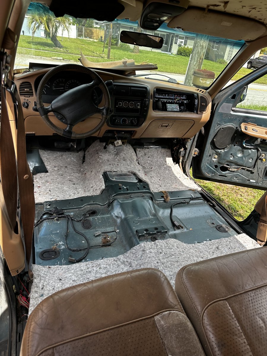

Anyway, relaxed the Sunday, had a few minutes after work today. Got the interior stripped back out of the ex and started figuring out insulation layout. Really tired of the flooring being on my pull-up bar.
This padding look correct to y’all? I’m gonna ad a layer of the self adhesive stiff on most of the floor under this and attach the padding to that with spry 77. Probably going to need to use a heat gun on the vinyl to get it perfect. Or let it sit in the FL sun for a couple days 😂

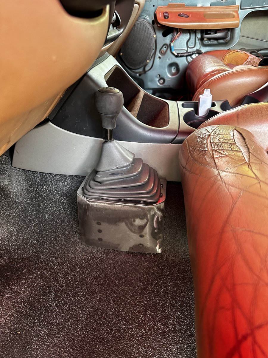

Got the floors all installed, not prefect, should have listened to @410Fortune about the sport flooring. The rock auto stuff works, but it’s not great. Oh well whatever.
Everthing is back in the cab, still need new seats/rails of some kind.

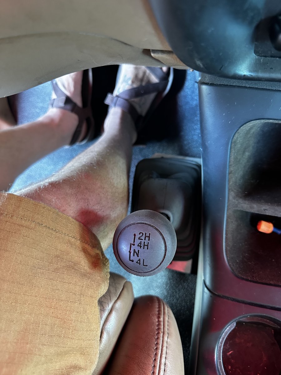

Got the shift boot holder thing fabricobbled, installed, and working wonderfully! Now I just have to pull it back apart, paint, and insulate it.
