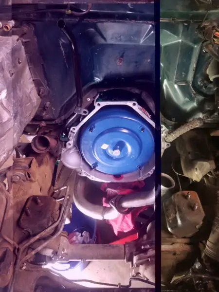

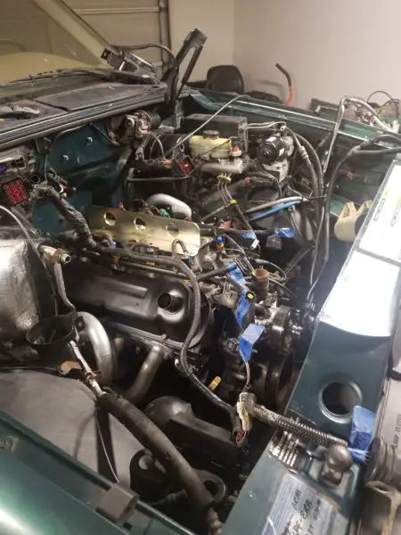

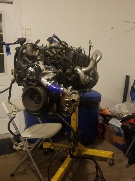

Got my transmission installed and torque converter filled and mounted, gonna try to get the motor installes this coming weekend, and then start trying to fit the 4406. Things are getting pretty close to being finished but still a lot of work to be done.
Looking good but are you sure those valve covers will clear those rocker arms?
Your project looks awesome!! Keep it up and thanks for sharing
I agree probably need different valve covers
The explorer covers might clear if you remove all the baffles and some material from a couple of rockers
I would rather use diff covers!!
These work well on explorer:
79-93 Mustang 302 valve covers polished aluminum | eBay
Also I have used these with a little modification to oil fill AND intake spacer
SBF Ford 289 302 Fabricated Polished Aluminum Valve Covers Tall Mustang V8 5.0L | eBay

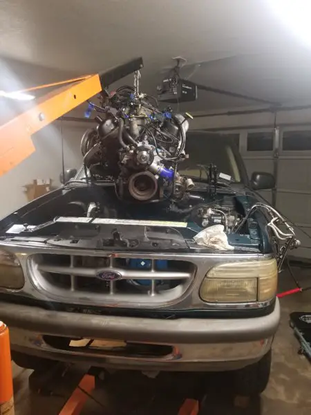

Got the spacer ordered. Got the motor sitting down on its mounts and mated to the transmission. Gonna need a little more work to get it completely bolted to the bellhousing, as one of the dowels in the block wont quite slide into its hole on the transmission but should go with a little persuasion. How much grease does the tail shaft on the trans need?
your spacer kit comes with two of the long bolts, you will need two more (4 total)....... can find them at Fastenall or good hardware stores
Tailhousing on the trans gets no grease just make sure its clean
Make sure you stab the converter properly!!
Awesome, thank you. The converter slid all they way in very easily and completely seated. I should be able to come up with the bolts at work and if not there's a fastenal in town. I have a 3 day weekend starting tomorrow so I can hopefully make some progress.
