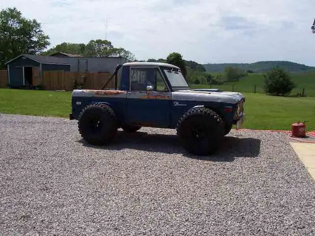

today i got the front set up. it is now almost done. the rear gears will be done this week and then the full width axle can go in the rear. the front is now at the height i want it to be. i corrected the angle of the front pinion by flipping the bushings over and it corrected it up to a great spot. (it didnt have directions and i put them in the wrong way) lol. i am hoping to finish the rear tomm to get it sitting a full height. then i will swap to full width in the rear next sat if possible. i still have the task of getting it out of the garage now that it is so tall.
almost done
well the weekend was full of work. we tore it all down and put it all back together. drilled a few holes and now it is at full height.
i had two of the tires mounted today a school in hopes to have the rest on by the weekend.(including the nine inch)
i will still have to take care of the front rub. if i have to i will use a two inch body lift to get it to miss the fenders. i am cutting them a bit more so that should take care of it.
Wow that thing is tall. Looks pretty good though, looking forward to seeing the finished product.
BTW, do you plan on painting it?
yeah it is pretty tall i love it. im not sure what the size will be when i get the 36s on there. however i want to paint it and i have decided on flat black and orange accents.

well i think it has been a heck of a lot of work that was worth every hour.
also the rear end gears are set up and ready to install. the chunk is still out of the 9" but i think it is goin in tomm. the rear end might get put in this weekend and it might just see 36s
It looks great. I think it turned out the perfect height. Nice job on it.
