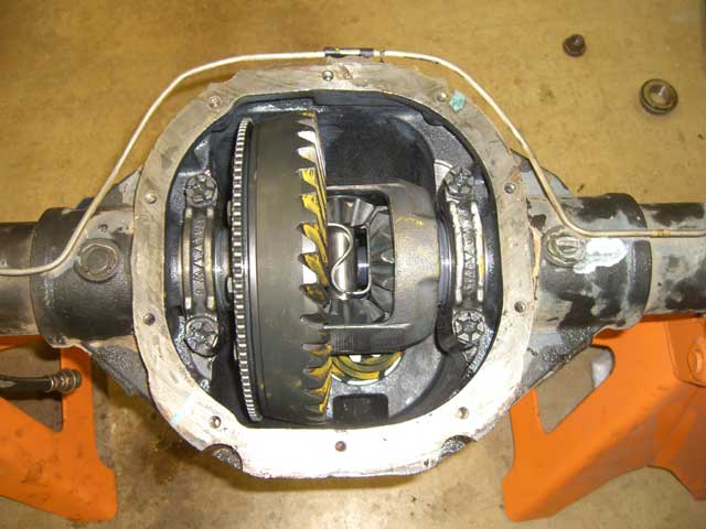

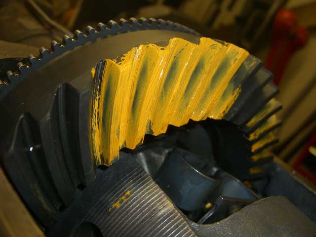

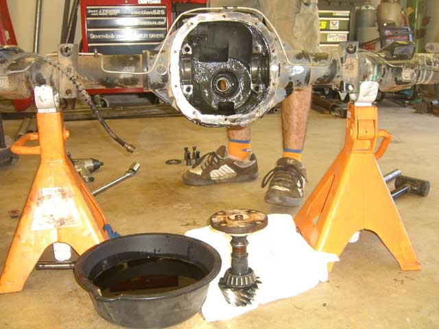

Well we decided to go ahead and learn to install gears tonight. :p:
Took us a while, but we went slow and took our time. The front will probably be a little faster. Anyway, so the 4.88s and LS are in and on the road. :cool: Everything is so far so good.
I ordered a spring kit for the front Detroit (which came today, thank you FROADER), so it looks like we'll be installing that this weekend. :thumbsup: I'll be in the hills by Sunday. :D
On to the pics!

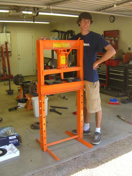

Can't forget about new tools!

P.s. i think the gear marking compound stuff is a good color for me :)
nice football shaped pattern?
Its not that tricky afterall is it? :)
