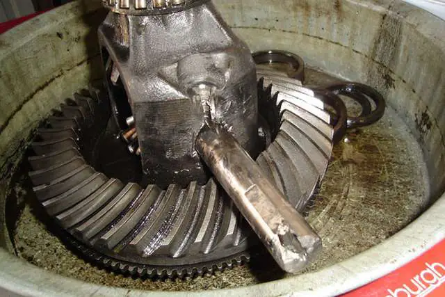

Well it was a long day of not getting much accomplished. :( Hit a couple places up for an open carrier. Finally ended up pulling one from the junk yard. Went good. Except for when we went to install the locker. It was the wrong size carrier (different cross pin width). Damn it. So, looks like we need to go hunting again.
Then we tore out the front axle. Starting working on the gears and locker for that. It's a lot of trial and error trying to get everything right when you don't have the old shims to sorta go off of. So we played with it till 12:30AM trying to get a pattern we like with the acceptable backlash. Decided to call it a night and try some more in the morning. :(

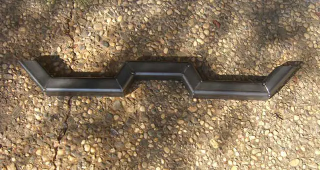

Here's the new tranny x-member so far:

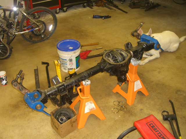

Front gears and locker are now in. The axles have new u-joints. Pretty much everything is ready to go back together now. We left it all apart so it'll be easier to move the axle under the truck. Which, we didn't do because I really want to build the new shackle hangers/x-member before throwing it back in. So tomorrow will be another fab day. :cool:
