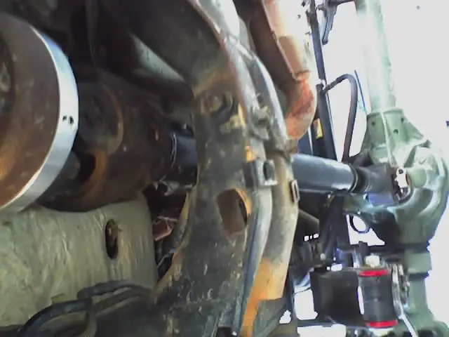

I should not need to anyway. On the 2nd gens, you just lose the torsion brackets. they are in the same place but are seperate.
you can see here from 034x4's truck. (turn head to left :rolleyes: ) you can see the trans mount is still there, but also see the hole where the T-bar use to go through.
