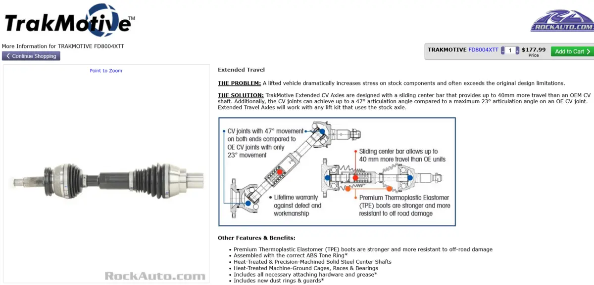

Seen these today. They give 47* angle (stock is 23*), and a slip joint that gives 40mm of extended length, during articulation. 🤔

Wow that looks sweet.
hmmmmmmmmmmmmmmmmmmmmmmmmmmmmmmmmmmmmmmmmm
I like! Slip yoke cv axle
I wonder how much width it can handle (40mm!!) that is quite a bit
I wonder if it can be modified for more.........
I need measures of the shafts on them, to see if they will clear my coils. If they do, I will give them a try. Breaking 2 dr side axles, 2 days in a row last year in moab made me buy shorter limit straps, and change lower mount locations. Would love to increase travel, and not lose it, by doing that. Lol
I like that too, more options are great. Let us know if you think they are an improvement, I'd like to find something reasonable above the low end stuff.
Thanks Greg, now there's something else I need to spend $350 on.... hehehe. Seriously, they look great. May have to get a set myself, just for increased durability

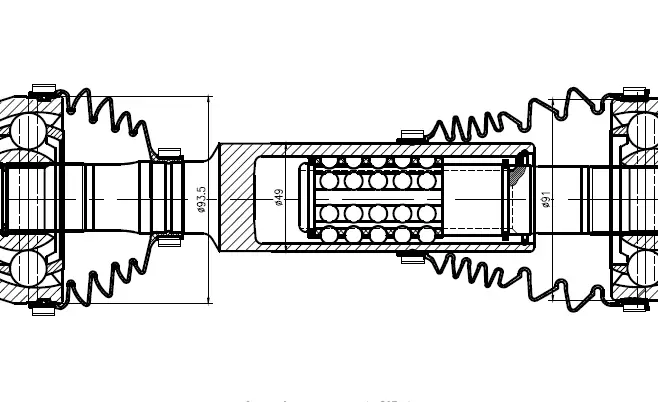

Well..... Trackmotive got back to me this morning with the CV measure for the slip joint. It's 49mm on the inner shaft.
I haven't yet had the chance to see if it will clear or not. More than likely I will have to buy a set and just try them to see how the slip clears upon articulation travels.
The slip looks to not be spline, but ball bearing.

The Stock CV center shaft is 1.125" wide. Those slip shaft CV's have a 1.93" wide shaft.
