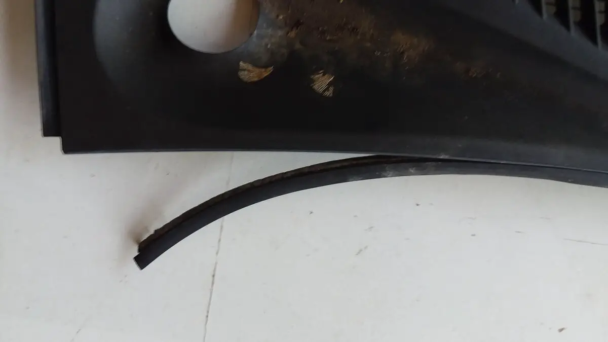

Went to the salvage yard for Misc stuff, and grabbed a new set of cowl trims. The rubber glass seal on one side had come unglued a bit, and curled up the window. Drove me nuts to see that, so....

Cleaned them up, and shot them with a few coats of clear. Very wet in the pic below.
cleaned and painted the wiper arms too.
Ahhh...... Much better now.

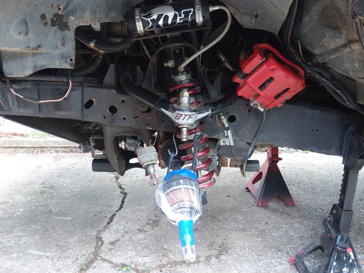

Well this morning I decided to get a headache job started, knowing I couldn't finish it by end of day. Put the front on stands, and removed the Dr side LCA, to install the new bushings, and ball joint. Wrapped the CV end because we have a weeks worth of rain starting in the morning. I really dislike leaving the rig on stands that long, but it is what it is.

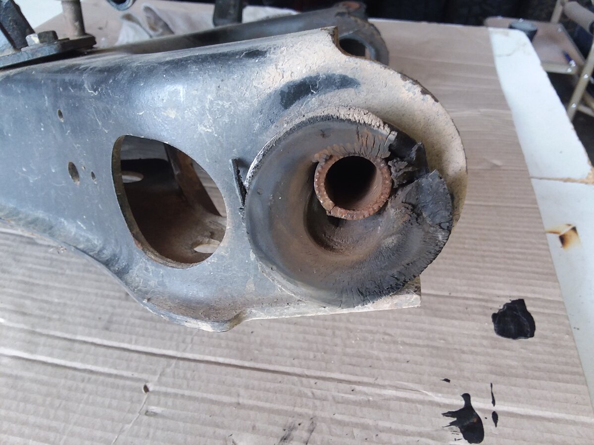

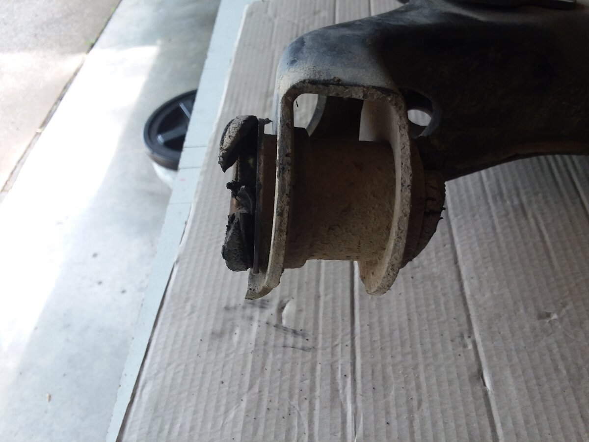

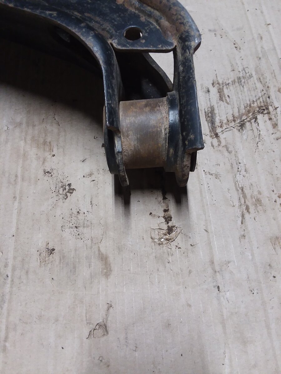

Ball joint came out easily with the BJ clamp. Front bushing was half way out, and was able to remove it by hand. OOOF! The rear bushing is where it got fugly.
The rubber bushing was destroyed.
When the BJ clamp was used, it just pushed the bolt sleeve out (was a little fight). I tried again using a socket to push the bushing out. Nope, just got the rubber out, and the bushing is frozen in place. I gave up trying to push the casing out. I'm just going to have to cut it out, a bit at a time.

Front side is good to go.
Will work on this arm when I can this coming week, and hopefully get it back on next Sunday. Then start the other side. Yep, a month of Sundays, for 4 new bushings, and 2 new BJ's. LOL
OK, now this had me thinking as to why these failed. Is it because they are just old, and they failed like normal after 27 years of use, OR was it old age, and the pressures created by 12 years of coil lift forces? These Coilovers are not straight, they angle to the rear at the bottoms. I use a longer than intended coil for lift reasons. Lots and lots of tension like that. Dunno, but if I get another 12 years, I'm good with it. Best part is I found the mystery clunk!
Make sure they are torqued after the vehicle is sitting at ride height, otherwise the bushings can tear!!
We have used a torch in the past to get the old bushings out… but I hate that smell and the mess
I will torque for sure.
Rubber is out, just the bushing casing remains.
I had an idea this morning. Might weld in a round pc of flat stock inside it. Then attack it again with the ball joint clamp.
Another thought was I'm sure hitting rocks while wheeling, stopping the rig dead in its tracks helped cause pushing the arm back. So now I'm thinking of welding on some type of roll over assist skids to them.
I used a hacksaw
I put the blade through the eye then put it back on my hacksaw
Worked great
I like Donald's idea. Once you get a groove cut the sleeve will collapse. Glad you are getting it done! That bushing hung in there for a good while though

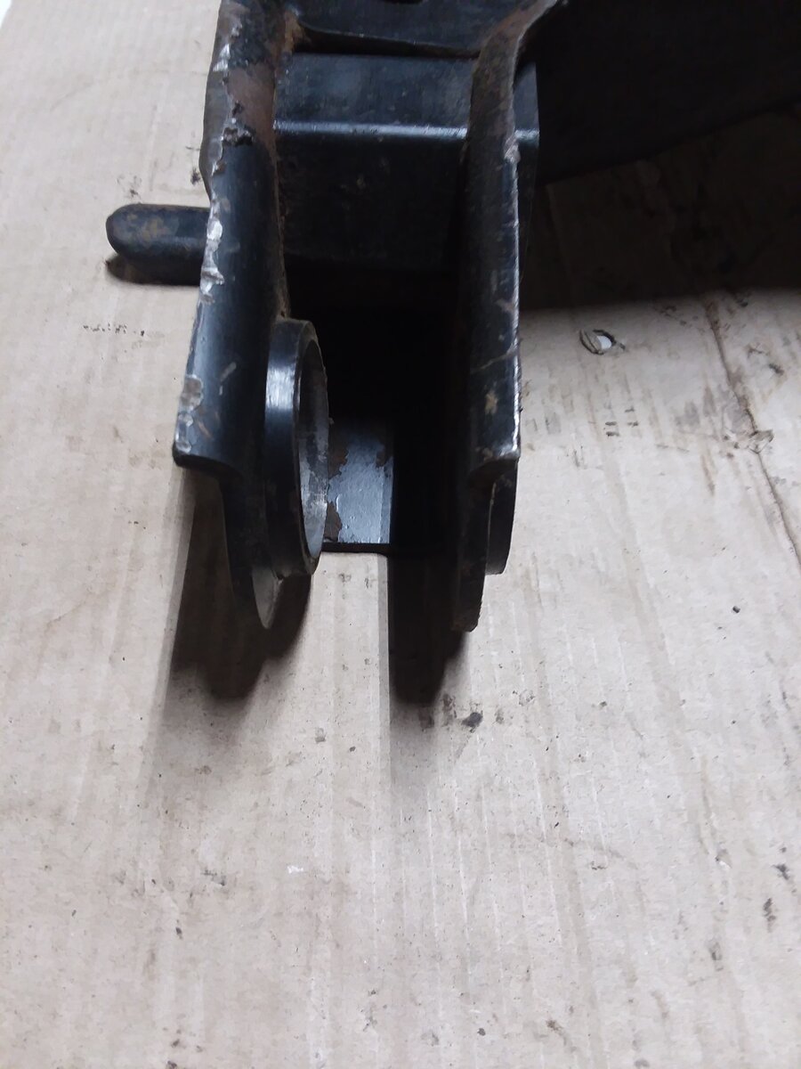

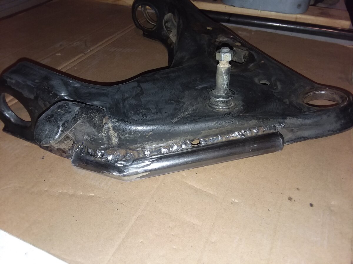

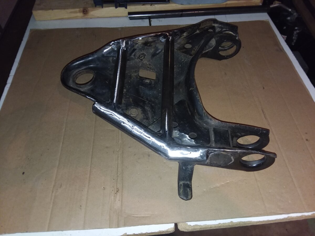

I ran with my idea for skids on the LCA's. I seen why adding plate to these was a nightmare. The front and back walls are different heights, they're angled, and tapered differently. Nothing symmetrical about them!
So.... I had about 16 LF of schedule 80 1" pipe, and put it to use.
The whole point of this mod, is to simply get the front edge to go up and over rocks, Then slide over without catching the back lip or turtle on top.
I got one side welded up tonight. Tomorrow is paint and rebuild.
I have 4 bolts to get nuts on for the coil over brackets, and then the limit strap stud nut underneath. With this setup, all of them are easy to get too.
Can only go so far outward on these as the knuckle swings and bumps them near the LBJ. Inward is the hex hole that extrudes.
A thorough cleaning in the morning, and air dry until lunch, then paint. Should be good to install the BJ, and Bushings after work. I'm happy with it.
