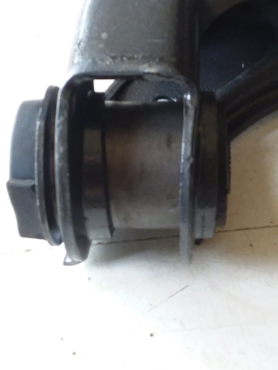

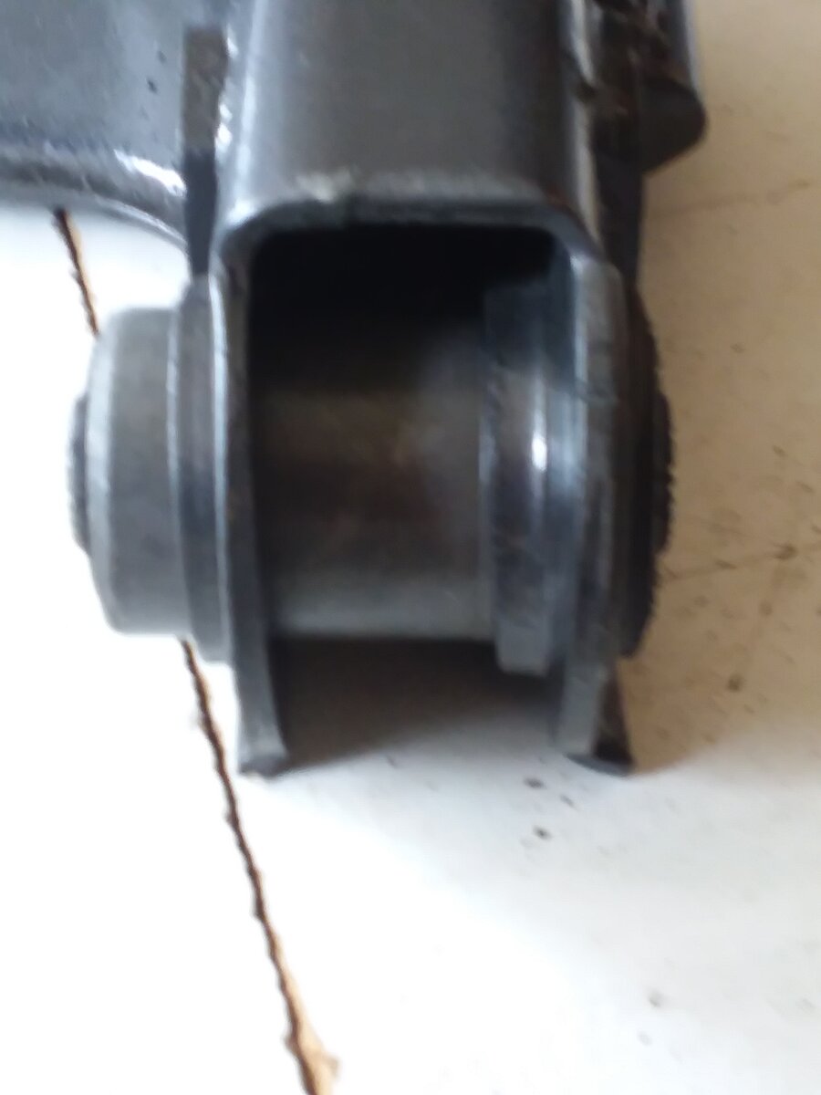

Have a concern tho. No matter what I did, I couldn't get the rear bushing fully seated. Even the Earthquake impact wouldn't press it in any further. I thought the Ball joint clamp was going to break in half I was putting so much force to it. I even used a 5 lb maul, and brought the thunder on it. Nope, not moving. I filed off the new paint to raw steel inside the holes too. Used some lube as well. WTH man! I checked the old bushing pics, and it's about the same.
I measured the gap on the frame to check the width, and then test fitted it. It's snug, but it will go on with a couple love taps. I'm just not sure if this is going to Chooch or not. To me, it should go all the way in, and sit flush with the arm. Should I let it ride, and install it, or should I take it in somewhere and ask to have it pressed on better?
What say you guys?

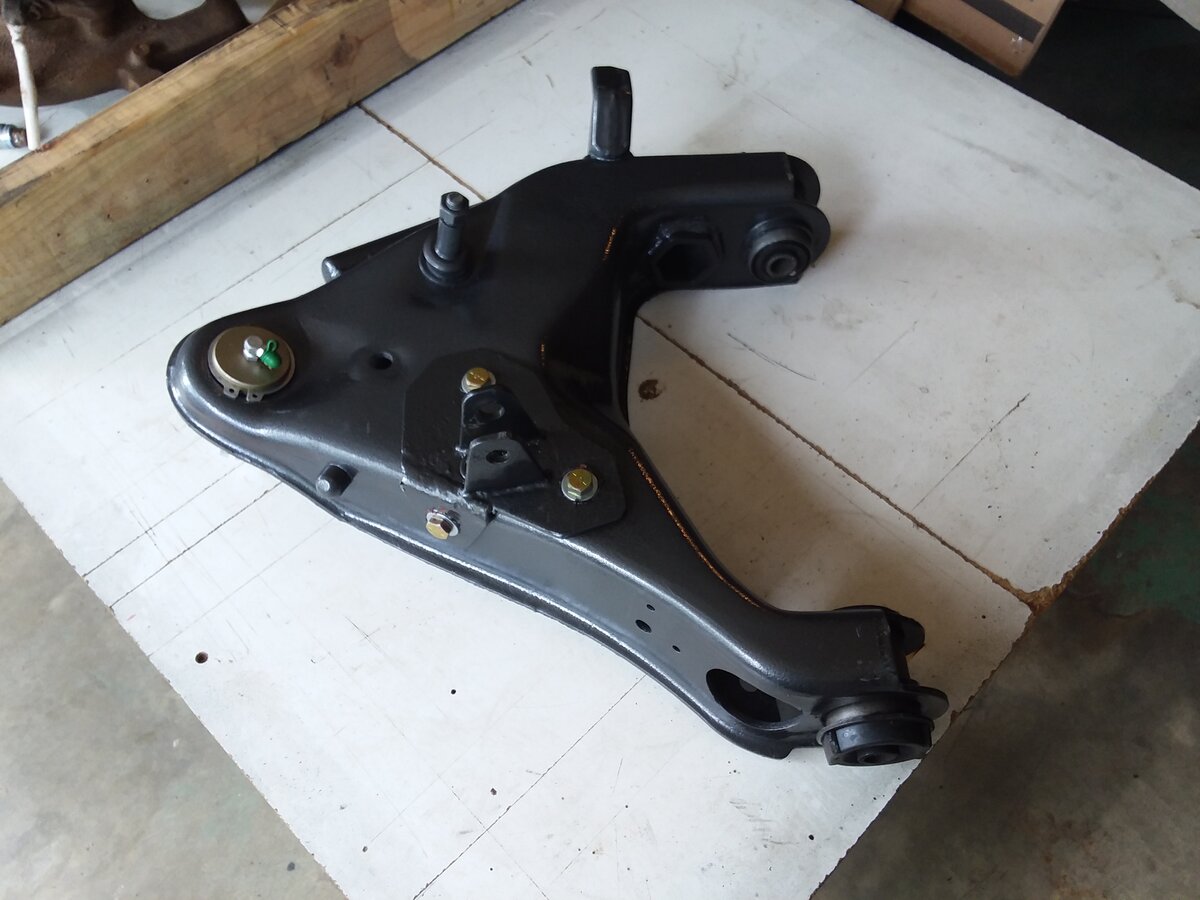

New stuffs, and you can see the gap on that rear bushing better. Kind of concerned about it, but also not that much because the old one was froze solid, in about the same spot. Head scratcher!! What to do, what to do?

I like the reinforcers and mini "sliders" you put in there. I'm definitely going to have to copy that when next I have the LCAs out.

That LCA bushing should be fine, I have noticed that before on several that I have installed. I also recalled worrying about that when I had my old 91 Lincoln LCA's re-bushed. I paid to have them and the BJ installed($50), I stopped doing CA bushings in the 80's.
I did a set for my 72 Gran Torino at work using their strong press, and the proper safety tools, including a large pipe placed underneath to catch the old bushing. The catch pipe had a small hole cut into it so you could reach in with a hand to remove the parts or bits. Anyway, one of the bushings came out so hard and fast it bounced around in the catch pocket(pipe), and it flew out the hole at high speed. It didn't hit me, but it was a blur going by. I decided that's a dangerous enough task to pay to get it done, or buy new CA's if possible.

I used a bigger Hammer and got that rear bushing set further in. Putting it back on was a fight that lasted a few hours. had to use the Jaws of life on the ears, a pry bar, and the kitchen sink, but it's back on, and buttoned back up. One side done! LOL

Good job on the control arms and bushings, I wouldn't even attempt that.

Thanks for the kudos! It was a job, with all the extra doo dads associated with them. I set the coils exactly where they was before I removed them from the arms. Hoping the alignment is still good. Test will be over the weekend to see how I did.
