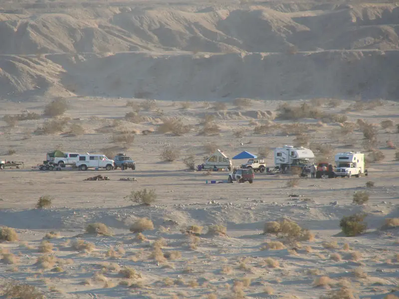

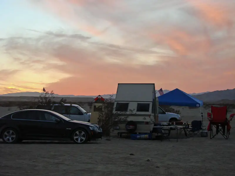

..With all the camera's that were taking pictures around camp, I'm surprised no picture have been posted of the potluck, the 3 foxes who kept raiding camp from all sides, the real fire, or even the big chair..:popcorn:
..Anyone have a carnage report to share on all of the vehicles?
Ok Ted, Here is the photo of Adam's car at camp (For all of you who think your vehicles couldn't make it to camp) and his really BIG chair. The little foxes were too fast and no photos of the potluck although I did get a photo with Chris and you can see the steaks Chris was cooking for my Birthday dinner.

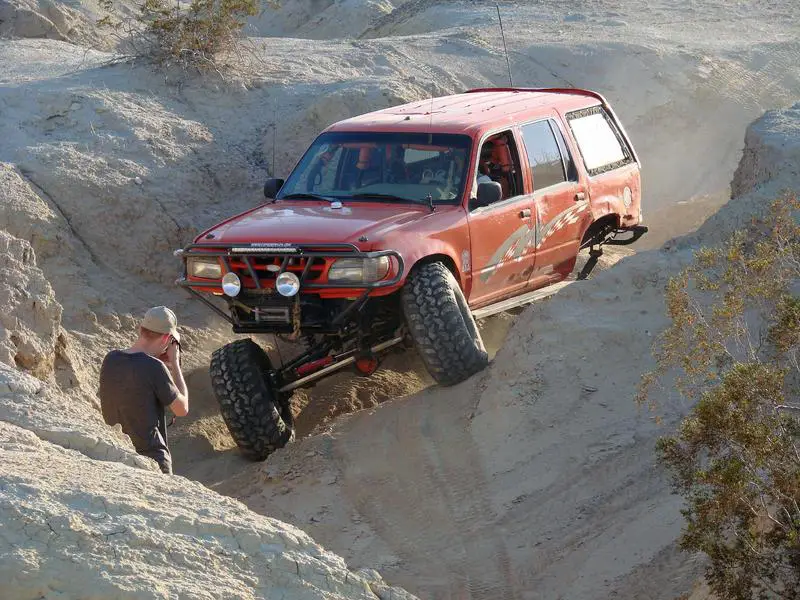

Trip was great, weather couldn't have been better. Just one stuck, just not enough clearance or speed to get over the peak. Photo of me climbing out the window on my second try. Thanks DB-1 for the pull backs, twice. Made it over on the third try. Found out later that I had bent the skid plate under the transfer case on that one. It was rubbing and had to pry out some before the drive home.
Love the photo of the front suspension on the Pumpkin. Chris got some great close up shots.

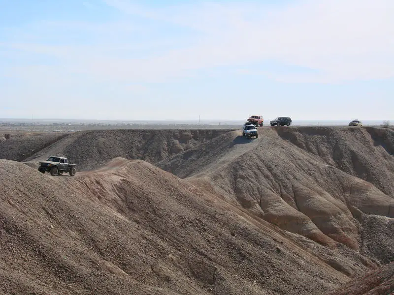

Also is a shot of the group coming along the ridge on the way out.
