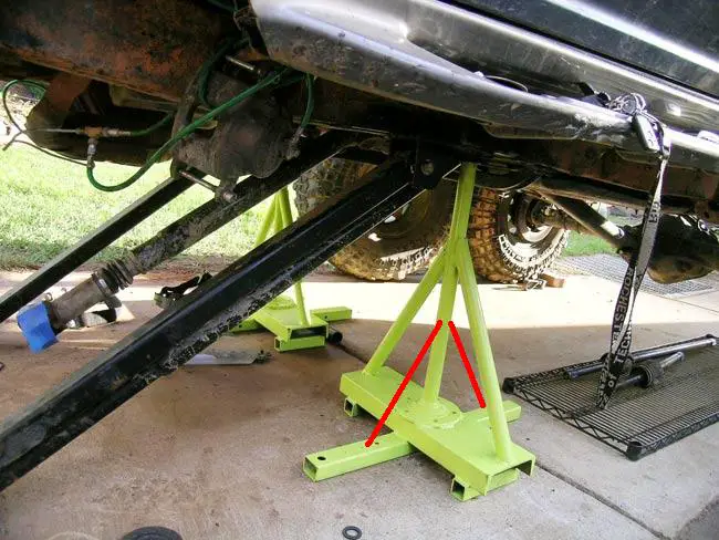

The Riddler made me a pair of jackstands :rolleyes:
Maybe toss in some support so they dont fold forward or rearward. They look cool but a little dangerous
Sweetness, but needs this really bad-
Agreed! :thumbsup:
