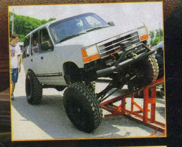

Some new info other than the broken tcase is that my explorer is in sport truck mag. it was when i was a slammin and jammin. its a nice size pic. im excited even though it was not in a 4x4 mag.
