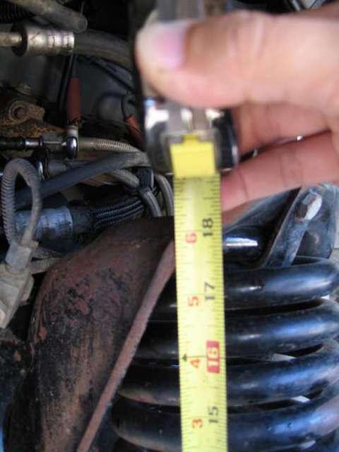

It tells me exactly how much the front end weight of a 1st gen Explorer squarshes a set of wild horse 5.5 inch coils.
Ummm... mine is 18" with those coils an I know Stic-o's is 18" as well...
the bumper is a ton of weigh. its built like a tank. when i had my accident it only bent one bracket and a few scratches. hit a truck at 45.
i just straightned the wheels up perfect and got 16.8 or so. i always wondered if i had been sent the right coils.
Thanks guys, 17 might be a good target, 2 inch difference is alot, guess I`ll ponder this some more before I cast any one measurement in stone. Anyway, don`t wanna hijack the thread or nuthin`.
I am going to check into this more i need to work on the front axle anyway so ill have a for sure number in a bit. i may have just made a mistake.

the ride height of the back of the truck will also effect the weight over the front end and coil height, plus not every 5.5 coil spring they make will have the exact same spring rate, it vareies a bit from spring to spring.
Just my guesses why the differences
