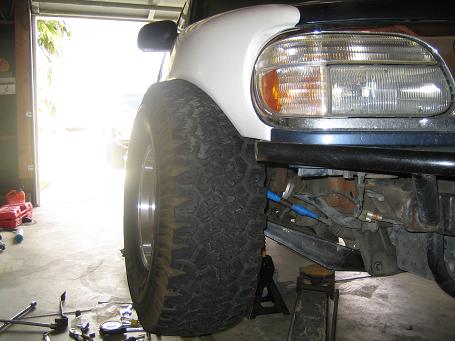

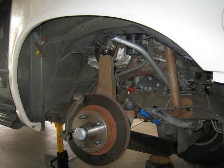

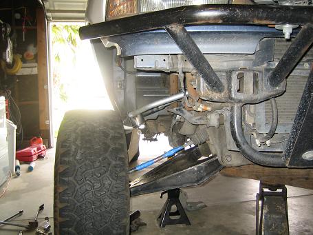

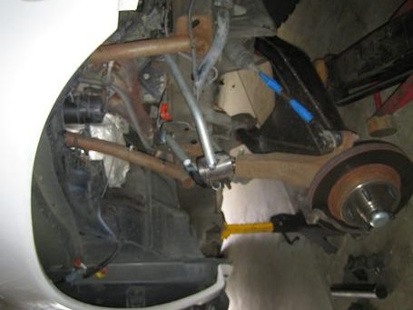

mock up pics. going to have to trim the fender lip for clearance. will fully cycle like 17ish, will be strapped/bumped abour 15ish.

with the tire, bump clearance will be tough to fit, but it will work :thumbsup:

That looks so much wider then 4.5" more then stock. Definately gonna need a beefed up tie rod with that kind of length. If you got some wheels with less backspacing would they tuck into the fenders better or would it cause clearance issues elsewhere?
it came out to about 5'' over actually. that is pretty much at full bump, so i think if i trim a bit off the bottom of the fender it will be ok. i am going to look for some other wheels, but im not sure if with the lift spindle i can run less Backspace or not. i have to check it out. i dont mind the width, as long as i can get it to bump 100% without problems.
lookin gooooood, looks like it will actually work better with that taller spindle too
