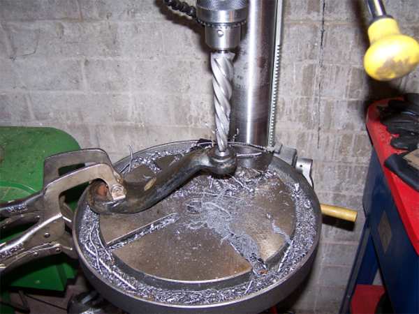

Anyway here are a few pics. First is reaming out the pitman arm to fit the larger chevy TRE. The second is the steering angles wit weight on the springs. I think they turned out pretty well :D

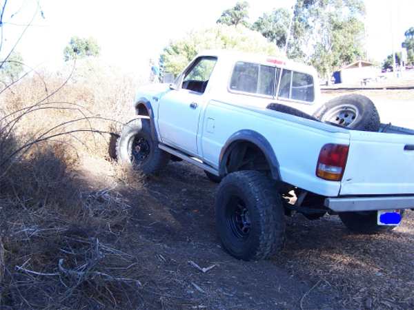

It turned out a little higher then I wanted. I will probably get an add-a-leaf and put it in the back to help level it out. I also went hunting for some sort of a ramp and this is the best I could find close by. Hopefully I will have better flex shots when I get a chance to take it out wheeling.
