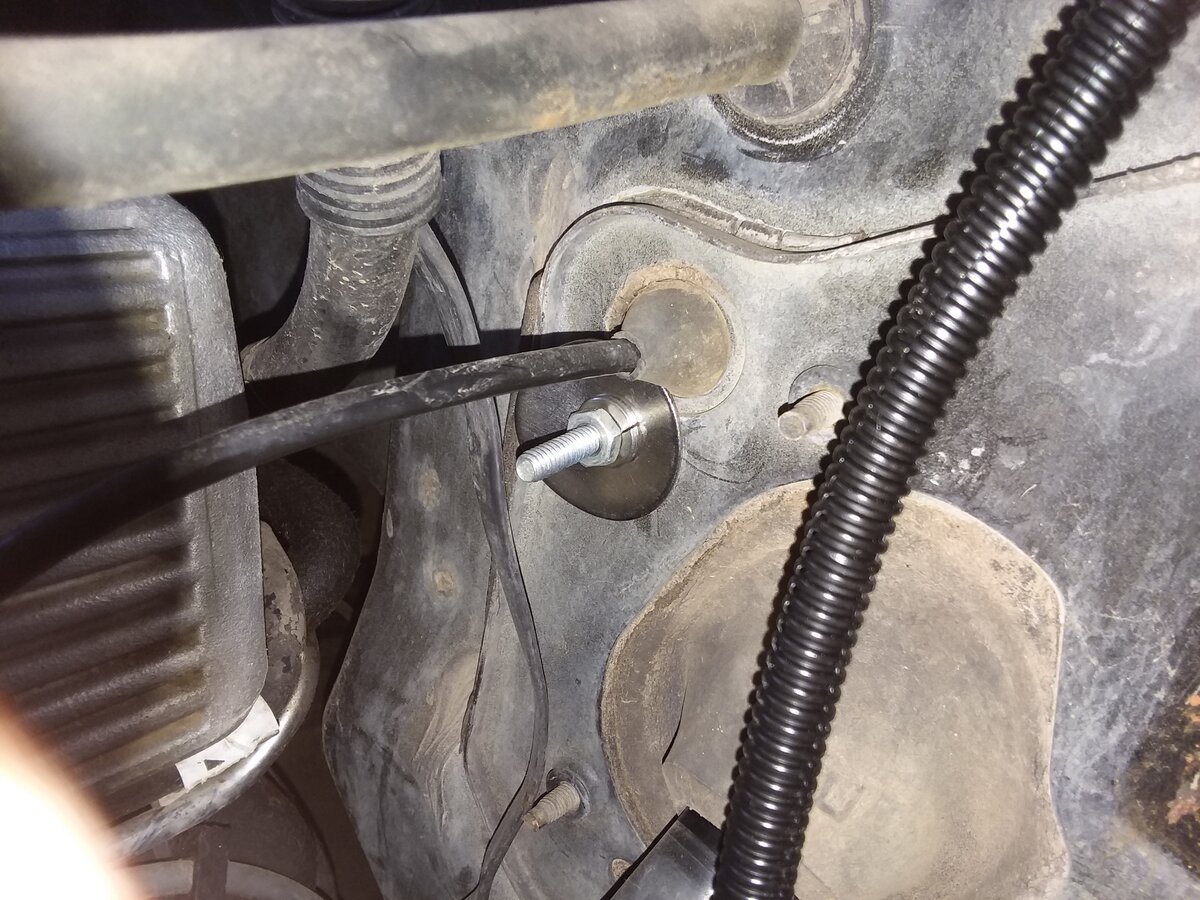

Got the old 5.0 Used POS booster out. Installed a bolt/washer in the firewall.

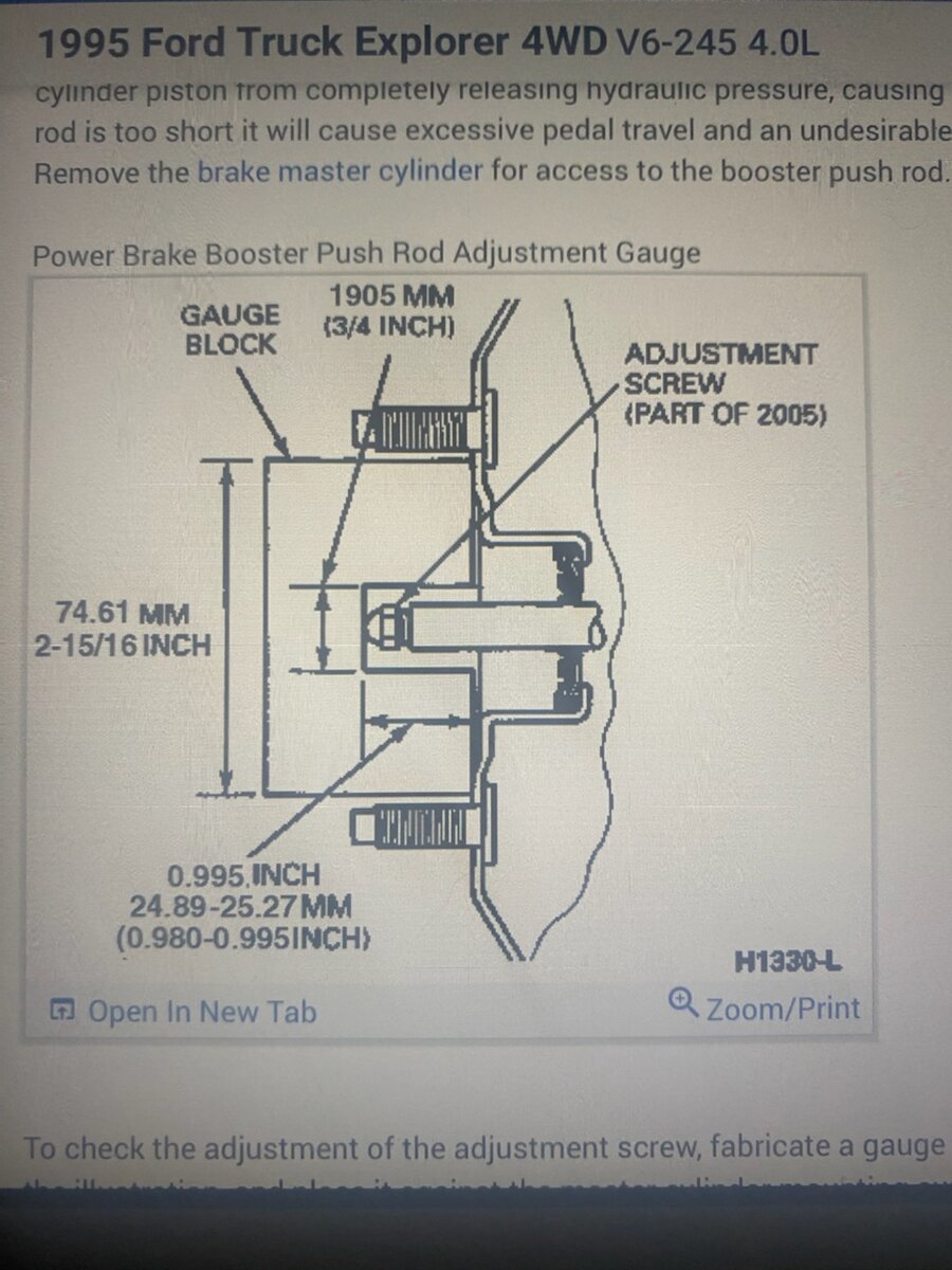

Buddy who helped bleed had access to AllData, and found the stock specs for the pushrod on the 2nd gens. Same data for the 4.0 & the 5.0, doesn't matter, all the same measure. He checked them all.
I didn't have a way to measure the 0.020" gap needed between the rod and the inside wall of the cylinder. I just did the rod adjustement by what AllData called for. Used the digital calipers to measure the length, and transfered it to a block of wood. Set the pushrod on the bench, then installed it. Buttoned up the interior (seat out, brake pedal), and left the master off. Started the engine, and checked the measure on the rod. It didn't move. All good.
I didn't take a picture of the new booster measure, but here is the old 5.0 booster, showing the measure. I did have to move it to get it to the line seen.

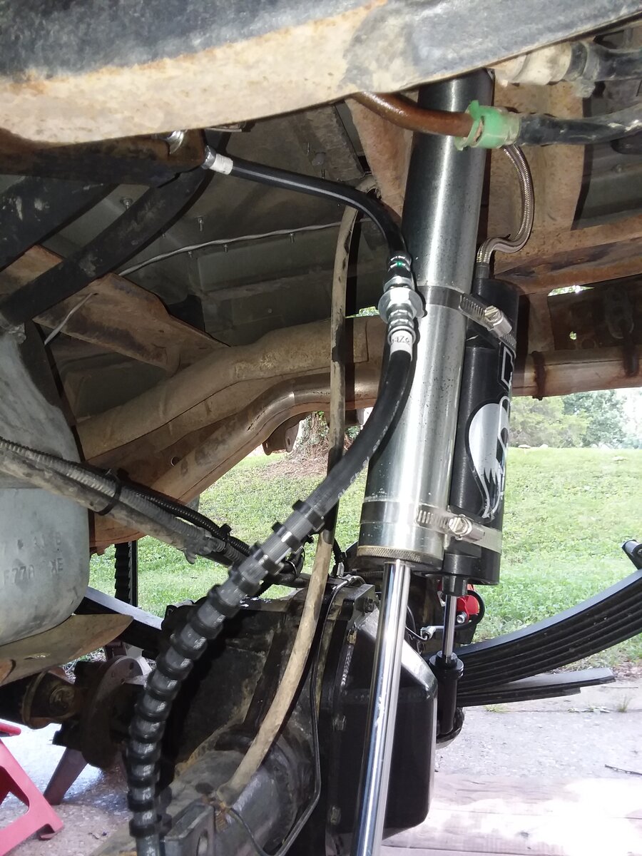

And the Napa 10" extension soft line (Thanks RockRanger for the P#) I moved it away from the shock later on.
