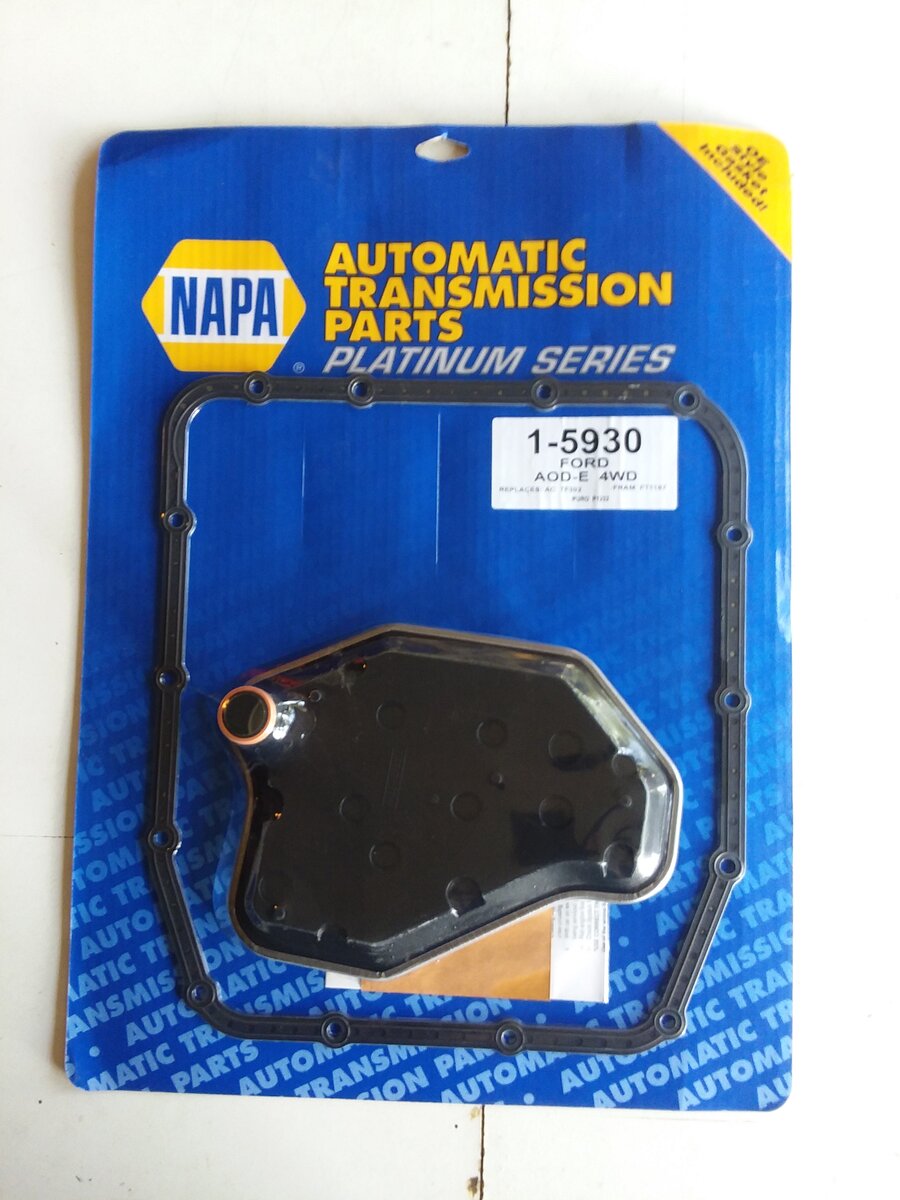

6 quarts of Merc V enough for a pan drop, filter change?
Yes, that's just about enough. Before you pull the filter bolts, have the new filter ready to go on. More ATF will drain when the filter is dropped, but it's slow and steady. Have the new gasket wet with ATF and in place on the filter, then drop the old filter and immediately install the new one and the bolts.
