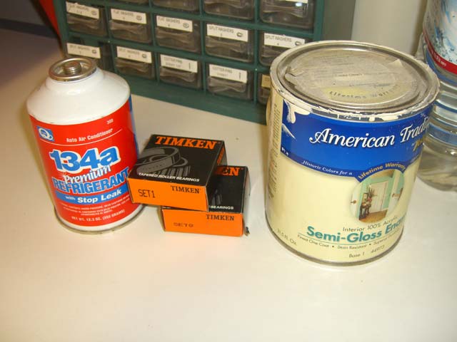

I have a 1979 Bronco steering box (with rebuild kit), one can of 134a, some bearings for a VW Jetta rear wheel, and a can of semi-gloss interior paint. I just need your address.

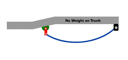

Here you go, G! :thumbsup:

I don't think you need new springs. You just need to move the shackle hanger back more. If the shackle is going horizontal then it's too far forward.
You're probably okay with the springs you have. Mine are pretty much flat from the weight of the truck. Although you do have two more springs... It's up to you.
