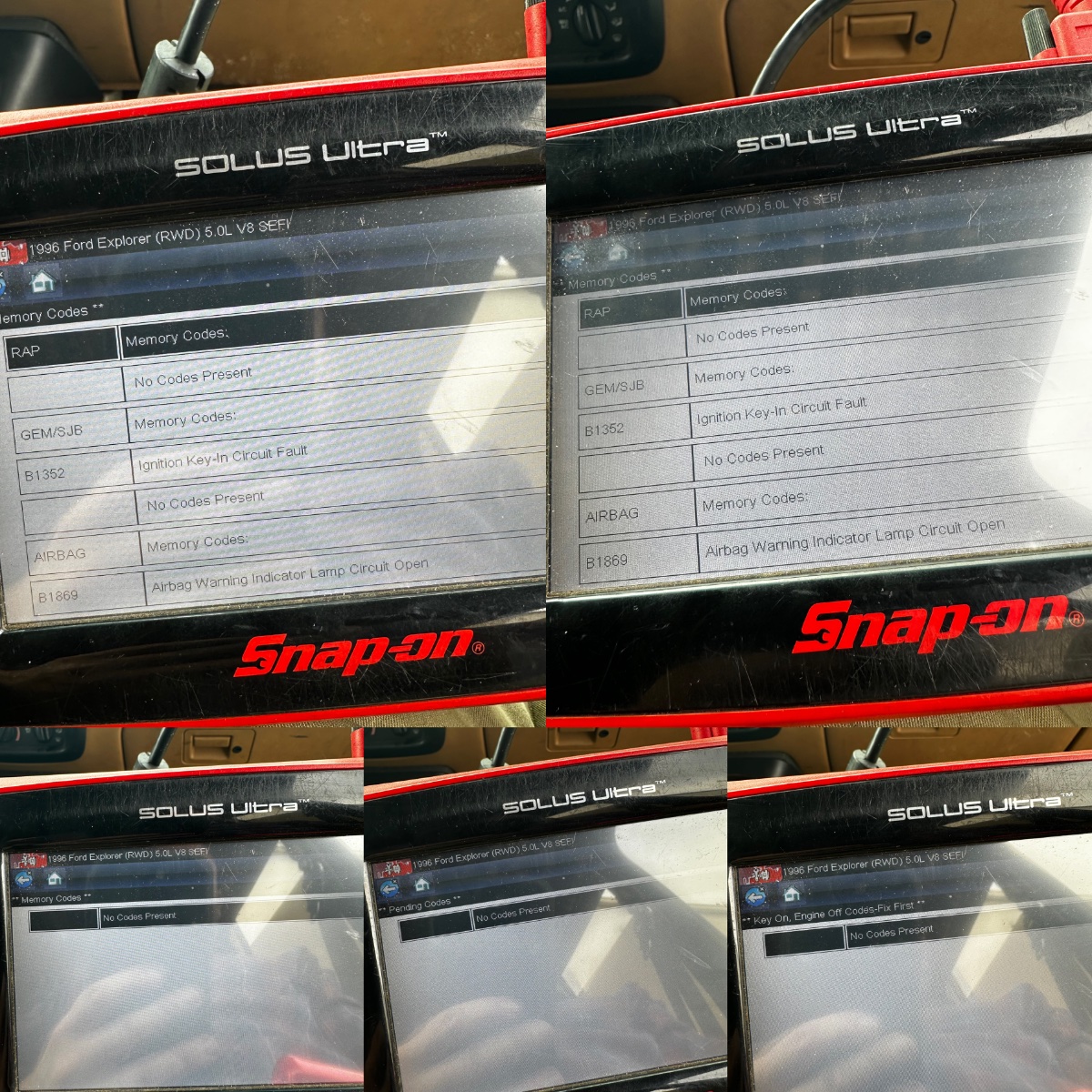

Drove it to work today, turns out I left the scanner in here. I took pics to prove I’m not crazy 😂 No codes. Other than airbag stuff. I do have a cruise control, not sure if it works. Be kinda cool if it did!
I think something weird is going on with the cluster maybe. Im going to switch that back asap and see what happens then. I also bumped up the ratio by +.2 to see what happens. I’ve got two more days of work then I’m off till next month so I’ll have lots of time to fiddle.

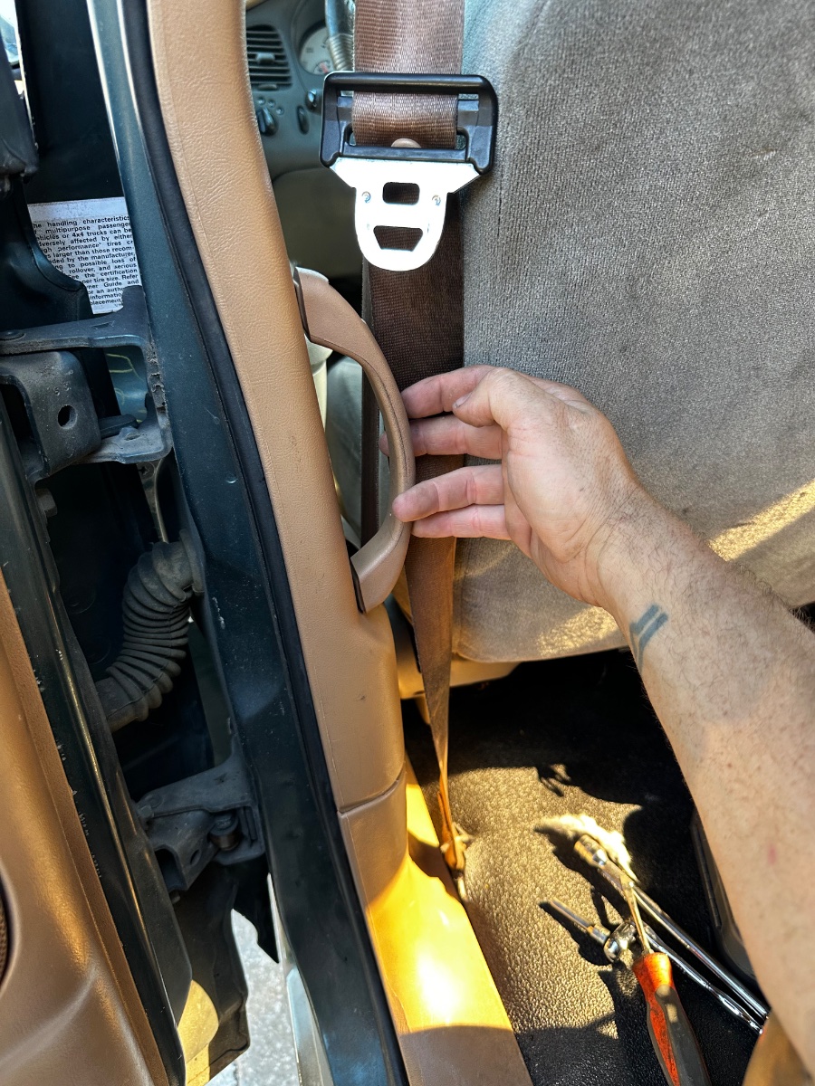

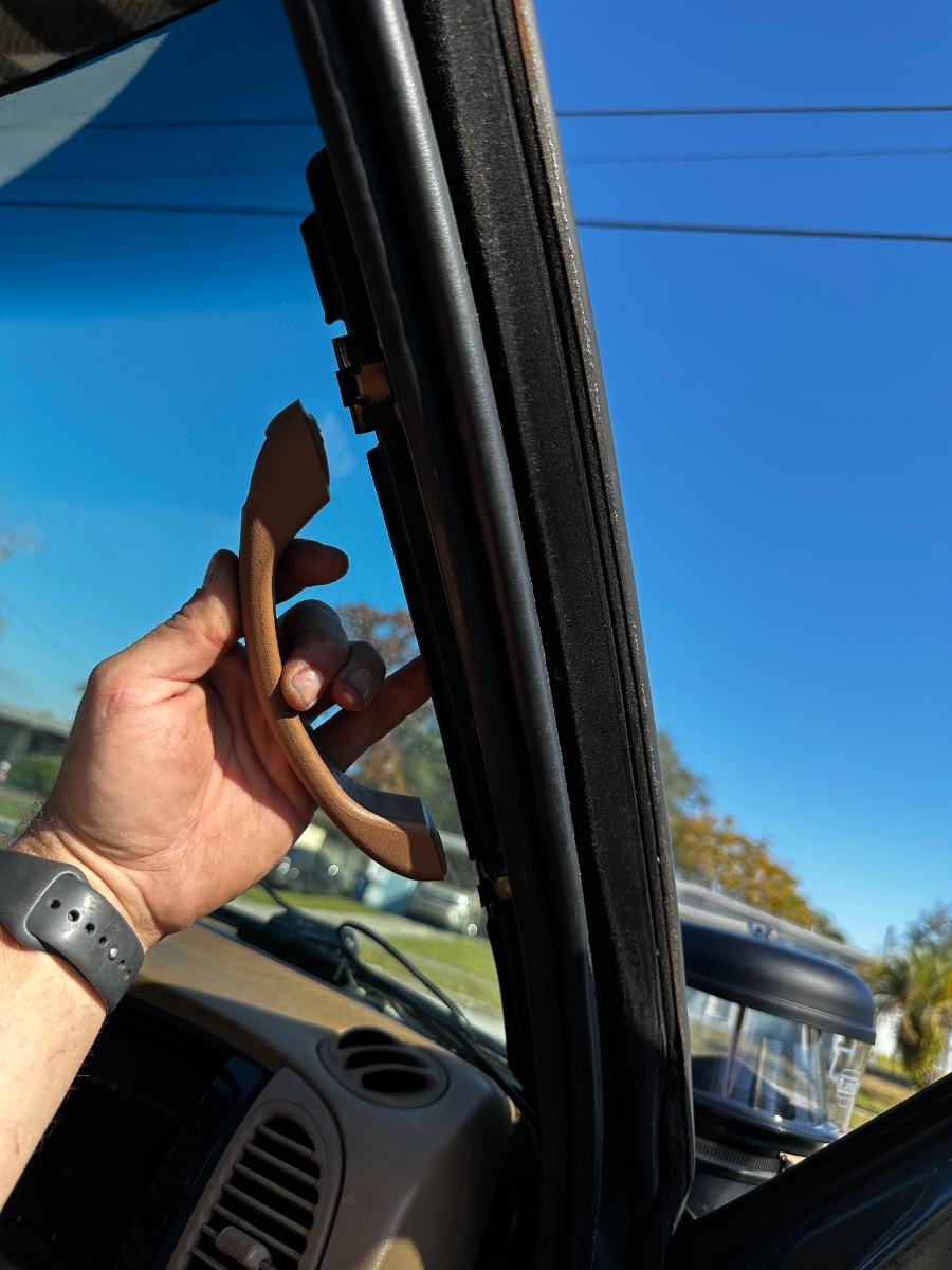

Got the driver side plastic reinstalled. Same as the headliner, stainless 4/20 and nutcerts everywhere there was a pin and where the coat hook used to be. I think I’m going to probably cut the clip plastic out and do the same thing on the a pillar piece because it now has a gauge pod and will get gauges soon adding a little weight, so I think some extra rigidity there might be a good idea.
I think I want to replace the headliner handles (whatever they are called) with some stainless ones, and add a few in the spots shown to make it easier for passengers to get in. I’ll have to find a way to secure them to steel obviously, but the one under the passenger airbag spot will be easy.

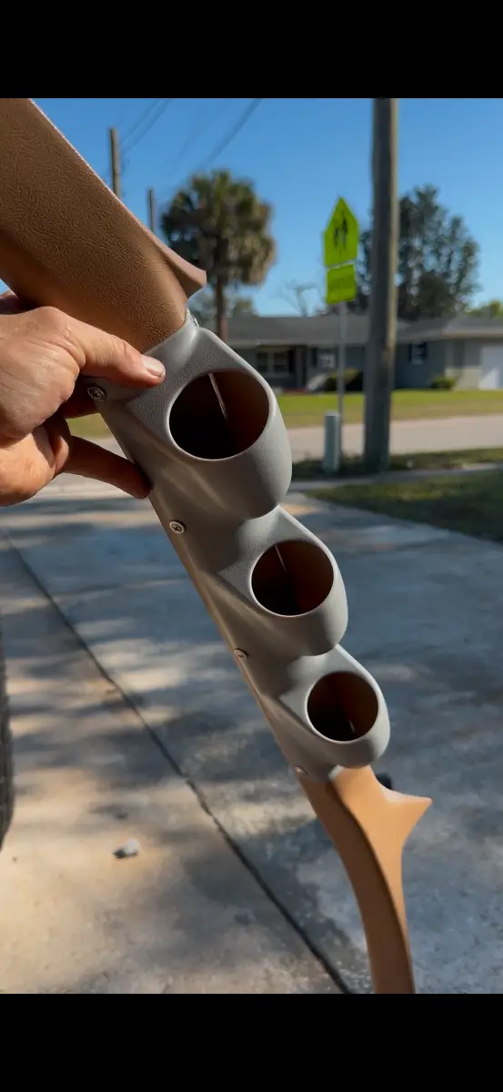

I ordered the gauges to populate this pod. It’s from Glowshift and you can mold them like Kydex. Going to go oil pressure, coolant temp, and trans temp in and out with a toggle switch.

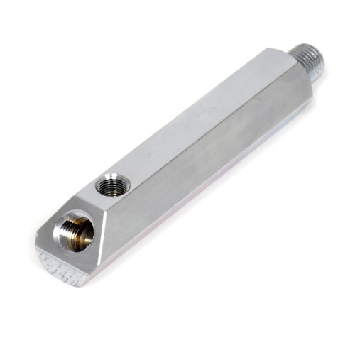

Trans temp is easy, just inline sensors in two of these T fittings. I think I know where a 1/8 npt plug is in the manifold, anyone have a good spot to tap the oil pressure? I found a port on the 5.4 off the driver side head, haven’t really seen one on the 5.0.
I’ll be going back to the original gauge cluster when I install these extra gauges. I’m hoping that the buzzer from the passenger side stops after that since it didn’t start till after I installed the 01 cluster. Maybe some kind of communication error I hope. If not I’m going to find it and poke a screwdriver though it 😂

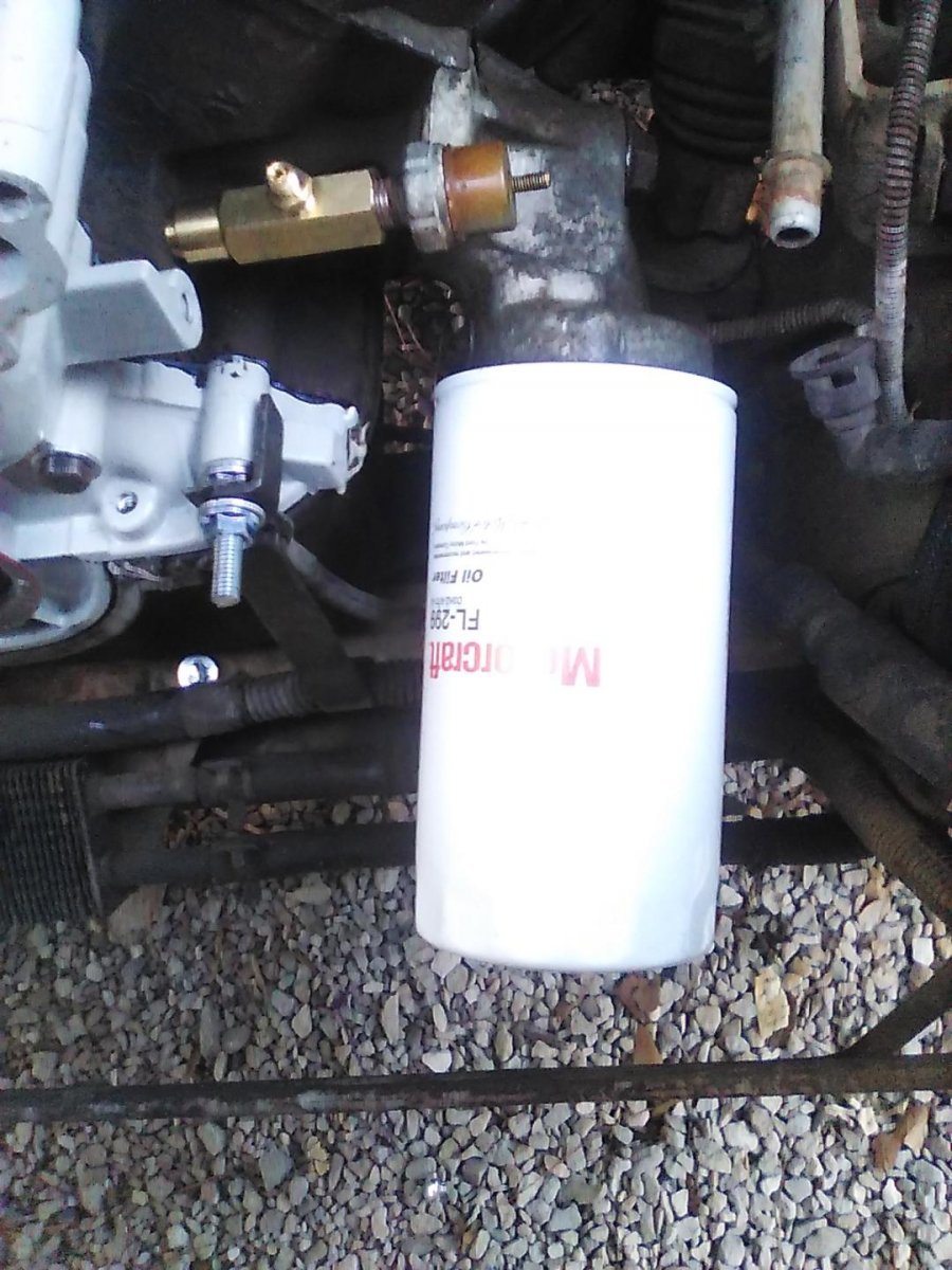

Tap extension for oil pressure gauge. Also, I deleted the heat exchanger piece from oil filter adapter and used 3/4x3/4" filter adapter.
Copper line that hooks to the tap part.
Oil pressure port doubler
